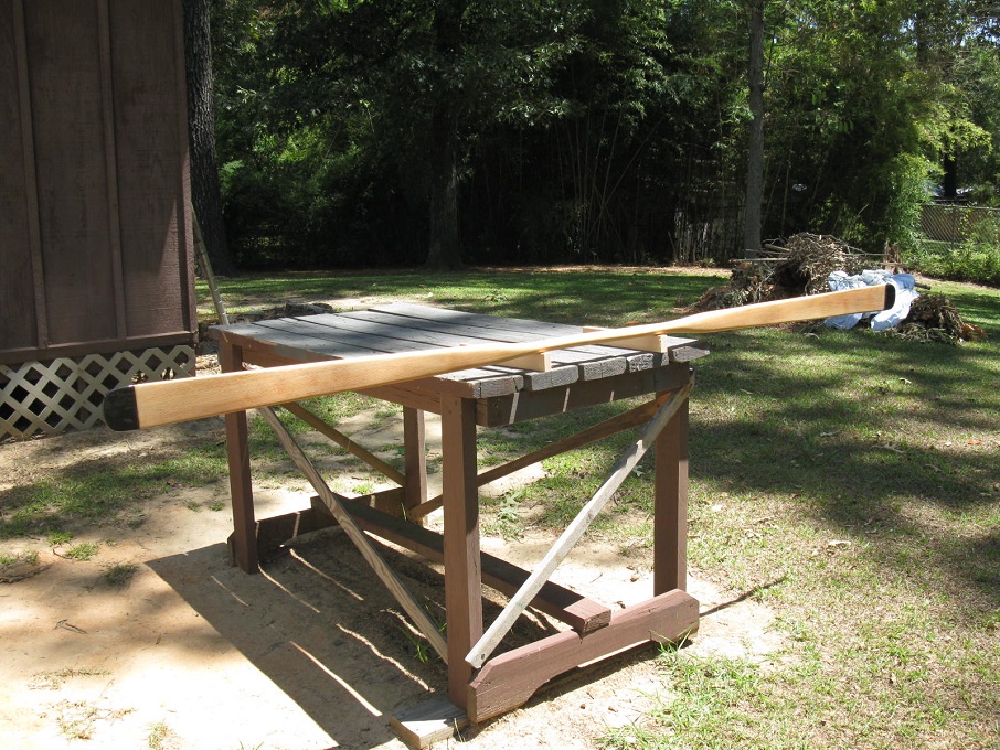

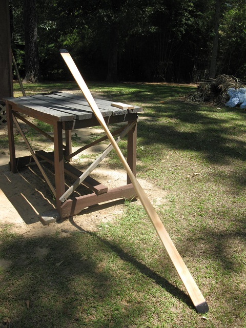

Found a clear 8' WRC 2"X4" that was mostly sap, but clear of knots. Did my best to cut and sand away anything that didn't look like a paddle. Coated the tips with epoxy/grapht for protection and finished the shaft with boild linseed oil.
Pretty sure I have the wrong kind of boats for all that fancy up righting.
After using it I now know why pirogue paddles are not shaped like this. I was looking for a paddle that was light enough, and offered less effort to make a stroke. When fishing I sometimes make corrective strokes with one hand. Also it takes only light strokes to move the boat forward for the next cast.
It worked "ok" for these task but not so much for the other paddling. Drips way too much. Chatters in the hands with vertical or forceful strokes. It worked better held at a shallow presentation. Easier to pull than my regular kayak paddle but requires a faster cadence.
I am not bashing the design, just saying why it won't work for me.
Most Greenland paddles are about 5' long. For easier indexing of blades as they enter the water, the hsndle (center portion of the paddle) is oval instead of round. Top and bottom surfaces being a bit flatter. It holds easier that way, and keeps the blades oriented better.

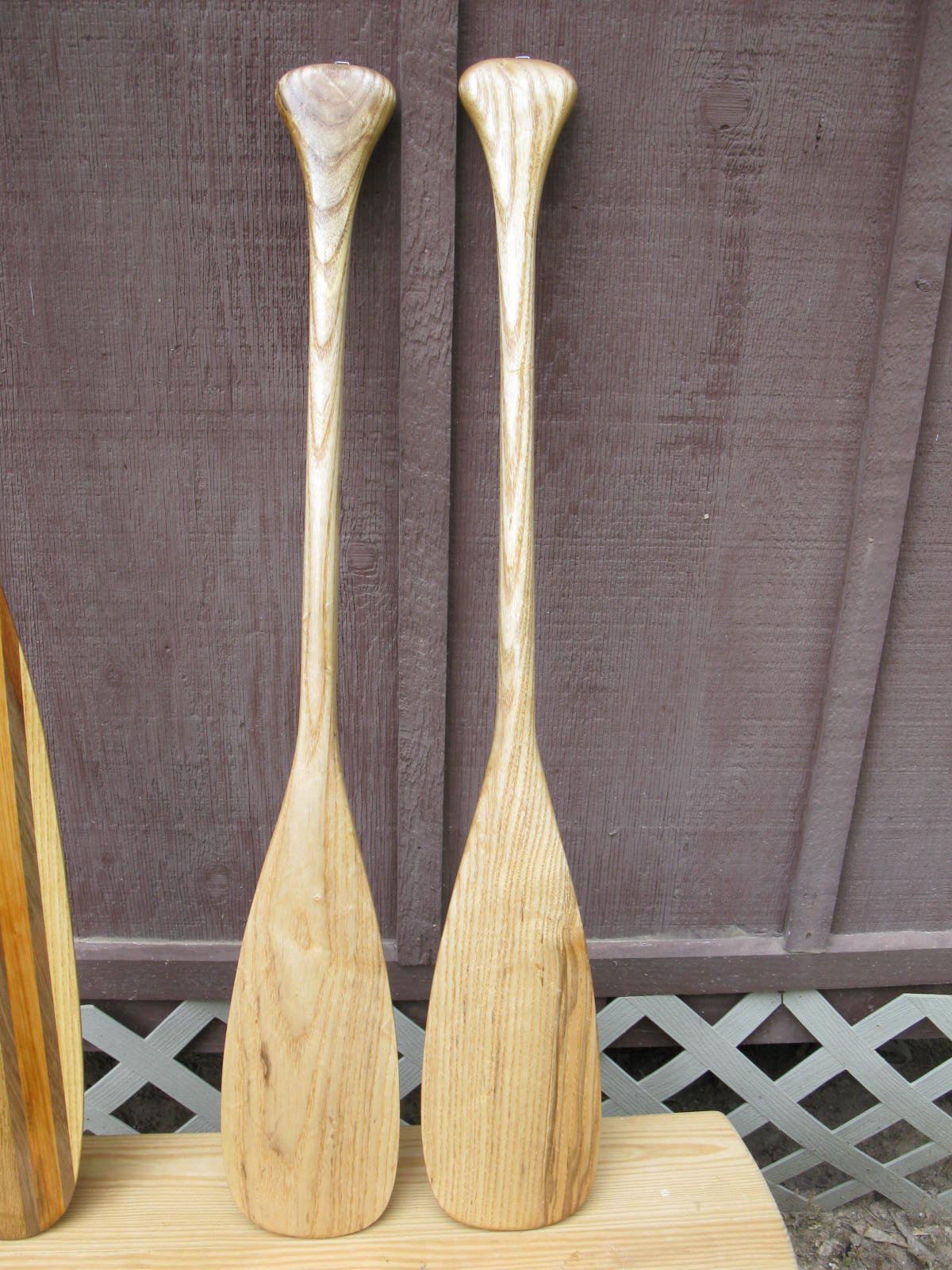

I think oldbuffpilot has posted about using two short paddles in his boats. This is/was a common practice around the Lake Bistineau area. When not paddling they could be stored one on each gunnel with in easy reach. One could be chosen for corrective strokes or both used at the same time to move forward. I have a pair I made a couple years ago.
Have not tried them, mainly because I like the double paddle for my use. Paddles are like boats. Hard to find one design that will perform all expectations well.

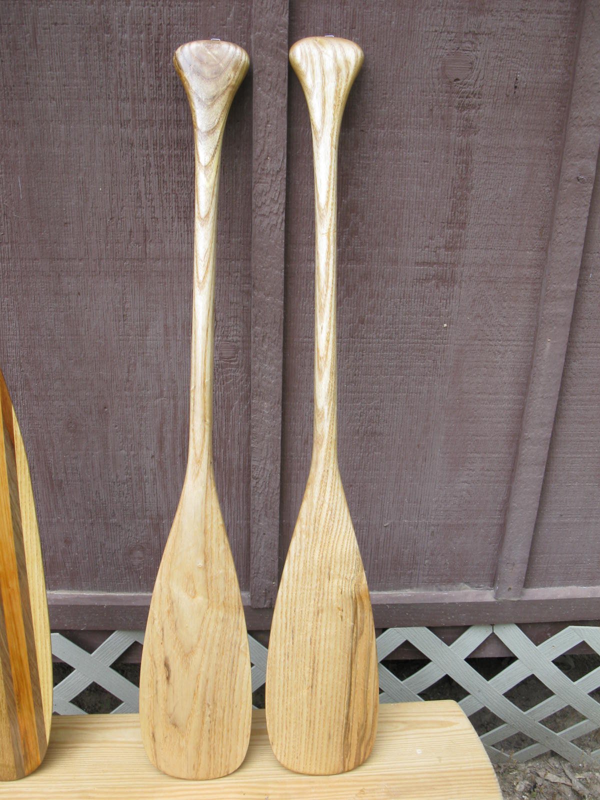

I didn't know any one used a double paddle in pirogues until about 10 years ago! But I have been converted (partially) I now carry a "kayak" paddle in case I need to go a long way without fishing. I often fish with a 10 foot pole in one hand an a 30" paddle in the other. It really is "different strokes for different folks"
