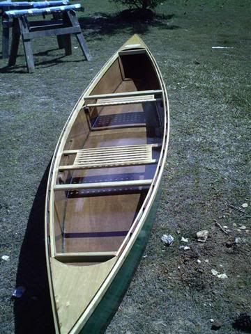

Thanks for the compliment. I worked hard building this boat, mostly overcoming mistakes made trying an uncharted building technique. Even if it does not meet all my goals, it was worth doing for all the experience and things I learned.
Your thoughts on rocker seem to be opposite tx river rat's, or am I confused again.

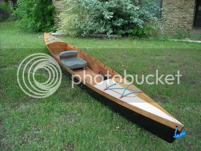

Here is a pic of a three panel that is a very high performance peerow

Thank you for your thoughts. When I finished the boat I measured the beam. It is 36", the same as my skiff. Shows what kind of a designer I am. I had figured 35". I know it will be ok because the beam width is not a problem on the skiff. A benefit of the 30 degree sides is now the top the sides are lower.
I have paddled it two times and I like it. I need more paddle time to form more factual ideas. I believe it has met the goals I had for it. It is stable enough. Less than my green skiff and as stable or better than my son's blue skiff. It does paddle easy and tracks well. Not much wind encountered. Seems to drift little in the light breezes I experienced. It does not turn as easy as the other boats that have more rocker. I was able to dodge ever cypress tree that jumped in front of me. :| :wink: :)
Another boater said I had about two inches of the bottom showing at the bow.

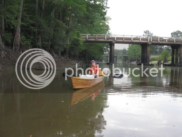

I believe this picture of my Grandson"s boat shows that:
