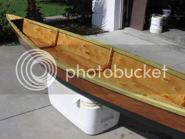

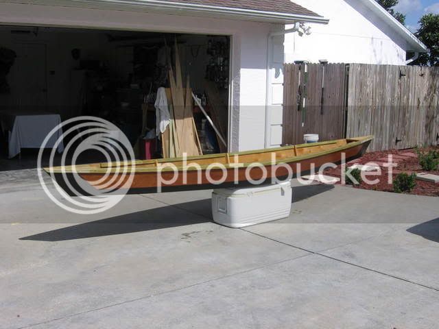

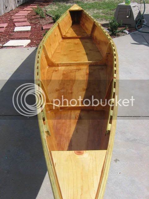

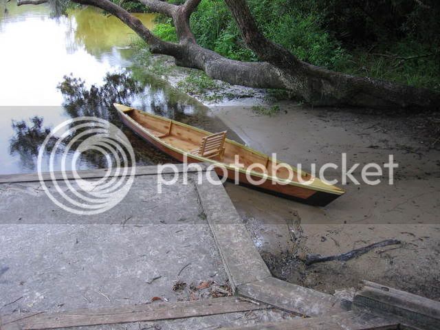

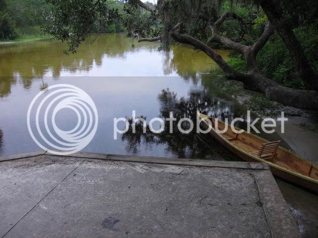

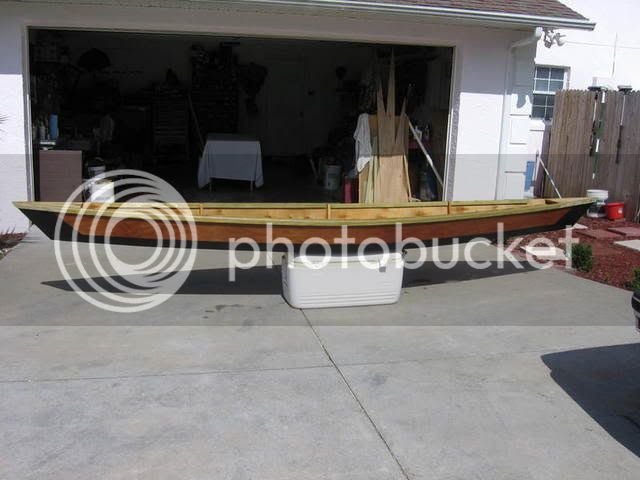

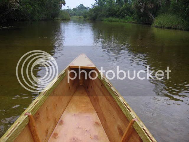

Finished my UJ Pirogue 7-24-07 and it took me about about 9 days to complete it.
Will take it out in a couple of days for a spin...
The boat weighs 50lbs and is 15'4" on top.

OldYaker---The plywood came from my local Home Depot and is just the Luan stuff with Exterior grade glue.
I guess it only took me 9 days because I worked on it day and night during that time. I tried to use the time wisely, like if I was waiting for epoxy to cure then I would be working on another part of the build.
And I did not stick to some of the recommended cure times. I mean if the epoxy was not tacky anymore and felt hard I would start the next step. It has been very HOT here in central Florida so that really speed up the cure time on the epoxy.

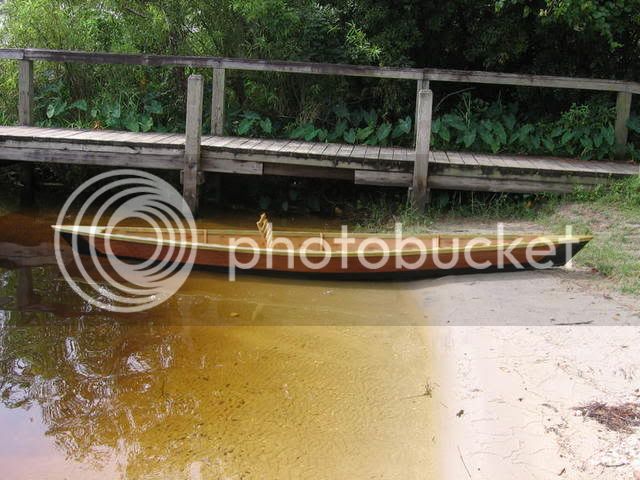

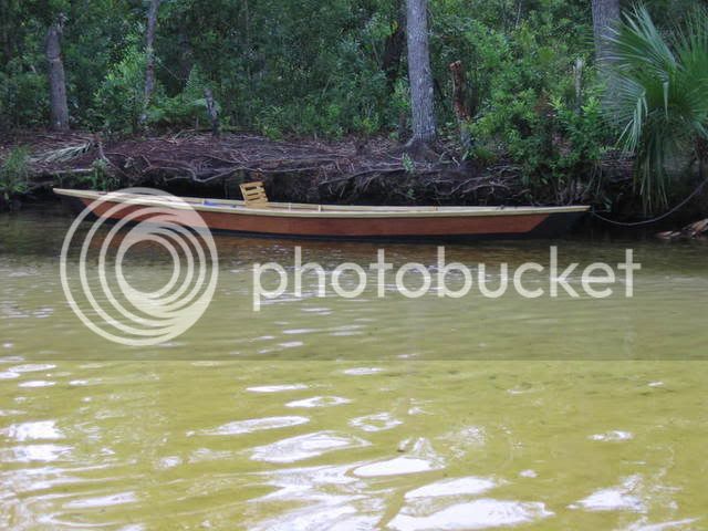

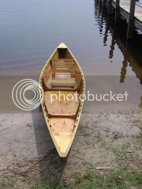

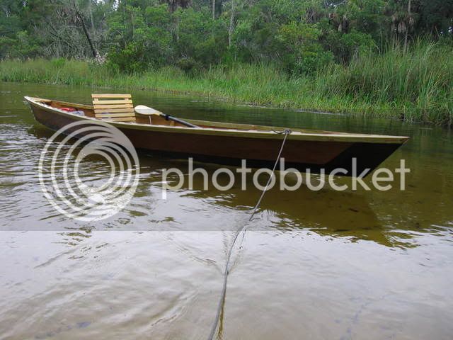

Took the "Pee Ro" out for the first time this morning and I didn't sink!:D
No seriously the boat did great and paddle just fine. I took it to Juniper Run and paddle down stream about a mile or so and then turned around. Of course go down stream was a breeze and coming back wasn't to bad except when I got into heavy current and she wanted to go a different direction.
All in all it paddle alot better than a Solo Canoe I had and really wasn't that tippy.
Here are the pictures...
And then on the way back to the house I decided to stop by at Lake Dorr (Spelling is correct) and see how it tracked in calm waters. I think if I can find a cheap kayak rudder I may add one but until then I can live with the way it paddles and tracks.
Again thanks for all the help and I will be building more in the future.

cctyer---To me the boat handles great and it is alot faster than my sit-on top kayak and to me just as stable.
Mine ways 50lbs which may be a little heavy but that little extra weight helps in stability I would imagine.
The only issue I had was paddling upstream in the swift current. It was fine in the steady current but If I ran into any real fast water the boat would head right for it.
But the boat is not design for river running and it will do me just fine for fishing backwaters and lakes.
And I don't see how you could paddle that style boat with a single blade paddle. My kayak paddle worked great and it was much like paddling a solo canoe or kayak.
