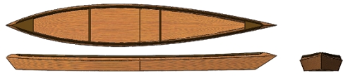

    Hey Matt! I was going to start your other Touring Pirogue after the first of the year. How much more difficult and how much time time is added to the build on this pirogue VS. your original Touring Pirogue?
  3. JEM
    JEM Well-Known Member
    Glassing will be a bit more work.
    You'll add about 4-6 more hours total, at most.
  4. VTFogg
    VTFogg Well-Known Member
    Oh man, I'm liking this boat Matt. Hey, cut it out - it's not getting any easier for me to pick out my next project!
    Can you please tell me the height of the sides?
  5. oldyaker
    oldyaker Well-Known Member
    Off'n Matt's site...Height at bow/mid/stern 13"/10"/12"
    Me too VT.....I bought the plans for the other T-Pirogue....but I'm gonna get these and probably build it.
  6. JEM
    As oldyaker said: 10" on the sides. Still a pirogue. Maybe a 14"/11"/13" or more version someday.
  7. oldyaker
    OK...I'm looking over the plans and will scrounge wood later this week. How thick of a plywood should I make the frames from???
    I'll be using 1/4" Luan for the boat itself.
  8. sheena's dad
    sheena's dad Well-Known Member
    Went looking for some ply this morning so I could get a start on mine. Nothing that looked any good. Looks like I'll be heading to Houston the first chance I get on a week day to chase me down some okoume. But, like 'Yak, make the form frames outa 1/4" or what for best results... Jimmy W and Mick, your advice?
    Steve
  9. JEM
    At least 1/4" for the temp frames. 3/8 would work as well.
  10. Jimmy W
    Jimmy W Well-Known Member
    I just used some old 1/2 inch OSB that I had laying around for the temp frames. BTW I never did wire the tumblehome panels to the frames, only the lower side panels. I did cut out the frames from the 3/16 ply that I used for the rest of the boat and then used them as patterns for the OSB.
  11. JEM
    That works too! :D
  12. hairymick
    hairymick Well-Known Member
    Dad,
    When I built Robin's P5, (very similar boat) I only had 1/8" ply for the boat and the temp frames and that is what I used.
    Heavier would be better, but you can get away with the light stuff too.
    Matt, Clearly, this one is another winner. Congratulations mate. :D 8)
