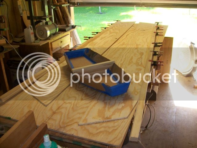

It's been a couple of years since I built a boat. I needed something to throw in the back of the truck and fish close in to the different local landings. This is what I came up with.
One 4x8 sheet of 1/4" sanded pine plywood.......plus a few scraps for the stems. The really crude model is all it took to give me a place to start.
So far, I'm into the boat for about $38.00 and about 8 hours labor. That's counting making the model and building the center form. The chines didn't bend to the arc of the sides so I had to waste time piecing them in.
I re-viewed Fla Mike's Pit Pan video. Similar sized boat and I noticed it hardly sank down when he got into his boat. I figure this one ought to have plenty enough flotation.
I read that a sheet of 1/4' pine ply weighs about 22lbs. I figure with the gunnels, ribs and deck(s), it'll come out under 30 lbs. Cool!
It won't be a great paddler, but I won't be going very far anyway.

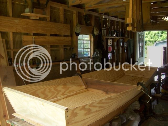

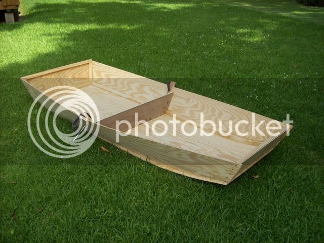

Well, the 30 lb weight I had figured on got shot all to he!!. I went by my last pirogue on which I used Western Red Cedar for the chines and gunnels. I used what I had on hand for this boat, which was white pine and poplar. The weight of 50+ feet of 1 x 2 material really adds up. Stronger but a little heavier. She'll probably end up around 40 lbs. Still a handy, manageable weight.
Chines and gunnels are all in. I filled the screws holes and did a BUNCH of scraping and sanding. She's looking so good, I'm going to go with a clear finish with the outside bottom painted green for 2 1/2" up the sides.
I learn ( or re-learn) something with every boat build.
1. clean glue drips BEFORE they dry! Big time saver.
2. a sharp scraper is MUCH better for erasing small flaws and factory ink markings than sandpaper. I truly would give up my palm sander in favor of a good scraper.
3. I ignore this, but it's probably a better idea to follow some sort of plans. I like to design on the fly, but it does take twice as long or more that way.
4. After the rough sanding with a belt sander and palm sander, I've come to favor final hand sanding with the 7x Norton 220 gr sandpaper with a light touch. I can go over the entire boat with a quarter sheet of this amazing product. Emphasis on the light touch. If you find yourself pressing hard, pull out the scraper or the 120 gr. It took a long time to get that into my thick
skull.
5. Sanded pine plywood is as good as , or a better product than fir marine ply. Sacrilege you say!! I've used it on 3 boats and still have a non-painted model boat in the weather doing very well after 3 years.
The model looks almost as good as the marine ply on my first pirogue did under 3 coats of paint that was kept inside.
6. No matter what they say, I haven't found screws that will CONSISTENTLY countersink themselves. I'd rather use screws than nails on a light boat because they're faster, hold better and don't bounce
the light boat around like pounding nails does. I just go back after the glue dries and remove, countersink and replace the offending screws.

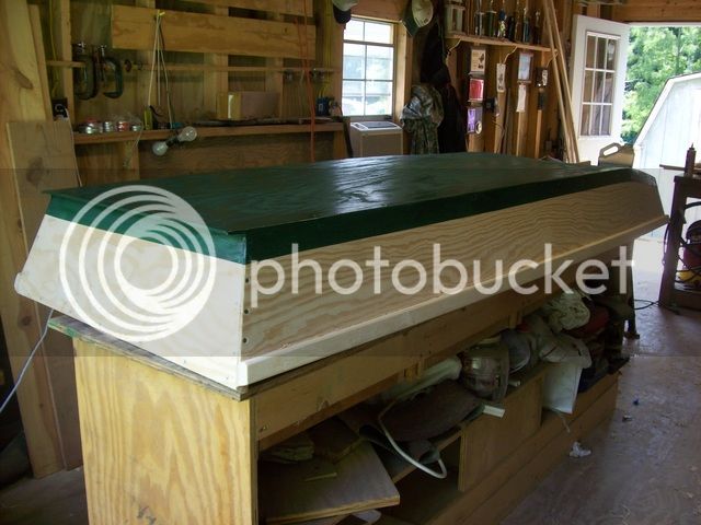

I'm going to try something different for a finish this time. To get a finish that really seals the wood, you have to put on multiple coats of quality varnish. That's good UNTIL the wood checks and splits (and it will) . Then, what you have is a mostly sealed surface that doesn't allow water to evaporate back out. I'm going to put a lighter coating of paint and probably a danish-oil type of clear coat.........kept thin to allow water free passage in ( only 5 or 6 hours at a time) and free passage out ( weeks of drying in between uses) . I have a wooden knife handle that sees almost daily use and washing, that we got for a wedding present 30 years ago. Once clean and dried, it looks pretty much like the day we got it. I'll forgo the concours quality finish to test this theory.
2,326
No turning back now. I just put on one coat of the Danish oil concoction on the outside bare wood. It's a pretty common mix........equal parts varnish, boiled linseed oil and mineral spirits. I just flooded the surface and wiped it in with a rag. No brush, brush strokes or runs to worry about. It brought out the color a bit, but it doesn't leave a film on the surface. I'll put on two or three or more coats. No sanding between coats. It's basically the same formula as a deck stain but without the stain. When it needs freshening up, a good cleaning and drying and I'll apply another coat or two. It should never crack or flake off. It doesn't leave that wonderful glass smooth surface of a fine varnish job. You still feel the wood grain. We'll see. No guarantee with experiments, eh, boys?!

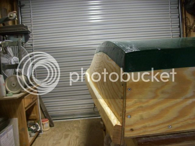

Looks good. Did you cut the extension off the bottom? The pic 2nd above shows the bottom extended past the transom. Pic in post 13 shows the "tail"
2,326
No , Tex, Ididn't cut the bottom extension off. The pic with the Danish oil finish is from the bow looking back towards the stern.
Bottom extension: Just a hunch, but I'm thinking the extension at the stern MAY help lessen the turbulence of the flat stern. Like with many of my designs...........we'll see. :D

Jack, I don't plan on it seeing any weather other than when I'm using it. I figure to use it for the day, clean and dry it out and store it in my shed. I don't expect it to stay in "like new" condition. I figure it's like a shovel or ax handle. Use it and then put it away. Sure, if you leave a shovel out in the rain and sun for six months, the handle will be in sorry shape. If you dig in the mud, hose it down and put it away dry, the shovel should serve you for 15-20 years.
There is varnish and boiled linseed oil in the mix...........the oil, along with the mineral spirits, allows the varnish to absorb deeper into the wood. So, there IS protection, but it's below the surface.
