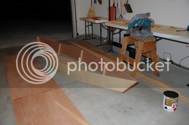

Be careful when moving the Pirogue around without the outside or inside rub rail ( either one) on it to hold the shape. The sides of the boat will try to flex on you and if it does you stand a good shot at breaking one or more of the ribs in it.
Not a good thing..........

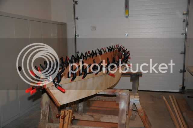

It's getting closer to time to glass.
Well, I am still confused about a few things. Since the inside is the hardest I am going to do it first. I plan on glassing the whole boat, OK ,questions....
1. If I epoxy saturate the whole boat, do i brush that on or use a spreader? What grit sandpaper do you use to prepare for the glass?
2. When you do the inside, i assume you start in the bottom and work up the sides? Where do you stop (where will the top, and bottom joint be?) Does the glass just conform to go over the ribs?
3. Do you pre cut the glass oversize, and trim it to fit when the epoxy is still a little soft?
Thanks in advance, and please try to not confuse me anymore than i all ready am! :eek:
YES.... I use a roller to saturate the boat , you might find another way better or easier. Fine sandpaper will work all you are doing is knocking down and whiskers that are sticking up , lightly run your hand over it before sanding and you will see why I call them whiskers.
Cut the glass so it fits in between the ribs , trying to glass the ribs is a lot of work , just epoxy saturate them. I do the bottom and then work up the sides. You might find a different method for you.
I let mine cure for about an hour and then with a razor knife go in and trim the glass. If you cut to hard the 2nd coat of epoxy will fill the cut for you. If it has not started to set when cutting the excess glass , the glass might move on you... when it is nice and tacky is the time I like to trim it.
