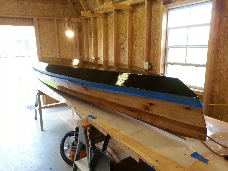

I'm happy with JEM Crawdad for such puposes. I've modified a couple by shortening the sides. It is real stable and SS&G out of cedar end up about 30 lbs. There are some pics on here and JEM site.
Yes, it is a tad smaller than I was looking at, but I have looked at your stuff over there several times. A more refined pirogue if you will. What draft are you getting?
629
34
82
My best guess is about 2 to 2.5 inches. the scum line is usually about 1/2 way up the small black "side"panel. I think the panel is about 4 inches. You are right it isn't a pirogue and the square stern produces noticable drag.
