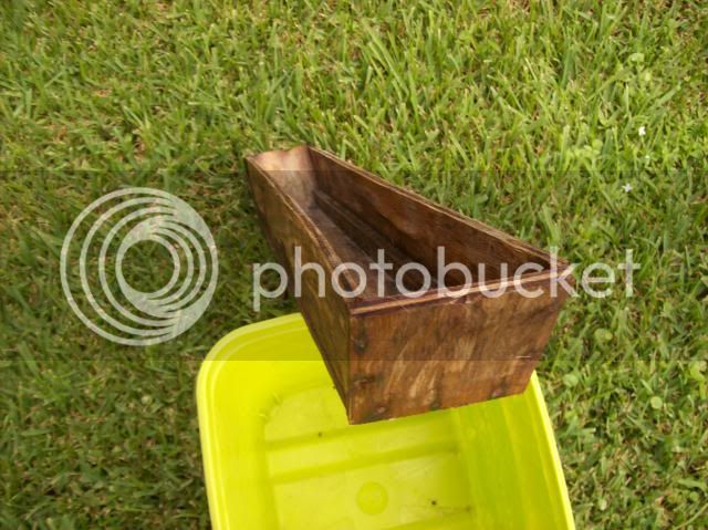

Here is the plywood test model after 10-12 soaking/drying cycles. Most were 1 day soaking-- 1 day drying, but a couple were 2 days soaking -- 2 days drying.
The white coloring is the glue which gets white on the outer layers when just coming out of the water. The white disappears in a few hours. The black coloration is the steel nails I used bleeding into the surrounding wood. All joints are still tight and the ply looks to be in perfect shape. All edges were coated with glue except the top edges.
Now, imagine a boat made with this material and glue with 2-3 coats of quality paint applied. Have no proof on how it would compare to "real" marine ply, but my guess it would be favorably.

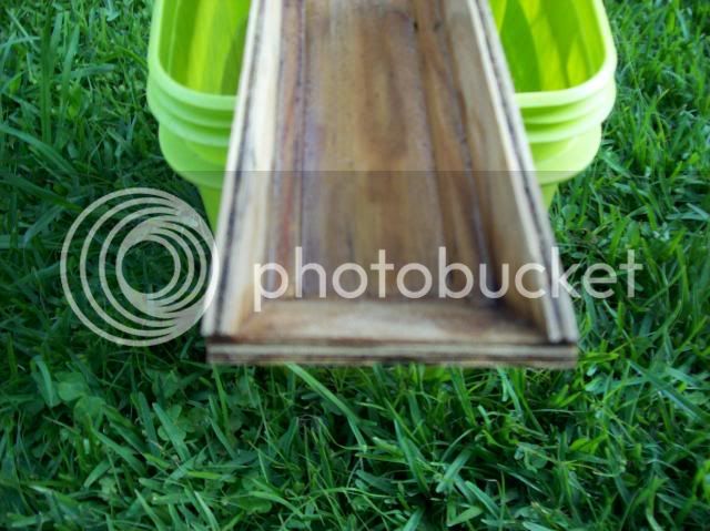

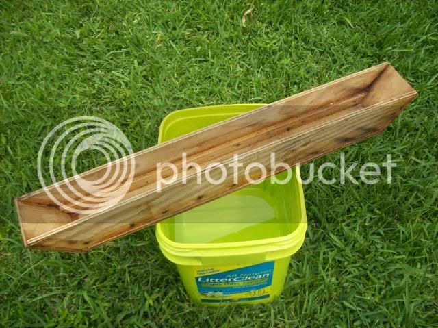

Status of sanded pine ply model: over a month with the whole model exposed to the elements. Approx 15 wet/dry cycles. Same end on all cycles.... shown on right side of picture. Ten cycles, overnite soaking half it's length in water... one day drying. 5 cycles, two days soaking .. two days drying.
Some discoloration of ply. More discoloration around steel nails. All glue joints still solid. No delamination or swelling. No signs of extreme water intrusion. No checking but the grain is more pronounced on the tested side. Slight warp of one side....maybe 3/16" over the length of the side.
Not a truly scientific test, but much more rigorous than the ply would encounter in a well finished, painted boat. Ply might check down the road.........but so will fir marine ply .. at 2 1/2 times the price. Do I recommend it? Nope. Just one test of one piece of ply. Just another option to consider. From what I've experienced, I'm satisfied with my choice.

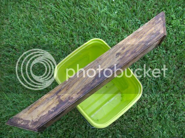

The model has been exposed to 6 months of South La. weather. 95 degree days, rain for a week at a time , wet grass clippings and the last month laying on one side in a pile of wet leaves. I just hosed it off and let it dry a bit.
No delamination other than the 6" long split ( the only one) . No rot whatsoever. The dark stains are mostly the Titebond glue. Remember..... no finish of any kind on the flat panels and none on the "gunnel" edges. Some warping of the long sides. I didn't test the glue joints, but they still seem to be tight.
I'd say, for someone on a budget or just experimenting with designs, this $24.00 a sheet sanded pine ply is hard to beat.
