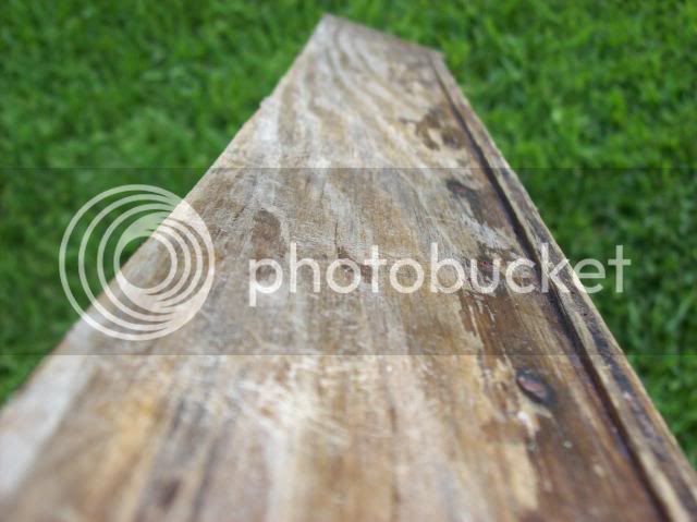

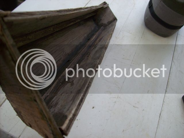

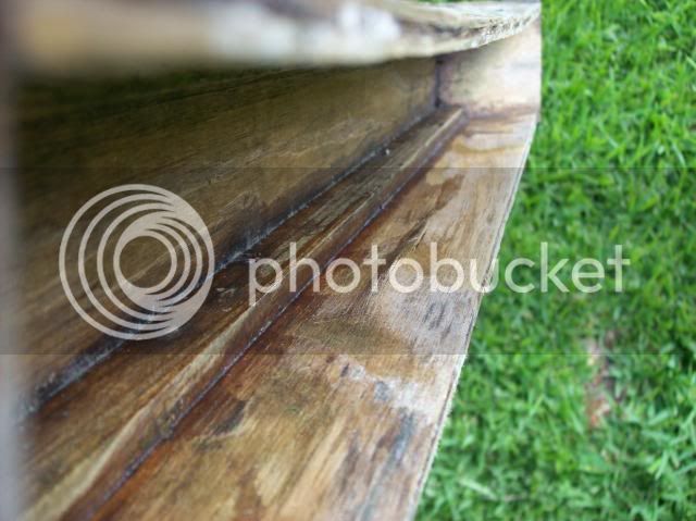

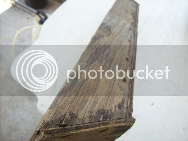

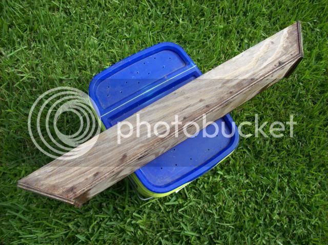

After a couple of years, the boat did develop some problems. Part of them was due to the fact that I didn't do a good enough job sealing the ply edges on the top of the sides, next to the rub rails. Got some rot there now, but I think it could probably be fixed. And up near the bow, on the bottom inside the boat, it looks like the top veneer had developed some sever ripples in the wood. The wood still seems to be strong. When I thump it, is still sounds solid, not like what I hear when I thump the part that I know has some dry rot in it. I've thought about cutting right through it with a circular saw, just to see what's going on in there. Still might do just that.
