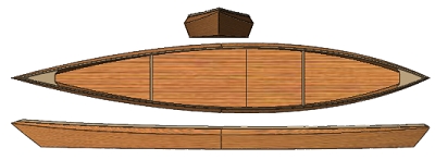

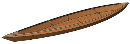

I went a different tack and added a tumblehome panel to the Touring Pirogue and will probably not release the P5 as a separate set of plans.
Difference between the Touring Pirogue T (with tumblehome) and P5 is that the Touring Pirogue-T is asymetrical (swede). P5 was symetrical. That means you'll have to draw 3 addional panels instead of just copying the symetrical panels. Asymetrical boat will be faster.
The beam of the Touring Pirogue-T will be 31" but it will be just as easy to paddle as a 27" pirogue because the tumblehome. 28" waterline beam at 3" draft. She should be very stable and pretty fast to paddle. The beam was a result of a builder who is building the prototype now requesting it that way. Sheer line will be 10.5" with the tumblehome. You'll need 3 sheets of plywood.
Touring Pirogue-T plans are ready except for the assembly instructions. I wasn't going to jump on those until after the Freedom 11-30.

Matts assymetriccal tourer, is a great boat - even without the tumblehome.
The tumblehome panel will stiffen and strengthen the sides a lot. I bloody love my tourer but I think this new version will be much better.
The more I look at those concept drawings of the new tourer, the more inclined I am to relent to some serious presure to sell the one I have now and build that one.
