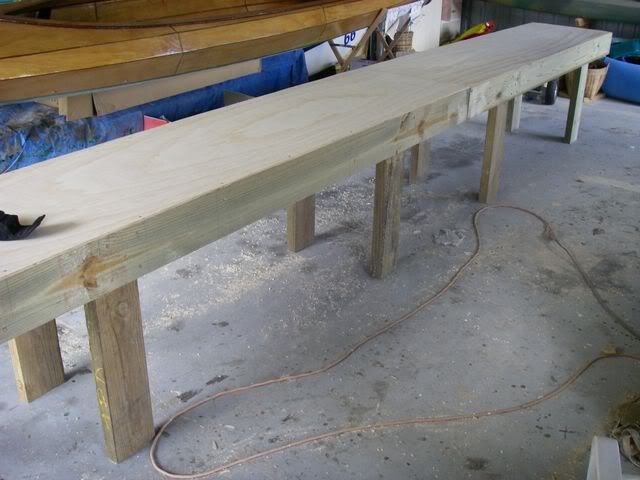

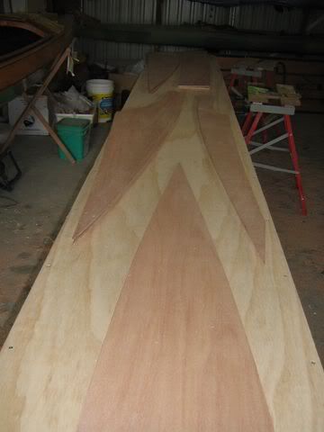

I made a start today, but first, I am very tired of working on sub-standard tables/benches etc. and struggling to get my panels properly aligned.
There are a couple of significantly more complex builds than the Laker and Okwata coming up so I went to the trouble of building a proper boat building bench today. It is straight, square, and above all, LEVEL :D
16' long X 2' wide and will double as a very good strong-back should the need arise.

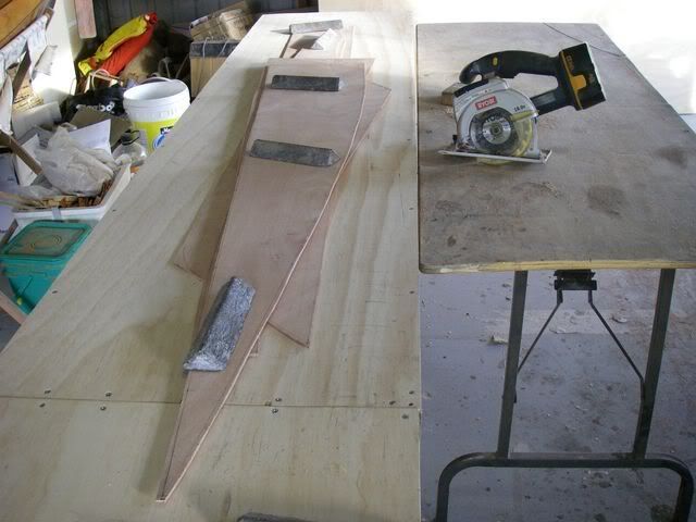

All primary panels are marked and rough cut. When they are trimmed to the lines, I will be using them as templates to mark, cut and trim all the other panels. ( I just love building symettrical hulls) :p

G'day guys,
I got a bit done today. It was nice and cool, only about 85f and could keep at it pretty much, all day. :D
Ozzie, I hope this helps to answer you question mate.

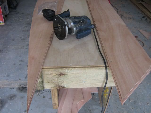

Once, the primary, or template panels are marked and rough cut, II trim them down with a belt sander or electric hand planer to about half the thickness of the pencil lines.

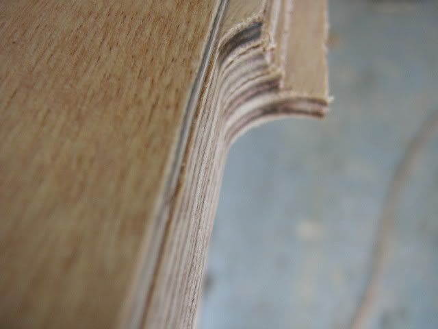

I then use each master panel as a template to mark out any panels that need to be identical to it. I can get better use of each sheet of plywood this way. (less waste) Once all panels required are marked, I cut them to within about 1/4" inch or so of the pencil lines ( not important, near enough is good enough at this stage.)
Once all panels are cut, I stack them carefully with the master panel on top and screw them down onto my bench. (I love my new bench)

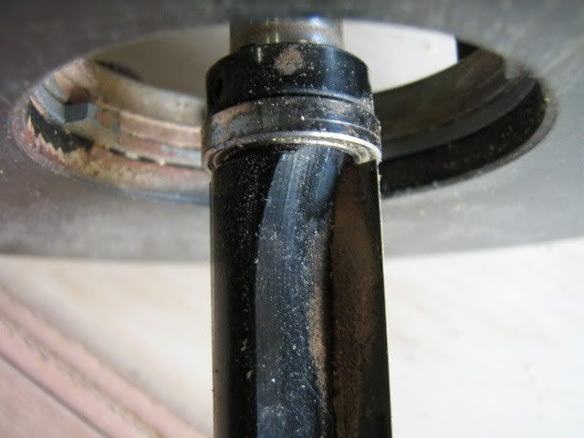

Using a good router with a solid flush trim bit,
I trim all the matching panels at once to be identical to the master panel.
I got all hull and deck and coaming panels cut and trimmed today :D :D

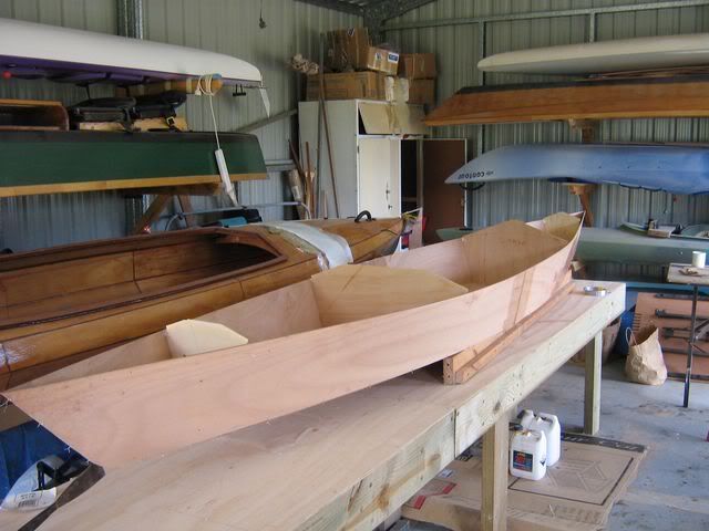

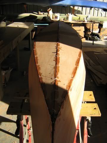

Bit more done yesterday. :D
Hull panels are stitched up.
And tacked :D
I am not using the spacers on this build. (just an experiment.) and so far, I really like the much quicker way the panels come together. another benefiet for me is that it is easier to check the hull for fairness without all the little spacers sticking up.
I also like the fact of using much less resin and wood flour which should be a saving on the weight of the boat.
This is my first foray into the world of quality marine (gabboon) ply and I LOVE it. :D Beautiful stuff to work with, easy, consistent bend properties, no voids and at a millimetre thicker than the rubbish I have been working with prior to this, makes things better and easier all round.
Next to the plans, the ply is the cheapest part of the build and I will never use the cheap rubbish again. it is well worth the extra mony! :D
