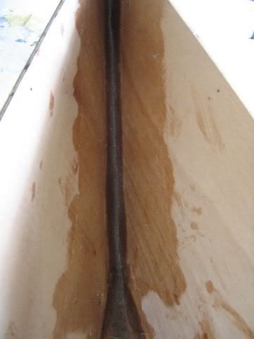

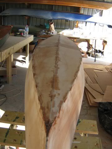

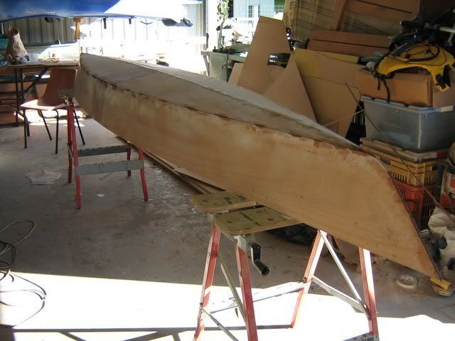

Because it is Robin's boat, I am trying to make it as light as I can but still retain hull strength and integrity. I took an inordinate amount of care in marking out and trimming the panels and when stitched, they were allmost a perfiect fit. With this very good fit, the only part of the ply panels to come into contact with each other were the extreme inside corners or the root of the joint, leaving a very small "V" to be filled.
I was able to achieve 100% epoxy penetration by using plain epoxy applied with a brush prior to filling with wood flour. It is more work and more care is required to do it this way but I like the end result a lot and i am using less woodflour - hence less weight.
I have been closely studying other builds for some time now and am slowly getting the confidence to try to incoorporate what I like about their methods into my builds. Hopefully, the end result will be a better build process and a better boat.
One big name boat designer that I know of recommends the tape method but I like neither their boats (most of them anyway) nor their build processes.

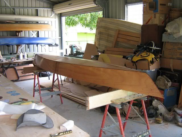

A couple more piccies.

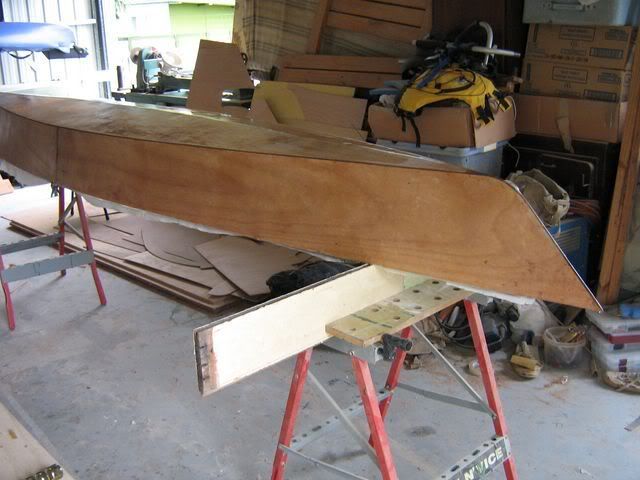

Hull tacked
Stitches out :D

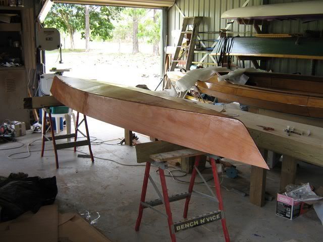

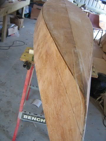

Had another pretty good day today. :D

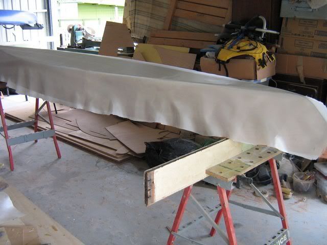

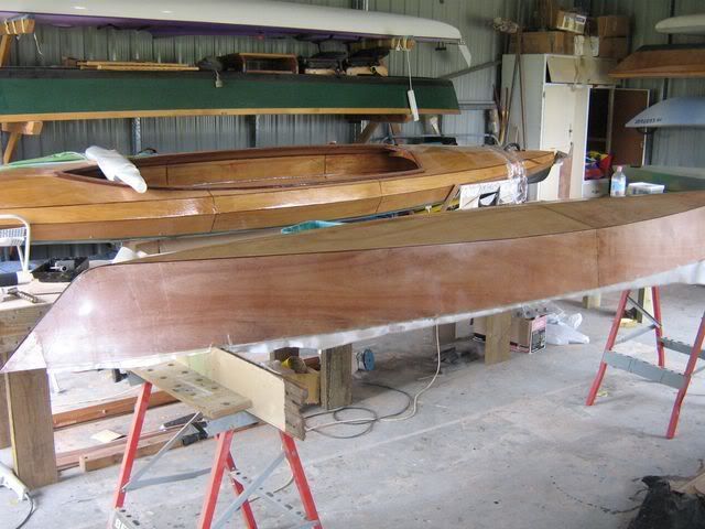

Hull outside is all cleaned up and saturation coats are on. :D

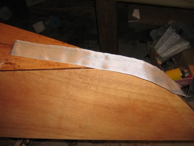

Glass lay- up - I waited till the saturation coat was allmost touch dry, or only just tacky to the touch, before laying out the cloth. I am using a tight weave cloth from Duckworks and this helps a lot to get it to conform to the hull shape. :D
First or Glass wet out coat is on :D
Since these piccies were taken, two more, filler coats of resin have been applied and i am delighted with the way the cloth has wet out. It has completely dissappeared and there are minimal imperfections in the finish. it will be a very easy matter to clean them up later for the finish coat of resin. I really like this cloth and will be using it a lot more.
Thanks Chad. :D

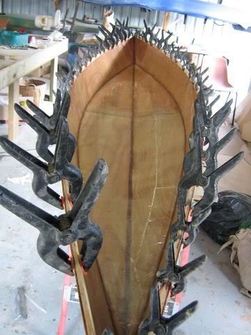

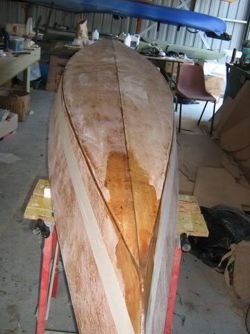

Inside is filleted and glassed.
I had to cut my tight weave cloth into strips to get it to conform to the hull shape. Even so, I have a fair bit of cleanup to do before I put the top resin coat on.
Stem fillets,

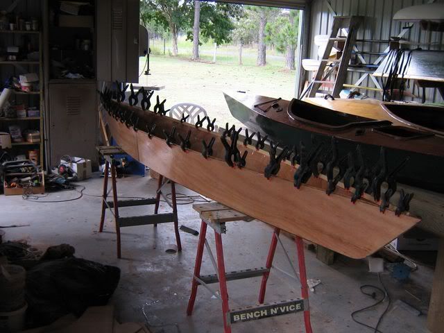

The bloke next door gave me some nice hoop pine boards today. I ripped them down to 3/4" X 1/4" strips, scarfed them where needed abd glued in the sheer clamps. easy - :D

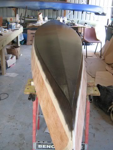

Mick your work is impressive! How did you apply the graphite? I am going to do mine soon and looking for ideas. You application looks "clean" ........no mess. Thanks, Brian
Brian, I'm not sure how Mick did his, and others will provide other methodologies. Here's mine.
Select a "water line" below which you will apply graphite enriched epoxy. Tape it off. Roll the boat inverted. Mix a small batch of epoxy, say, 1.5 oz. Mix in about 20% by volume of graphite, to about the 0.3 oz mark in this case. THOROUGHLY mix it in.
I use disposable, foam brushes to apply the mix. Smooth it out nicely and evenly. As soon as the stuff is sticky and no longer runny, remove the tape. Your next tape for coat# 2 should go on about 1/8" out beyond the first. Same for taping for coat# 3.
Be sure to remove the tape before the glue sets up hard. Once it has set up for a week or so, take the boat outside. This bears repeating, TAKE THE BOAT OUTSIDE. Lightly sand off the gloss to alight gray finish. Wipe it down with dampened paper towel.
G'day Brian,
Thanks mate.
Are you building a Laker?
Here is a step by step, of what I do. It works pretty well for me. I copied a lot of Chuck's ideas.
First up, Robin is a little person so her boat won't be carrying much weight. Perhaps 150 pounds all up - so the waterline was never going to be very high.

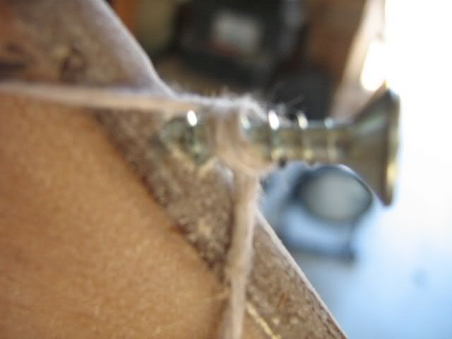

I measured down from the TOP of each stem, 9 1/2" and drilled a 1/8" hole.
Into that, I screwed a wall board screw
And ran a string line between them.
Then I marked the side about every 6" or so with a pencil against the string line.
When done, I masked about 3/8" closer to the bottom of the boat.
I applied the graphite with a disposable foam roller and when it got tacky, I removed the masking tape and re taped it up the side about 1/8" and applied the second coat and so on till I reached my pencil marks.
Hope this helps a bit mate. :D
