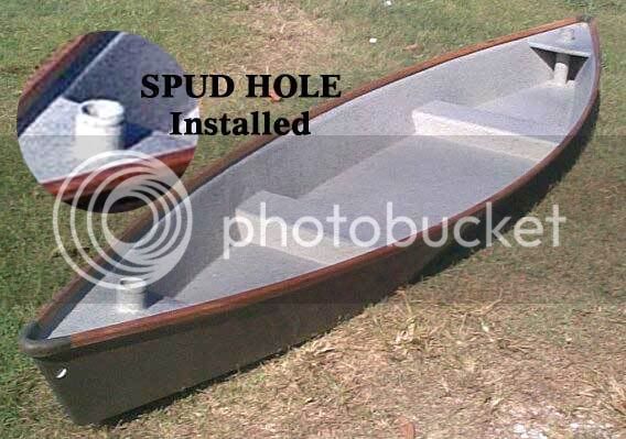

make a paddle that's all shaft and no blade
we install a piece of 1 1/2" PVC pipe thru the breasthook and the bottom and slide the bladeless paddle thru it into the muck

It's just a way to I guess anchor your pirogue.
This is showing the hole in which the spud is placed to be pushed into the muck
