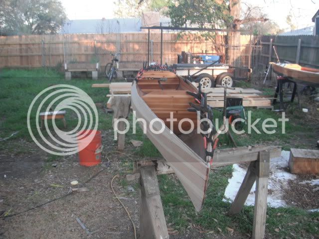

Bulkheads built glassed and fileted in

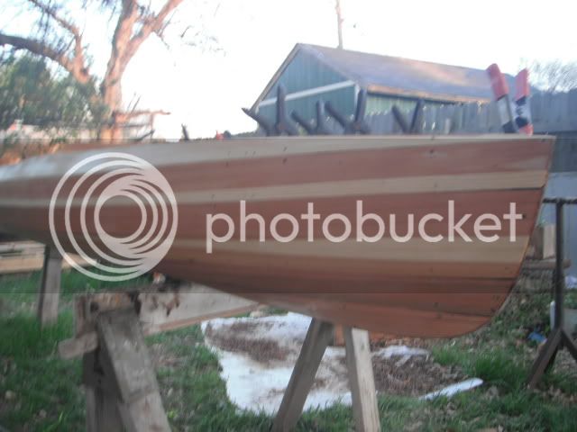

started gluing the shear strips. That sure does start shaping the boat up.

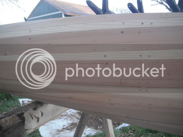

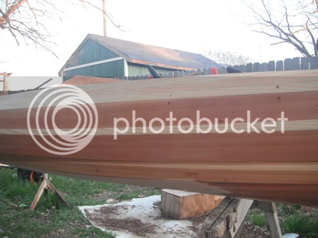

Here is a close up of the seams , they still need a little sanding
same area wet down with water
and backed up to show some of the color of this boat.
After a saturation coat I will go back and match the color of the different areas filling in the stitch holes.

Like those seams, the hull shape is a beauty, gonna be really interesting, the comparison with this and Darrells boat.
MM
Color matching is a pain in the posterior
tx river rat said:
Thats easy , .................... the holes can be color matched and blended pretty easily.
It is a strip and glue so you are going to have holes.
Do you do anything special to get the color to blend? When I mix the sawdust with epoxy the filled in hole doesn't blend with the wood. It seems to turn out darker, and contrasts with the orginal wood. Not so bad on dark wood, but very visable on lighter wood.
Thanks
Bee
I use a combination of epoxy , different saw dust wheat flour and glass spheres plus I have my secrete weapon that really helps.

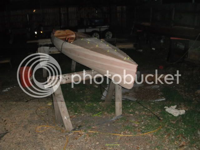

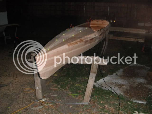

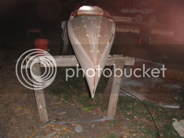

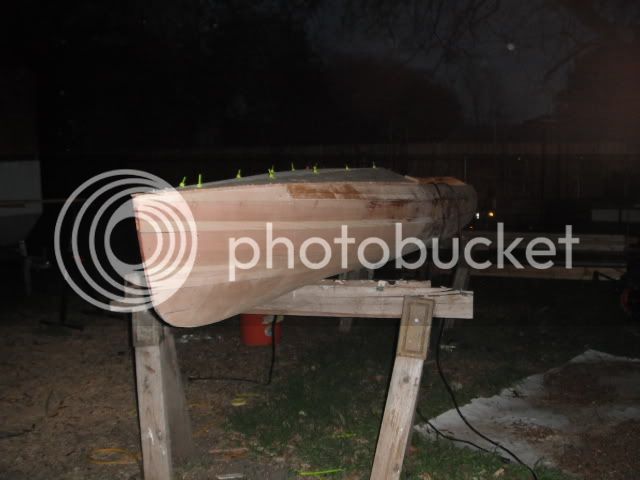

I had a pretty good day on the Northwind today.

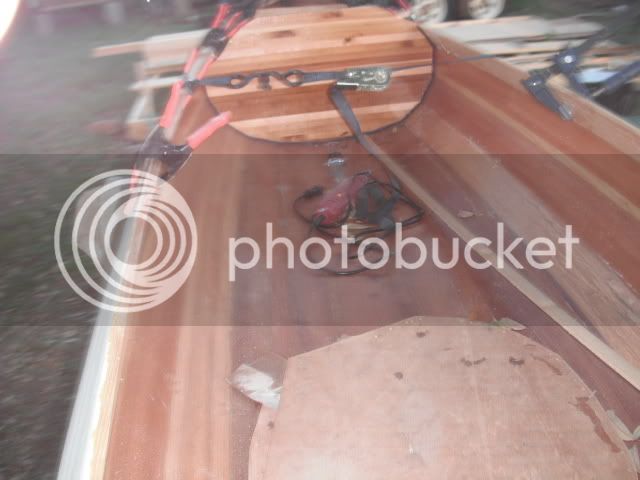

Got my decks layed out ,glued up and planed . Have them tacked down and rough cut.
These are the dropped nose balanced de3cks I like.
she is really starting to shape up
she came out with about the look I wanted
Thats all for now.
