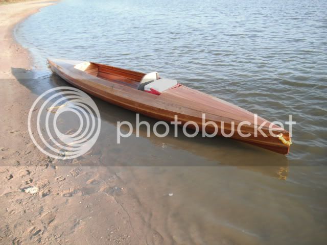

I loaded her up and headed to the local lake
Dont look half bad :D
Unloaded and shoved her in the water ,dang she floats shallow , with a small cooler seat and camera bags both ends are out of the water

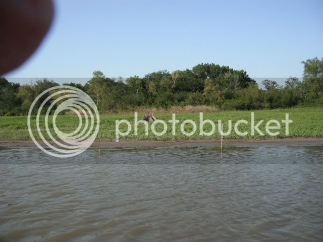

We need some rain bad here are a few pics of the shore line

The initial stability is great , leaned her on over and it was like hitting a wall,
OH I LIKE IT
Started out across the lake and started turning back and fourth , she doesnt need a rudder , that was one of my concerns.
This is not a sprint boat , got it up to just a little over 5 miles an hour. killing yourself might do 6 for a short time. But oh the cruise speed, my T-V cruises at 3.75 mph this boat can be paddled all day at 4.2 to 4.5 I love it.
This was on a lake with a chop , balanced decks worked great the wind just didnt bother me at all . in fact I turned side ways to the wind and let her drift she
she stayed that way no weather cocking.
I have built some fast boats that can out sprint this one ,but at the end of the day I think they would be playing catch up.
My thoughts on the North Wind , it exceed my expectations .

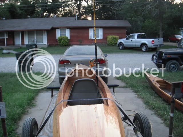

Did a little rigging on the NW today ,
Jacked the seat up to 8 inches
I will try that height out tomorrow .

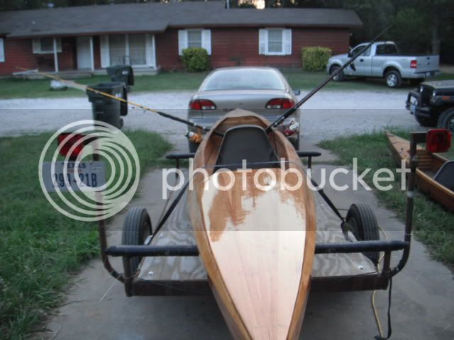

Drilled holes for my rod holders and trolling holders
Trolling or drifting they will be in this position.
Transporting like this
I like the rods in front of me so I can see if they snag on anything.
The 8 inch seat height worked great , rod holder also worked well and the 52 quart ice chest fit in front of me just right for access .

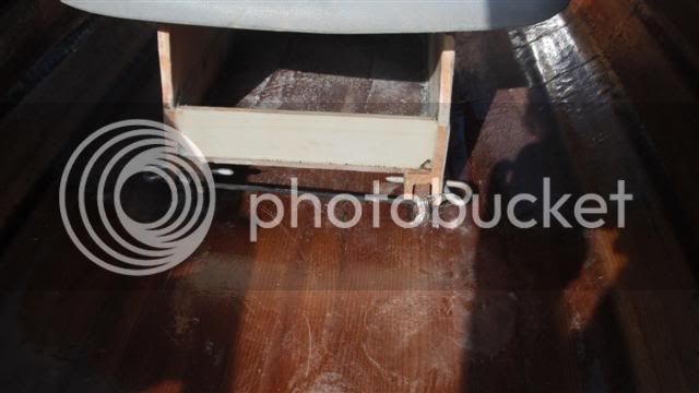

I tried a seat but it was to low ,so I built another base , front of the seat is at 11 inches ,that gives me a pretty good size box under the front for sponges and etc.
Also built a place in back of seat for drinks and etc

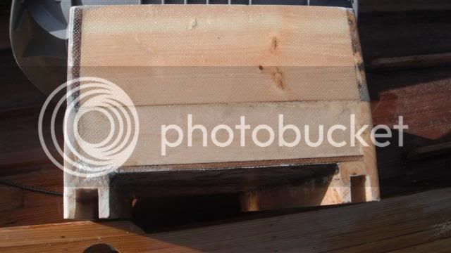

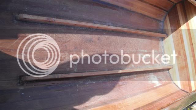

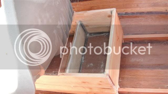

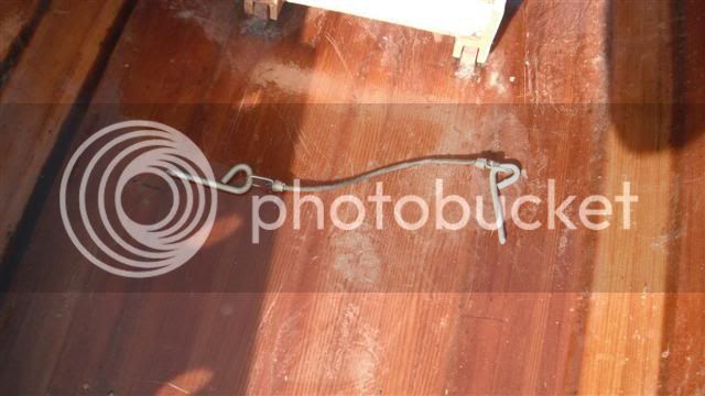

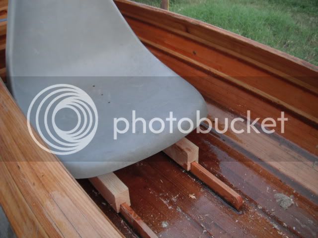

I have been ask a couple times just how I mount my seats so I am going to go through the processed
I cut two strips , these are 5/8 eide by 2 inches tall ,space them
and drill holes on 6 inch centers, then glass to the floor and bulkheads
I normally use a 2+4 standing on edge ,cut my groove with a table saw and cut the nothes for adding the seat support. You can see the shape in this pic
This seat is pretty tall but you just have to find the height you need and adapt it for your boat
I use two pins and a bunji to hold them in place
I like this set up ,it braces the floor I am able to remove the seat or secure it with a lot of adjustment for different loads.
Got to go paddle it tomorrow so I can see if I am to high.
The 11 inch high seat worked great ,still plenty stable and super comfortable.

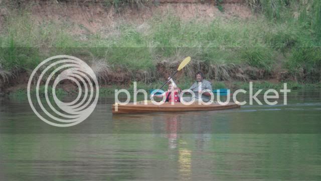

The only problem I had was when my grand daughter and I were paddling tandem ,we both were paddling in time and when we both got a good bite with the paddle on the same side it made the boat a little squirely
If paddled tandem I would drop the seat 2 inches, oh with 2 paddlers she will flyyyyyyyyyyyyy

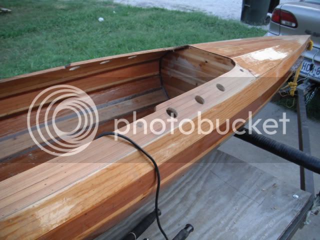

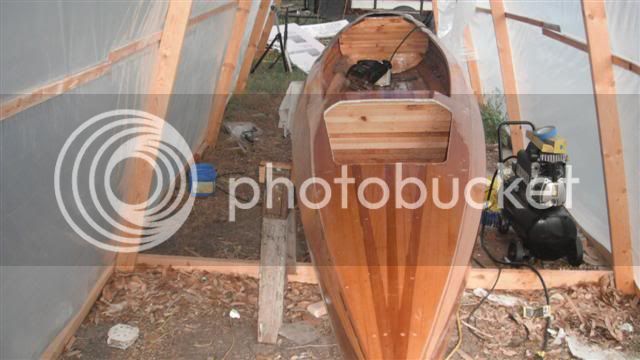

Well its time for the pucker pic I forgot to post

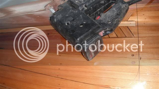

Always hate cutting the hatches
and two big holes in my boat
rigged the tie downs and she was ready for a little trip.

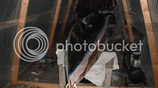

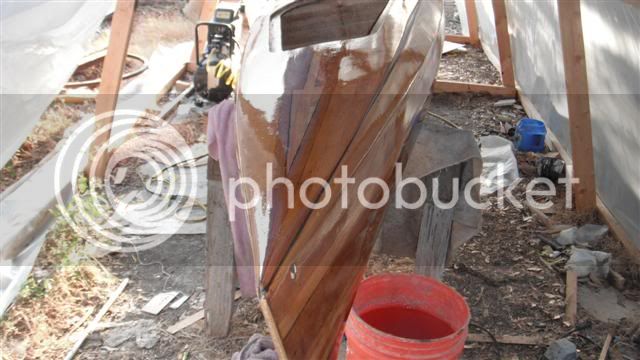

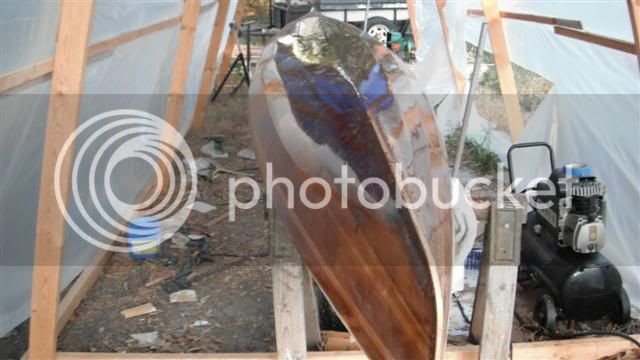

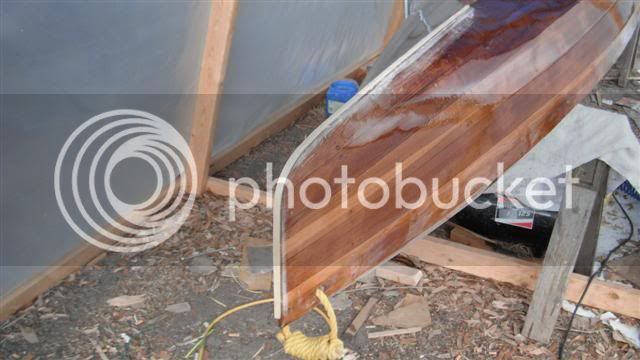

Glued my stems on today
I do mine a little different than most folks do , I finish out the bow and stern justlike I am not going to apply stems then come back instal my stems and put cloth over them. that way the boat is still sealed even if I wear through a stem.

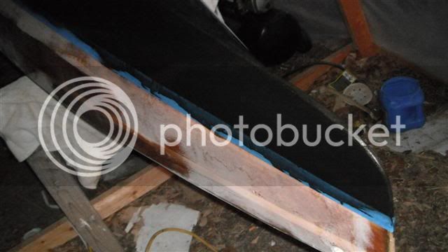

Patched a few scratches from not letting the epoxy age before using it.
got the stems covered in glass and the first two coats of epoxy and graphite put on
one more coat and then a final sanding to the rest of the hull and start work on finishing it while the bottom coat gets hard.
