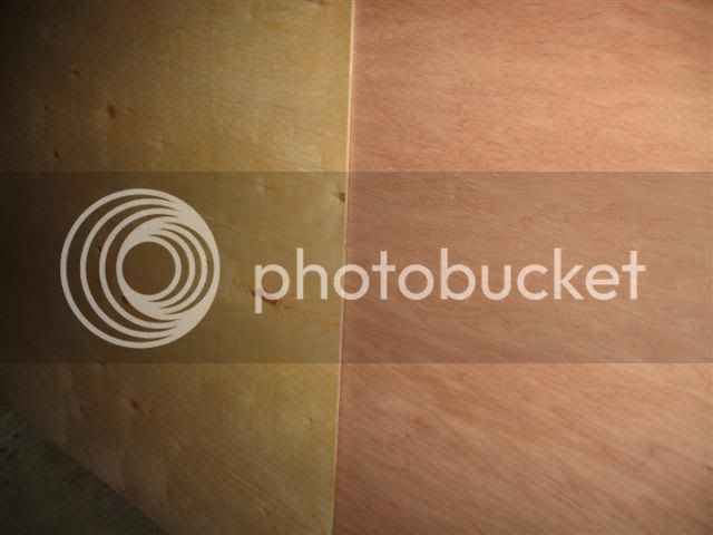

Here's a pic of both sides of the plywood I'm using--Luann from HD, I think, but I went back and forth so many times to Lowe's and HD before borrowing the truck...anyway

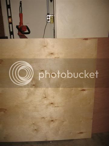

and another showing more detail of the "ugly" side--
The more I look at it, I kinda think maybe them knots adds character...

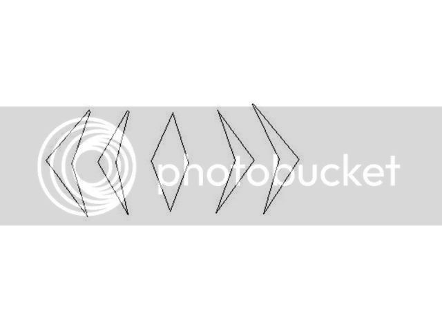

Also, I was thinking about a simple geometric design added to the top panel near the bow (and maybe stern). I was wondering if I could chisel out some simple arrows and diamonds and just flip the wood pieces around to create an inlay in the panel--as Chuck says, it's my boat, I should do it my way...
I was thinking something like this...
Once epoxied back in, the contrast in veneers should look nice. Thoughts???

Good point (as in why didn't I think of that). Using the cheap ply, I went ahead and made templates for the top two panels--(templates are just for one build--I know the rules...). Could cut out the design in the template and see if it works. And then use it to mark the panels.

Jack, do you think the bend on the Jemwatercraft Iroquois top panel would pop it out if epoxy were used to put the pieces back in prior to stitching? I figured I would epoxy them at the same time I did the butt joints, as I created the long panels. Would that be feasible? I wonder now if the bend would make it look odd...if the geometry would get skewed in the bending...
