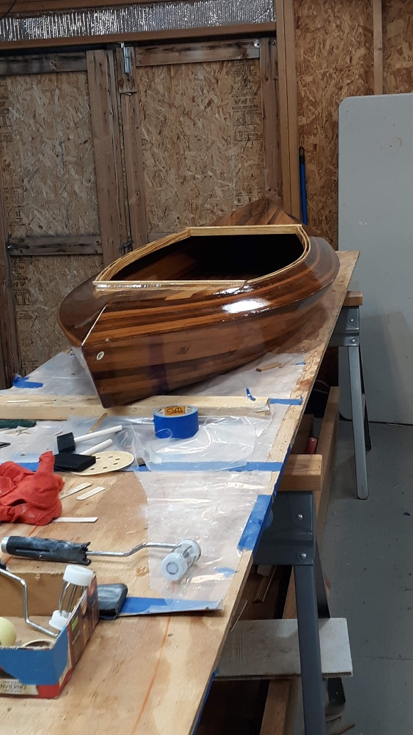

About 4 fill coats of epoxy later
N2Nf_Zo-GXHc_0V81AzxZuPeuahYWU8dCkuCciJERYaaW7hZUurOXkBc93FyIPcTaLkTmnP4mTIZsv2mdli2CrV4t9hNElUj2y4-SMaBbjUcrcIPI0MMfV01zAwHQvY1mSMbThXl
RkWlnsI3MMsyaONnFQmejOGYi2T2lW2JRSVMlH2c1ly_MuPjoNxaSy-WtAMXPOgT459vfJWy8HPzeKp4UGTvzmOTSaDMQ-Y6Q_Si8gADjiAWJQZ4g1Kik2EP2sspUl5RXnNe5GtK
I’m looking forward to wrapping this one up. More later.

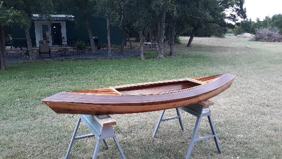

The Short Fat Wuhan Pirogue is complete and ready to go fishing! :
Finishing touches were the decks and inwhales. the inwhales, cowling or whatever it is called was a real challenge. the tumblehome lays way too flat, to be conventional.That means the border supports would have to bend extremely tight in two planes. I finally kinda copied Beekeepers cowing idea and adapted it to fit my purpose. I also added some graphics to the decks
Final stats:
Length 8' 9" target 9’4”
width beam 31 ⅝" target 30”
width bottom 25" target ??
flare 35 target 35degrees
depth 71/2" target 9”
rocker bow 13/4" target 11/2"
rocker stern 13/4" target 1"
weight 14.8 target light
3mm cedar strips, 4 oz cloth overlapped bottom and side joints. Pine trim supports
Lessons from this build.
Building strip, stitch and glue without plans is much harder than you would think. Aiming for specific dimensions such as rocker, flare, width, and length further complicate it more than just looking for a general concept. I missed most of my target dimensions anyway and changed them to “just look right”
2.Next time build a model, at least the major parts. For my small brain, I had to physically make changes to realize the interrelated effects of rainbow curve sides, end angles,rocker, flare, width, form placement ect. Joeys technique of clamping forms in place with a 90 degree wood piece is a real saver.Luan would be a real good idea. I was handicapped by the Chinese virus shutdown,i couldn’t get luan for patterns so I used cedar strips. The upside is that I went ahead and made a boat,instead of just patterns, I started out just trying to learn and have some plans for a starting point.
3. Making changes one at a time, and a little bit at a time makes for easier understanding, of what’s happening.
4. Be willing to miss some of your goals. For instance I had the rocker right on, after stitching and glueing the floor in place I’d gained at least a half inch of rocker on each end.
5. Search the forum and ask questions on the forum, that’s the only way I pulled this off!
6. Joeys post from years back was right… leave out most of the center part of the boat, weight will go down! Also the save weight tips from the whole forum work well. Especially Chucks efforts with door skins As I progressed I knew it was light weight, but never expected under 15 pounds. It is firmer and stronger feeling than any previous build.
7. Although frustrating at times it was a real fun challenge and I’ll do it again. Made me appreciate Matts computer, and envy the knowledge of members on the forum.. I got close to the boat I wanted! Success!
Hope to fish it next week.
Thanks to those who offered advice and encouragement,
Andy
