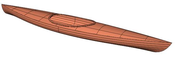

I have been admiring the looks of the Freedom for awhile. I ordered a set of plans for the 15 footer and got to looking at them. The short while I have been messing with wood boats I have always really liked the stripped kayaks. I contacted Matt and after alittle (alot)redesign work I have a set of plans enroute for a stripped Freedom II (III) :lol:. Gotta love Matt he'll do anything you want (within reason). :shock:
Concept Sketch
Same overall dimensions of the stitch and glue 15' Freedom. Darrel requested a little bit larger cockpit.
