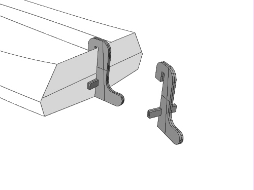

You could make a simple aft skeg that hangs off the transom.
Now keep in mind the size and proportion isn't exact. Just an idea/concept. But you could cut something out of 3/4" ply easy enough and trim and make adjustments as needed. Probably want a t-brace near the bottom to minimize and torquing stress. Could make from aluminum or some other material. But I'd prove it out with plywood first.
Doesn't look like much but it will provide a lot of directional control. I drew it flush with the bottom but you could have it hang deeper.
Yea that kind just popped in my head. The design needs a little refinement and getting that tail pinched in some rocks in a strong current could cause issues but it doesn't sound like beekeeper ventures into those situations.
For cheap and effective, that's about as simple as it gets.
