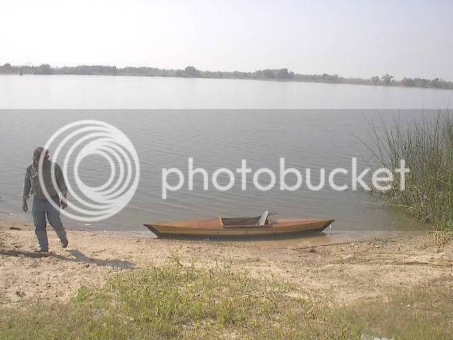

Here is a picture of my symmetrical laker you can see the center line and seat placement
