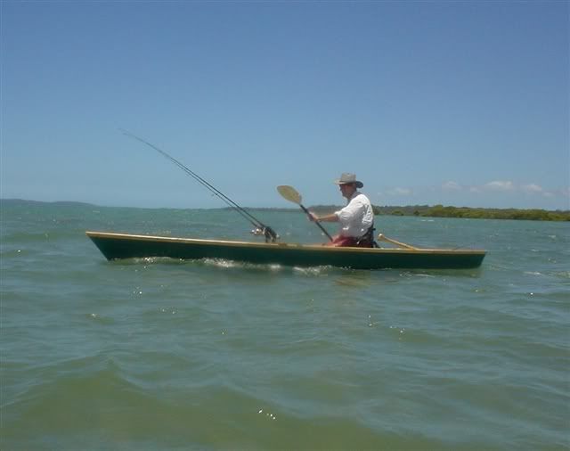

mine are sitting in front of me but far enough forward to clear the paddle. That way I can watch the rods and do't have to be turning around to get them.
G'day Sheetsrep and welcome aboard mate.
this is what i did in my pirogue.
Can move it back and forward to suit your self, quick and easy to put in and take out and a rock solid mount.
Flush mounts are next to useless IMHO in a pirogue unless you want to carry a couple of extra rods. :p

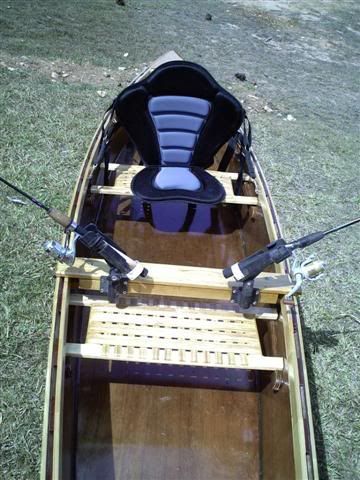

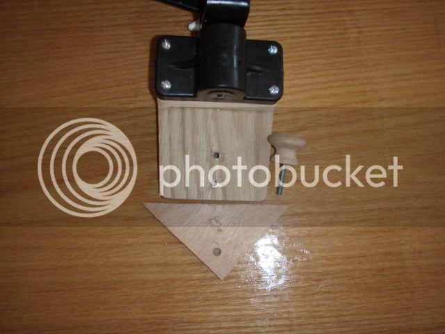

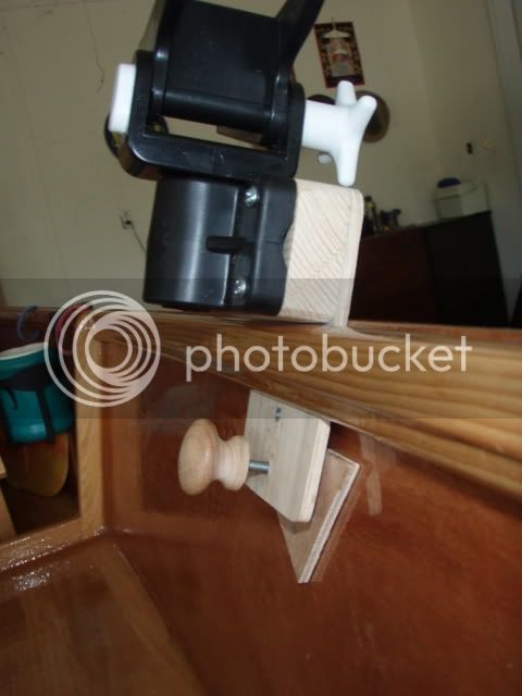

This is the fun part. Rigging your boat! there are many ways to go, the afore mentioned are splended ideas as well as what I came up with. You can duplicate it for both sides and it mounts in any spot I want and is fully adjustable. It's most usefull in front far enough not to interfere with paddling but easy to reach I can take it out easily for storage or transport. Like they say neccesity is the mother of invention. Have fun making up your own system.
