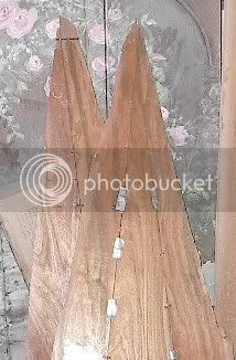

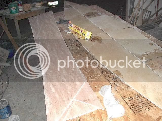

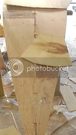

Here we go again Started cutting out the bottom panels and sides They are cut sanded and the bottom panels glued seemed like it was slow today for some reason.

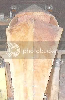

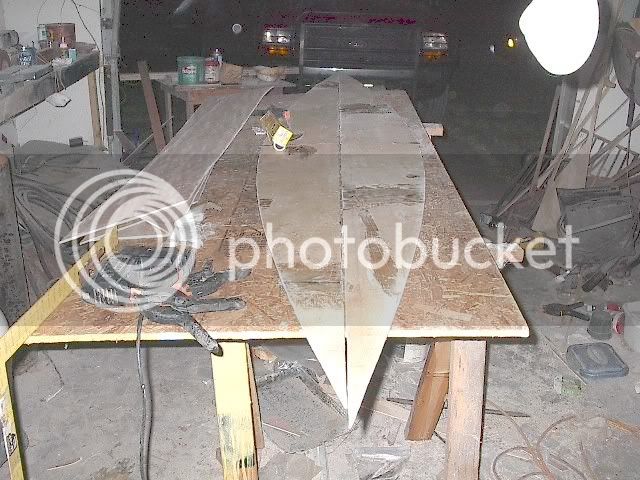

cut out my stations

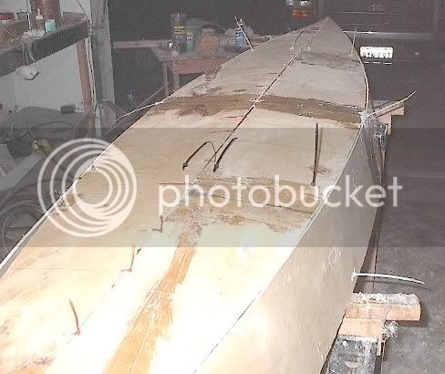

wired bottom together

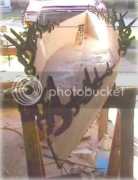

stitched the sides and stations in
turned it over and started to stitch the outsides then got to thinking why can't I do the outside like I do a perow, think Ill try that instead of stitching the outside and bottom together.

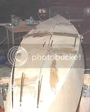

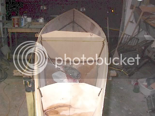

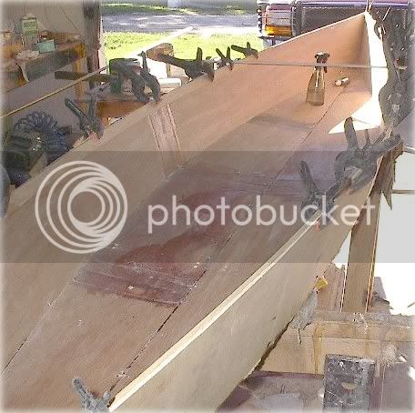

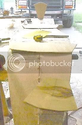

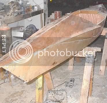

Got the bottom finished stitching and gluing . Started putting on the shear strips
got the fillets done on the inside
started installing bulk heads and filleting them
J h came by today brought me some 1/8 laun
so decks will be made of that

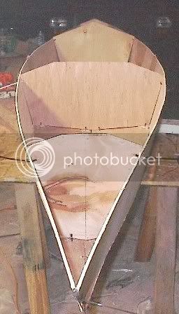

Little laker starting to shape up

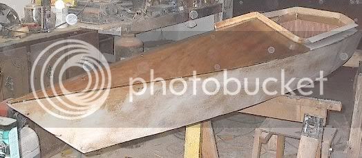

Got the decks fit out fillet and glassed

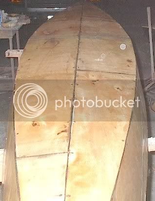

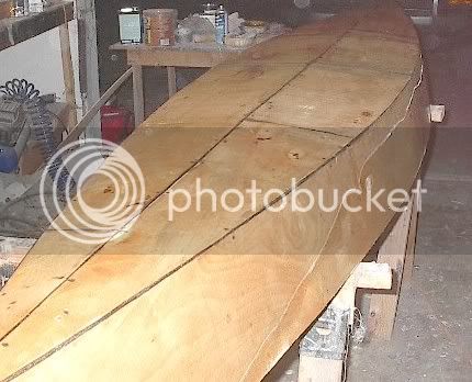

turned the hull sanded it out
wet out with first coat
got the glass on the bottom
called it a day while that dries

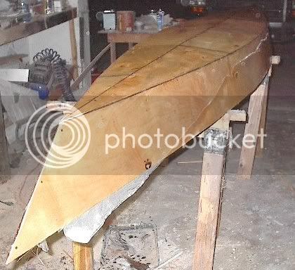

Starting to look like it might float

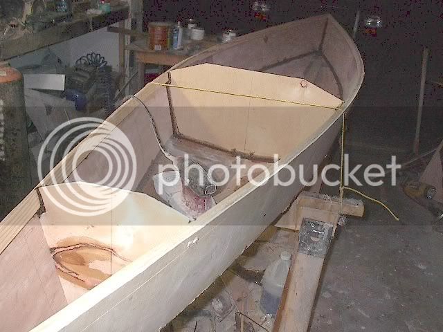

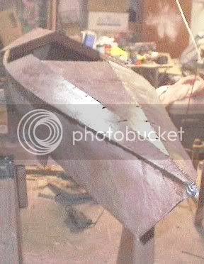

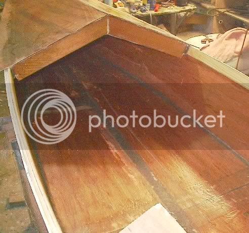

I have the inside glassed
Started fitting the decks
boy this 1/8 is different

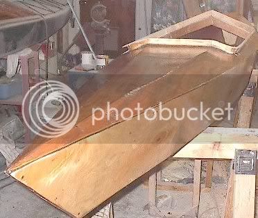

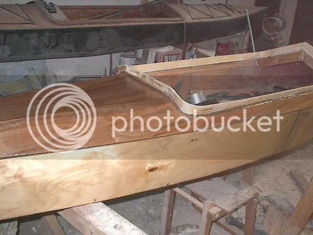

decks on and started running wood flower around seams

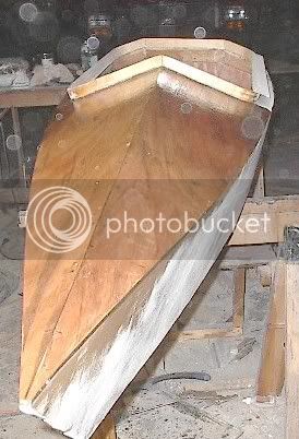

I like the looks of this little boat.
moving right along

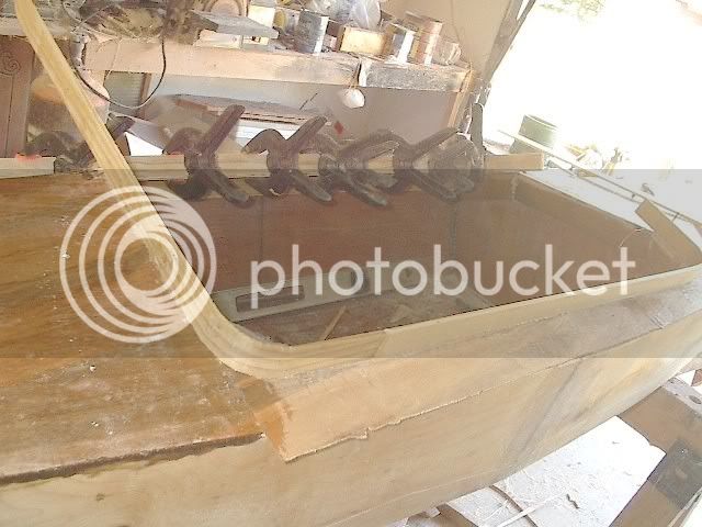

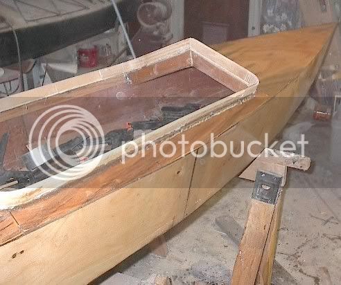

Steaming and bending bottom part of combing start mounting it

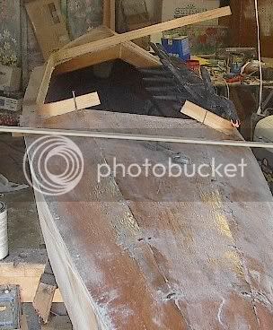

decided to go ahead and sand and glass hull before I put top combing on
Glass is really bringing out the grain
letting it dry before a couple more coats are put on then put on and glass top combing .
You see that Jack can't count to 3 :lol:
The wood is 1/4 bye 1 1/8 lattice slats
I just used a pot on top of the stove to boil it in
and if you will look in the third pic in my last post you will see where I started attaching the top combing
That answered you 2 questions :twisted:
