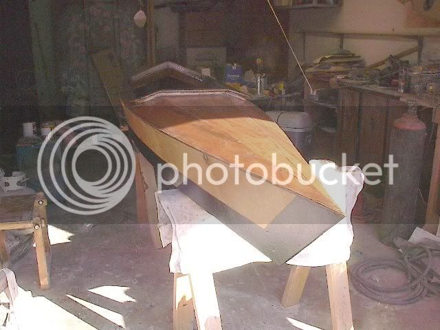

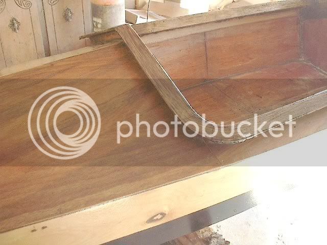

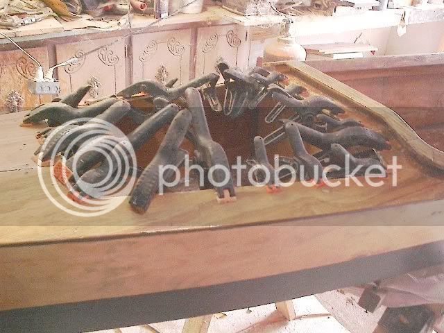

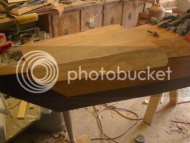

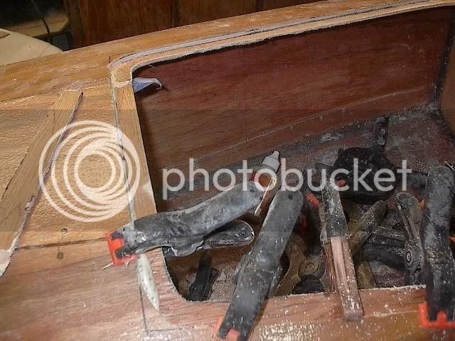

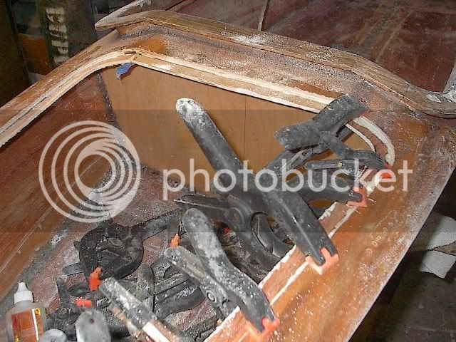

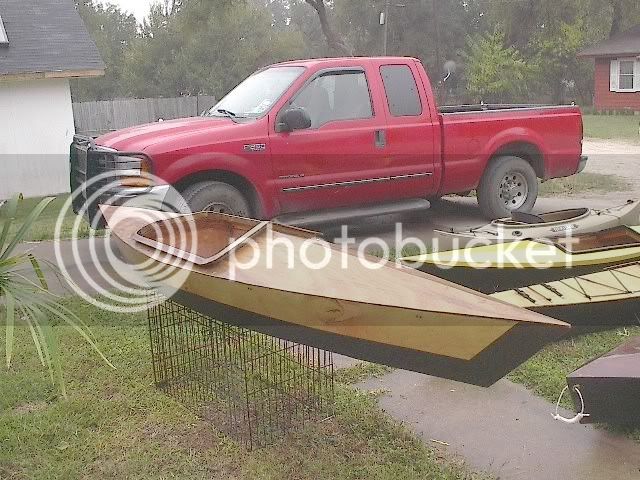

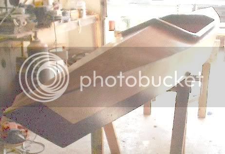

Combing is finished (putting top piece on)
tried something a little diferant weith finish on combing I like the looks of it

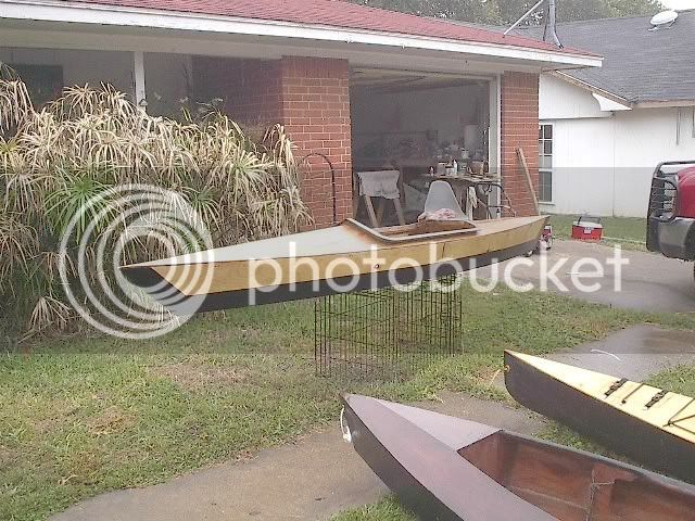

got glass put on bottom
a litl more finishing out and maybe tomorrow she floats
82
trr

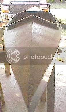

FINE looking boat ya got there. I do think, that if I were building i I would have to either round out or flatten the aft coaming on the cockpit.
But, that's just me talking.
It sure looks good.
Bald Cypress
You know its funny I was talking about that just today. It is a really strong design ,works just like a truss and sheds water well . but I was thinking a front deck similar to the rear deck might look cool. If you look at next to the last pic that would be a good looking nose for a boat

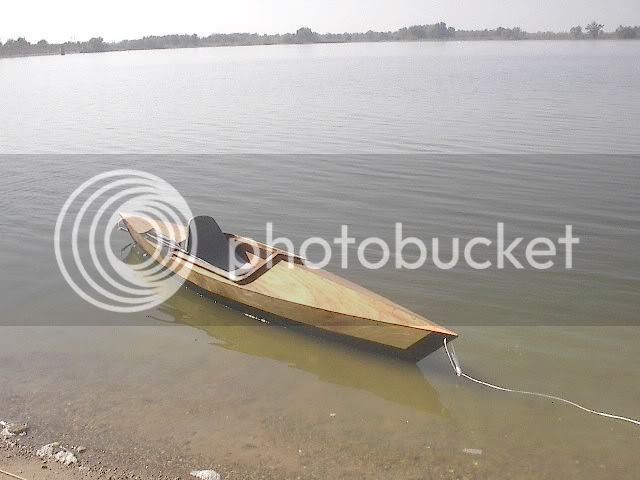

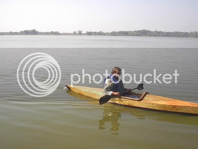

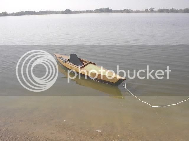

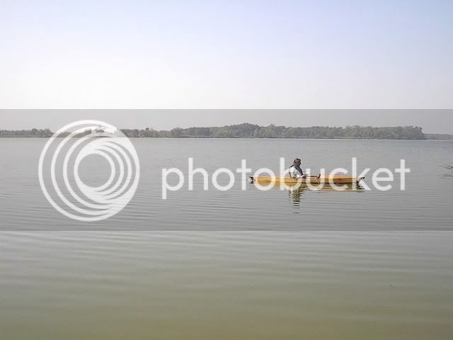

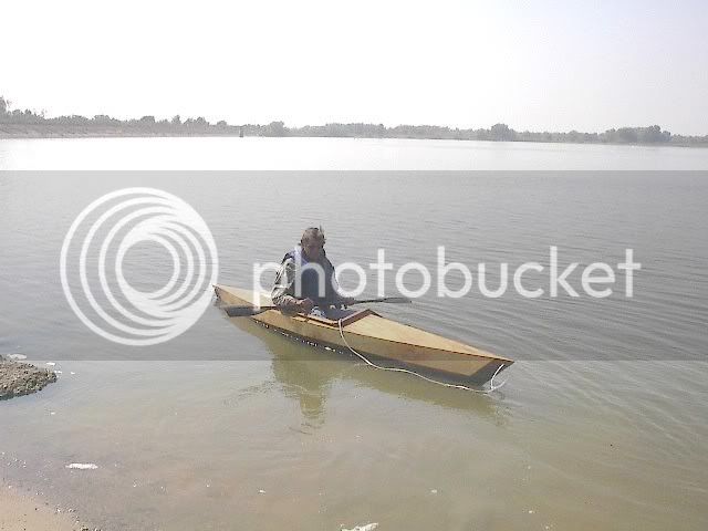

Well I hit the water with Laker today.
When we first pulled up I looked across the lake there were thousands of pelicans on the lake,very unusual to see them in this part of the country
Unloaded the Laker she is nice and light about 38 lbs
She floats like a cork on top of the water.
climbed in and away I went
I found out one thing right quick I was sitting to high in my lawn chair about 4 inches off the bottom the boat felt very unstable paddled back to the bank took out the seat just sat on the bottom it was a whole different boat then I need to build a low seat for this boat.
This little boat will fly and glides forever is a fun boat to paddle I noticed in pics the back was drafting about 4 inches and the front about 2 inches I may need to move seat forward a little the black is 4 inches wide on the lower part of the hull
It as a very dry ride also very little drip in the boat off the paddles and did I say it floats like a cork.
This is a nice little boat and has good performance I want to put a little more weight in it and foot braces and try it again
Good job Mat
I used 4mm 3/16 for everything but the top decks and it is still lighter than 40
Laker opinion went up a notch
I took the Lake to the river today and played for a couple hours adjusting the trim and a low seating arrangement make this a different boat she did everything I ask her to handled the swift water well and did good I should say excellent job going upstream in pretty shallow swift water. After today I will say I am impressed with the boat.

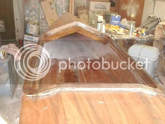

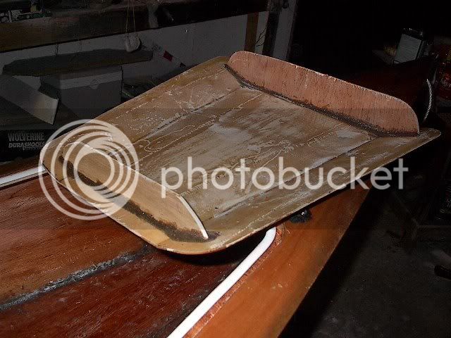

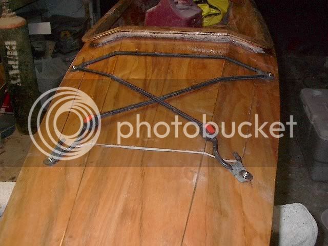

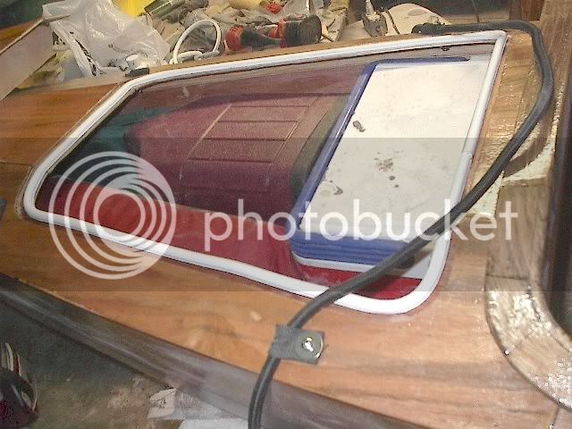

I started the final rigging on the Laker today Laid out my rear hatch cover and cut it.
Started installing the spacer lip
glued that in all around
Started installing the lower lip

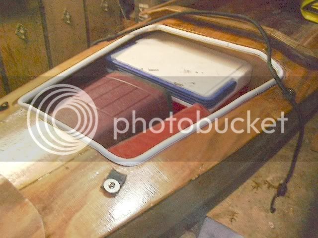

the hatch I cut in the rear is 20 inches long and 2 1/2 inches in from each side following the shape of the yak. I found I needed larger openings to get some of my gear into the hatch
I started final sanding for the varnish coats.
hatch is completed with gasket installed
It will hold a lot of gear
and seals up well good
also got one coat of varnish on
G'day Ron,
I like it. :D Simple, neat and effective. Might I very res[ectfully suggest a strip of ply round the underside of your hatch lid just to re-infoce it a bit?
Will add a lot of rigidity.
Your big hatch has given me food for thought. My opening is a little small for my liking.
Mick
I put braces undrneath the hatch cover
also the lips under the deck run full length and are glued into the sides that is double 4mm do you still think I need more bracing seems pretty stout .
Realy want your opinion

I love the big hatch in the rear and I may put in a bulk head and do the same on the front. It is so much easier to get to everything thru the big hatch and water that gets in the boat of off your feet and paddle drip never runs up into your storage. The hatch size is perfect for me.
