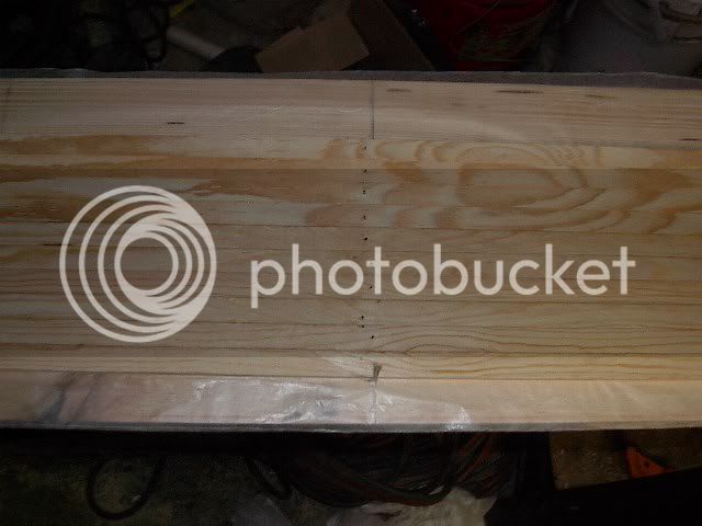

Yesterday I started ripping strips,today I started gluing up panels. I just laid them out on a sheet of ply marked off my panels and then drove nails in every 12 inches,using a brad nailer I bent the strips around the nails and nailed the strips to the sheet of ply,oh I put a layer of wax paper between the strips and the ply.
Have several panels done and they seem pretty light and rigid.
Here is one panel glued up, maybe you can get an ideal of what I am doing.
I layed the pattern out on a 1 by 12.
That was a bad pic to see it ,ok when you lay your patterns out you drive nails and bend a piece of wood around it to get your arc on a s@g I took my first strip and laid it flat bent in the curve around the nails then shot brads in it,then I starting adding strips, the strips are really in and arc of the side.
Thats probably clear as mud.
The panel in the pic has about a 1/2 arch in 8 ft,or curve

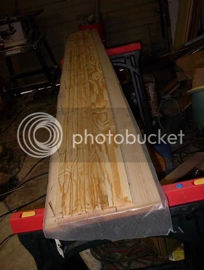

I've been thinking about this since craiggamesh built his strip pirogue. I hate the idea of using all of those staples. What if you layed out the strips like you did- just layed them down side-by-side and placed a batten over them at several places to keep them flat and used wedges against some solid cleats to squeeze them all together. You could lay out a whole panel at one time and wouldn't have the staples to pull or the holes to mar the pretty wood. I might give that a try.

Are you doing like I did for the stripper pirogue , I cut the strips , layed them out on a flat surface and used some good wood glue to hold them together. To have a tight fit , I put some weight on them to hold them down and keep them flat and used a series of some wide clamps to pull them together forming a single panel.
Some of these.
When the set up then ran a bead of epoxy along the seams to really lock them together. After that , they were sanded with a belt sander to get all of them the same thickness and nice and smooth. Then cut them to shape and put the boat together. Remember there are no curves ( so to speak) in a pirogue , just flat sheets of panels.
This is interesting. You could do all sorts of patterns in any sort of wood.
I wonder how it compares strength wise? The plywood has alternating grain due to the layers of veneers. This is gonna be solid wood with all the grain running one way... of course it will be glassed inside and out, I assume.
