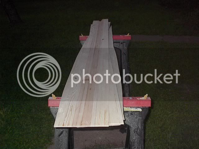

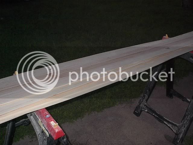

ok here you go Mike
Would you believe there is a boat in there
I finaly got thru sanding and its time for it to start looking like a boat.

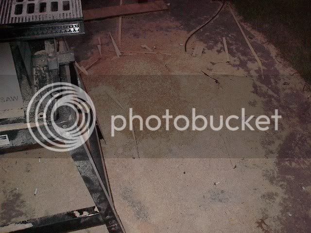

Ya ever wonder why they call it "sawdust" instead of "wood dust"? :?:
And where did all that grass come from? The last build featured a nice dirt yard........ :shock:
