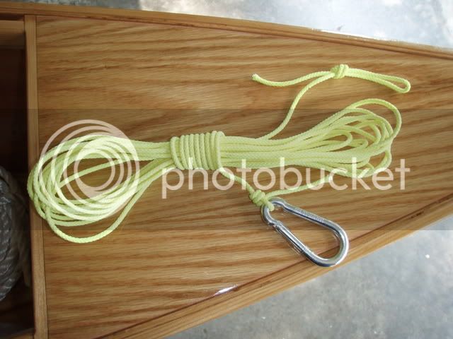

I tie my anchor off at the bow. I also have spliced an aluminium carabiner into the end of a shorter tail rope and tied the other end off near the seat.
The carabina is placed over the anchor rope. To raise the pick, I just pull on the tail roap from where I am seated and the carabina slips up the anchor rope and brings it to me. - easy. :D

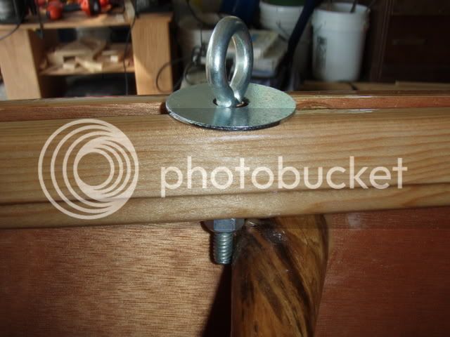

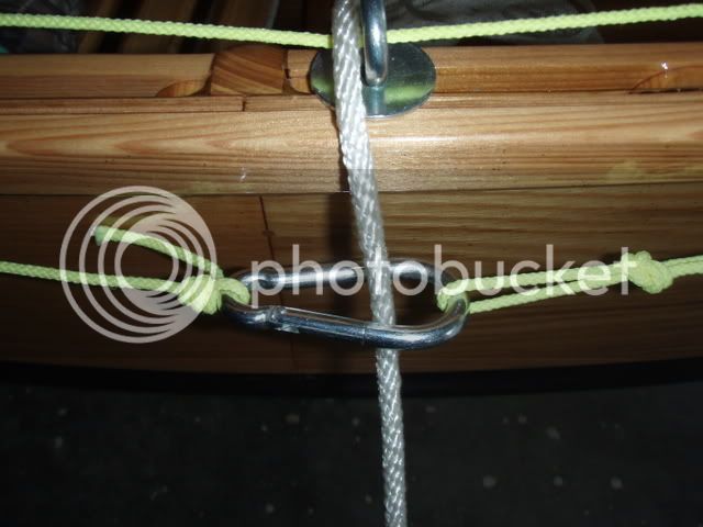

Mike I also rigged up a trolley for my pirogue that I made after looking at the ones on-line for kayaks. I simply used an eye hook at the bow middle and stern that are attached by going through the inwhale from the top with a square nut on the bottom and a fender washer at the top of the eyebolt. I just tighten the eyebolt and the nut stays jammed up against the boat and inwhale until tight. Then I took a small poly line and ran it through the three eyes and back to the middle where I attached a SRING CLIP to one end and a loop at the other. I hook the loop into the clip and then to the eyehook in the center, it's now ready for the anchor line and right next to me at hand in the boat. I have the same 10# coated mushroom you have and I leave the line coiled up under the anchor right in front of me in the boat. I then unclip from the eyehook, clip in the anchor line and ease it over the edge, then I can tie it off there or pull the small poly rope trolley with the anchor rope through the spring clip forward or aft until the desired swing is achieved.
I hope this helps you and I only spent a few dollars on the whole thing. If you would like I can post a pic or two for you that might make it easier to understand.

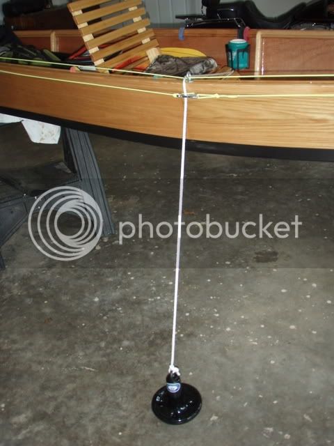

Manjimike
Jun 18, 2007
71
Manjimup, West Australia
G'day Flamike,
I have a fair amount of curve on the hull, so the centre padeye keeps the line in place. The anchor line runns out thru the carabiner and the tension on this keeps it away from the hull.
Hope that helps
Cheers Manjimike

Manjimike
Jun 18, 2007
71
FlaMike said:
Manjimike, those pictures you linked to really helped, any chance you have one showing the rig "in use?" Or a drawing?
That 1st foto is with it set to use, just needs the anchor to be lowered. The ropes are locked in the cleats etc
Cheers Mike

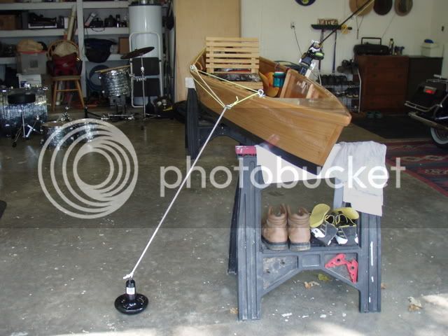

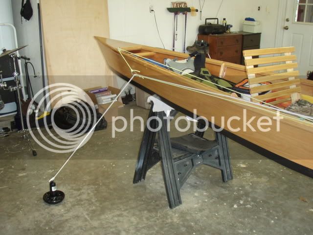

Here are some pics of the trolley i did. hope it makes it more clear!
one of three eyebolts
the rig ready to string up through the eyes
the anchor line going through at center
pulled up to the bow
And to the stern

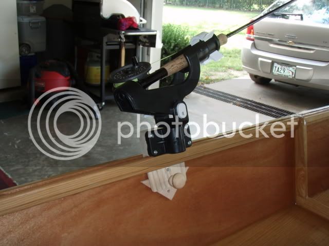

Here are some pics of the rod holders I got at Bass Pro for only $14.99 and shipping was only 3.95 cuz it was under 15.00 dollars. Not a bad deal!
I just rigged up a simple wedge system that works really well at holding it stable. It also can be moved wherever I want it, or on either side. I have found so far that one rod is pleanty to handle as I mostly use the fly rod but I can stow the spinning rod and or use it also with no problems. the rod holders are fully adjustable and work a treat to quote Mick.
Have fun making your own custom applications Mike and please share what you came up with. 8)
here is what they look like and you get two
The parts- a drawer pull with a threaded rod glued in it and some pine and 1/4" ply scraps and two blind nuts. The second one holds the triangular block on the unit when it's not on the boat so I don't loose it.
front view
rear view
with my 9 ft 6wt. locked in
