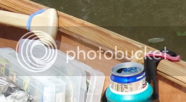

I'll get a Velcro wrist band and some parachute cord to make a paddle leash. When paddling, the band goes on the wrist, when I lay the paddle in the hanger, I'll transfer the Velcro band to the rail. I'd hate to loose a paddle!
I have made some "quickie" paddle leashes and boat tethers with the following:
Get some of the velcro cable ties, you will need two, (I got mine from Home Depot) and a one inch webbing tri-ring. The cable ties are 8" long, hook on one side, loop on the other side, so the will stick to themselves.
Loop one end of one thru the end of the other (same side up) I am using two different colors just so it shows what I am doing.
Then place the tri-ring on as shown.
Then loop the other end thru the other, capturing the tri-ring. And snug it up.
And there you have it.
Tie a cord to the tri-ring. I usually wrap this end around the paddle and tie the other end to the boat. I also have a version with about a twenty foot length of cord, we wrap the velcro end around our ankle or wrist and the other end tied to the kayak when we go snorkeling.
You could aslo just make a loop knot in the cord and pass the velcro ties thru it and not use the tri-ring.
I would suggest not having the paddle leash attached to your wrist, but to the boat instead, tied to the same side of the boat that you have your paddle keeper hook thingy located on. That way you just have to put the paddle in the hooks and not have to take anything of your wrist. Paddle stays with the boat.
DM

Yours is colorfuller than mine. I have a 2' chunk of 1/16" bungee with bowline knots in each end. Lay one end next to the paddle shaft, roll the shank through a loop and you have a loop around the paddle. Now, with the other end of the bungee cum tether, do the same to one of your wrists.

Wow D-mouse, I guess great minds do think alike! I have been using these also. They keep things at hand and secure. they work even when wet and are very inexpensive. It keeps my water bottle close at hand and that's a big plus! :wink:
