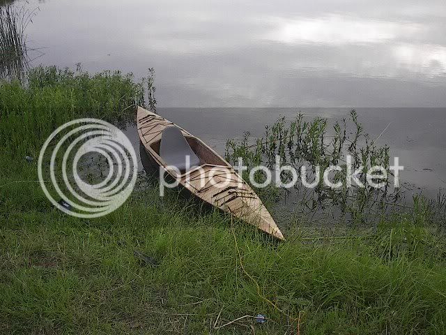

The one I made , the 1st Freedom to be made. .

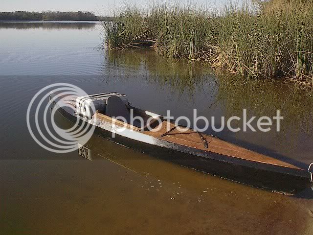

Micks , Laker 14........

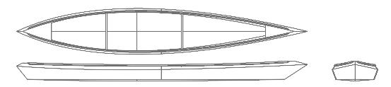

The TV is in the pirogue section on Matts web site .........Here is what it looks like without the top on it.
Scroll down , they are the last 2 on there. One narrow one ( the original ) and one wider one.
http://www.jemwatercraft.com/PirogueCompare.php

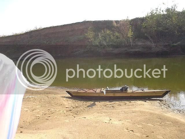

Not to ...SCARE YOU... , Ron paddling his modified one.
It can be done the way you want it and as you can see it will take everything on a trip except the kitchen sink. I still think Ron had one in there since he never really unpacked it all the way while we were camping. :wink:
