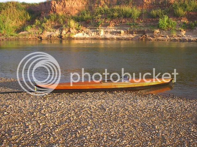

The Oktawa I think is his prettiest yak and a great performer,the ugly duck I just finished is probably the ugliest boat
but the fastest flatwater and downriver boat he has designed,The boats that keep haunting me are the north wind and the southwind, I cant wait to see Darrels strip Northwind and maybe I can get to paddle her.
I am starting an 18 ft A Laker (Cuda) This just might be the boat that outshines the T-V in my stable,she will be set up as a long range river cruiser.

Jack there is some subtle things in my yaks you have missed,one my bulk head is set in the front of the cockpit to use as a foot rest that I can kick from,so I am familiar with the leg thrust. As mentioned in the above post I was kicking to hard and overpowering my paddle and I had to ease off. second thing my cockpits have been resized to where I can lock my knees under them and are padded. In a sea kayak I can see the fit like a glove . In a river I am not going to do an eskimo roll,I want to come out of the boat for several reasons,one in shallow water its hard on the head and dangerous,most of the time the rivers I paddle arn't over a hundred yard wide,so I can go to the bank and remount are do a deep water reentry
plus in portages ease of exit and reentry are very important.A tight fitting cockpit would kill you on a race like the Neches where you are in and out of the boat 10 to twenty times in a race.
Backrest,nope non ,look at the above clips and any video on the racing kayaks no backrest are used , they inhibit the twist of your torso, after a 20 miles race your back would be raw.
