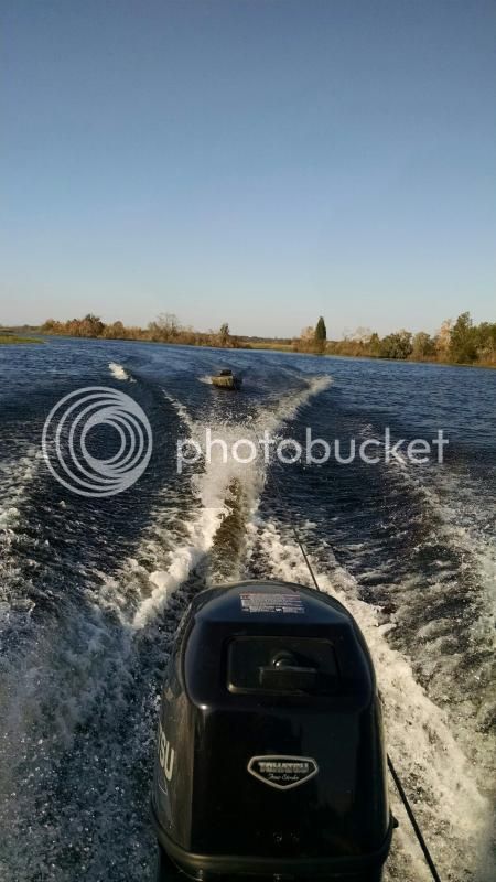

took my kids, 11 and 13, out for youth duck hunting day on sat. Opening day is this coming saturday so good scouting opportunity. We found good spot and saw alot of woodies and they had their chances and a few shots but no hits. "Dad, you were right they fly pretty fast." anyways good trip and I enjoyed having the piro to set up the decoys and paddle around and it towed great behind the boat - decoy sled!
