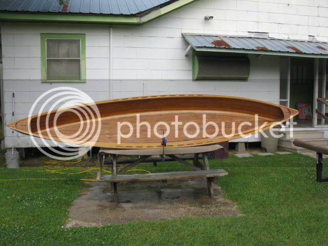

I love the amount of flair you have on this boat. The third picture in this set really shows it off. I'm not talking about functionality. I just think it adds a lot of elegance to the lines.
Also, I don't mind ribs in a boat at all, but the cleanness of this one inside really sets it apart.

Thank you for the kind words. :) I like the way it looks also, but I'm biased. I hope it performs as well as it looks.
Initial stability seemed less than my hard chined pirogue, but as I leaned the flaired sides increased the secondry stability. Leaning over It felt very firm, like my other boat. Swampwood thought it might have turned better. I think it might be a little faster (easier to paddle). Time will tell, one way or the other.

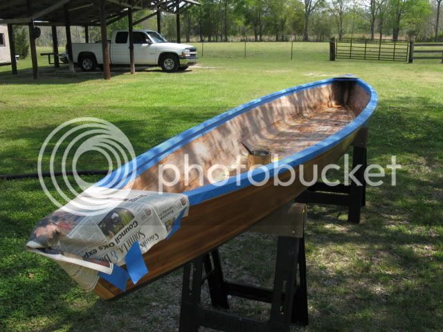

It is not so pretty know. Stripped down to the wood on the inside. I still have tears from removeing those 5 coats of varnish. They are NOT from the finish remover, or the four days of sanding.
I only tried the boat for a few minutes. I noticed little movement while underway. Launching and getting out it was obvious it was too weak as is. Nothing but doing it correctly would work in the long run.
I made an error by not glassing the inside. Looking back, I should have seen the need. I used 1/4" srips on the sides. 3/8" strips on the sides, like the botom would have helped also.
The gunnels and inside rails are cypress. Whiteoak would have been more ridged.
The fiberglass and epoxy arrived this afternoon. The fun begins 7:00 am.

We finaly finished the glass on the inside. More sanding now, and after the epoxy cures more varnishing. I'm getting lots of experance on this one boat.
