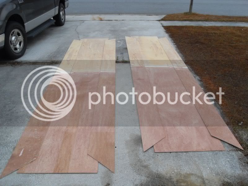

My first picture shows my material, sides and bottom, cut and scarffed.

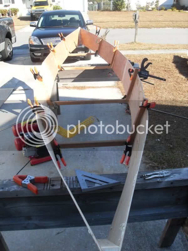

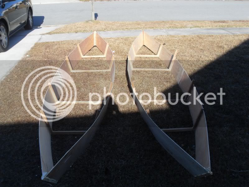

Picture #2 show boat #1 sides glued up with both the bow and stern stems in place.

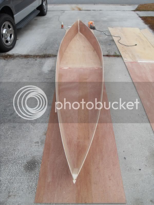

Picture #3 shows the ribs being glued in place. For the ribs i am using some scraps of cherry i had laying around in my wood rack that was needing to be used. Funny how getting the ribs in place really gives you an accurate view of what your boats shape will be once it is completed.

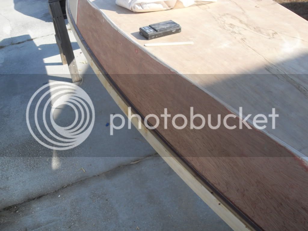

Picture # 4 shows both boats with ribs glued in place.

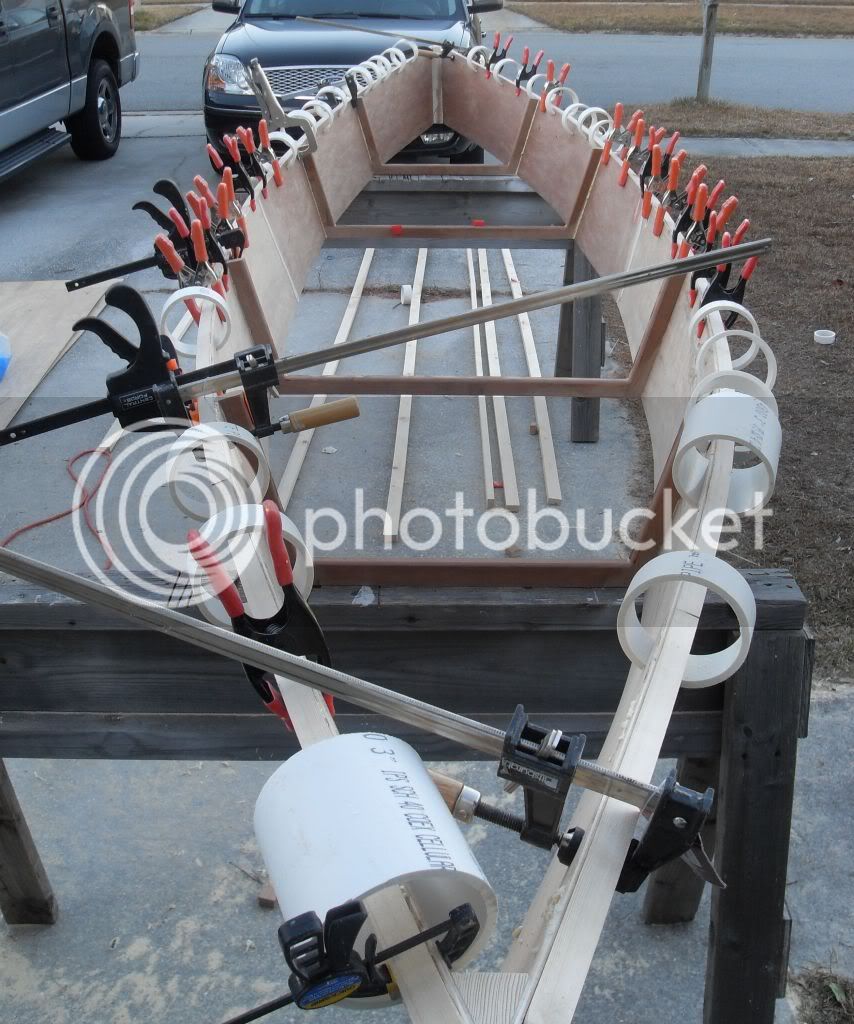

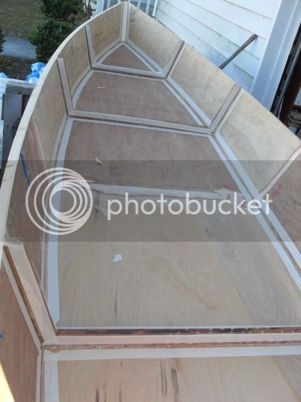

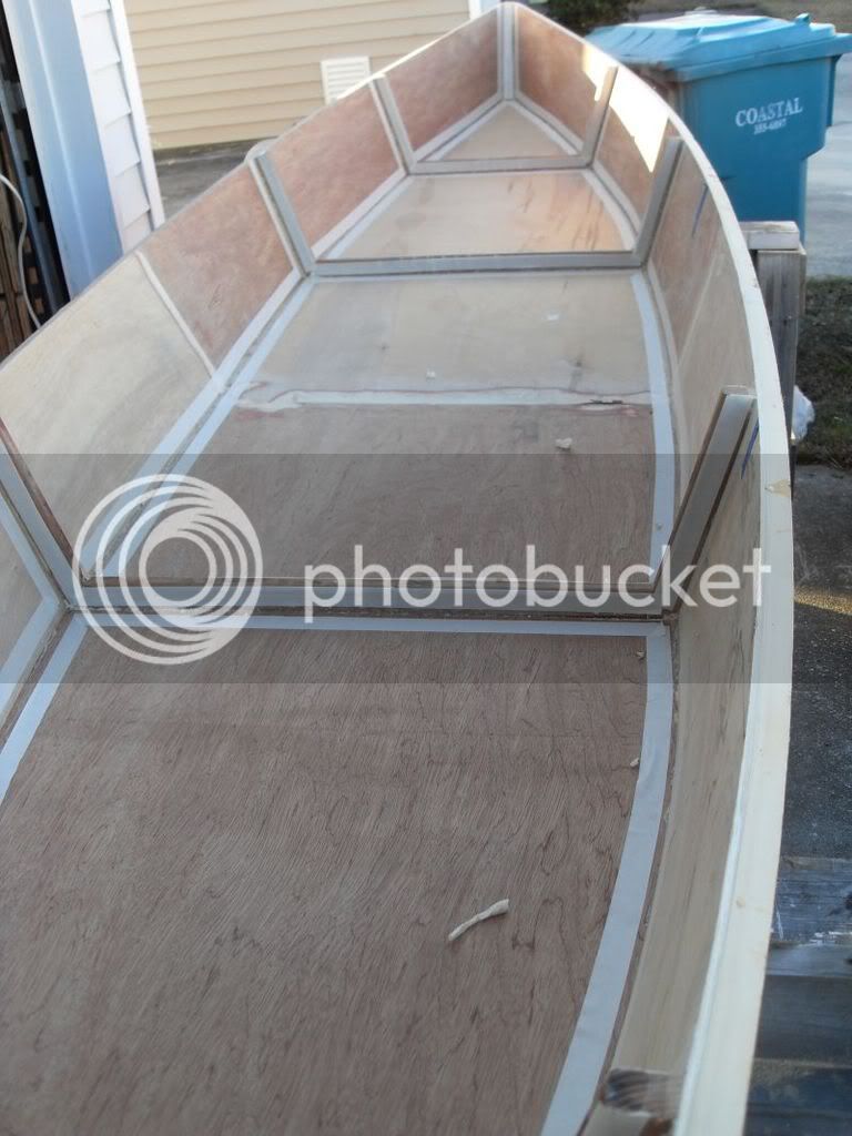

Picture #5 shows a close up of all the clamps used to attach both outer gunwalls to boat #1. Now things are really taking shape and the graceful lines of the boat are more evident. To make the gunwalls i bought 3 2x6's, 8 ft long and scarffed them together.
So far everything in the build is what everyone here on the forum has said. My only problem is not having a dedicated workshop to work in. Everything is done outside on my driveway. So things have to be pulled out of the garage and then put away at the end of the day and then the boats covered up to keep somewhat dry in case of rain. If everything progress as I plan hopefully by christmas we will be done and ready for our maiden voyage.
NOW we're in trouble, guys! We have professional cabinet builder on board. There goes all my my excuses and I'm sunk. My work, that looks like peanut butter spread all over a banana, will fer sure be relegated to the cellar now.

Please tell us about your PVC pipe clamps.

I used a section of 3", schedule 40 pvc pipe cut in 1 1/2 section. First I ripped the pipe lengthwise on the tablesaw. One word of warning if you decide to make these and make your first cut on the tablesaw. As you finish your cut, the pipe will start to squeeze down on the blade so be careful or else you might get a nasty kickback. The best thing might be to only cut 3/4's the lenght of your pipe so you have a part of the pipe still intact to keep from pinching the blade.

I should have made some of those PVC clamps. I used every clamp I had on the chines I just put in, and the rub rails are obviously longer. I'm definitely going to copy that idea before I do my rub rails.

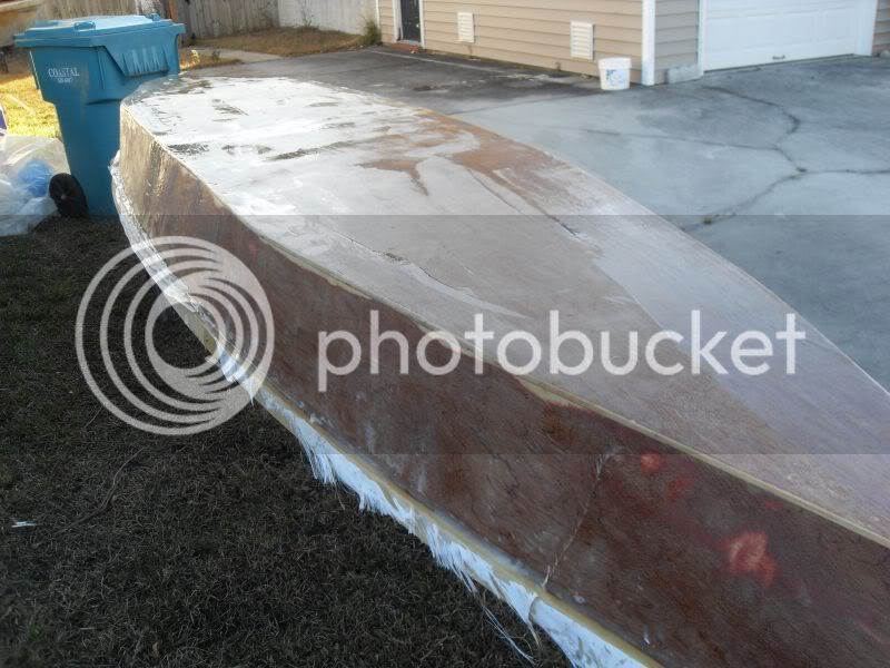

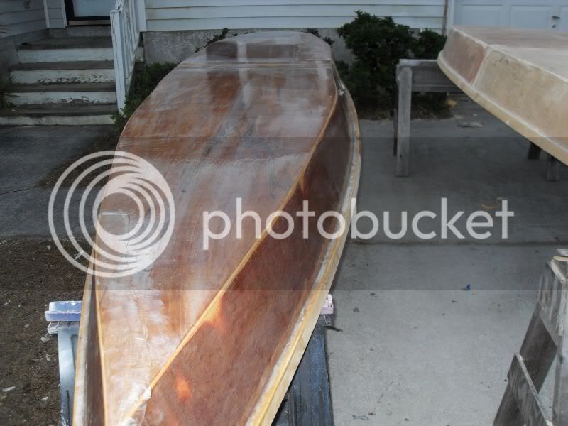

After I completed the 2nd boat, I started to fiberglass the bottom and sides on boat #1. I was able to get it covered by 1 or 2 pm so I still had 3 hours or so of sunshine for the resin to kick off and harden before nightfall. It was too dark to take any pictures, but hopefully i can work on it tomorrow and get it cleaned up and ready for coat #2 of resin and maybe a patch or two of fiberglass that may not have bonded to the hull.

Alittle more completed this afternoon. Began by sanding the first coat of fiberglass and resin. Of course there were a few areas that didn't adhear so sanded them off and laid in patches for them.
Tomorrow afternoon, hopefully i can sand out the 2nd coat and get a 3rd coat of resin on boat #1 and get things ready to glass boat #2.

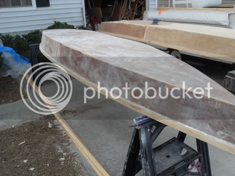

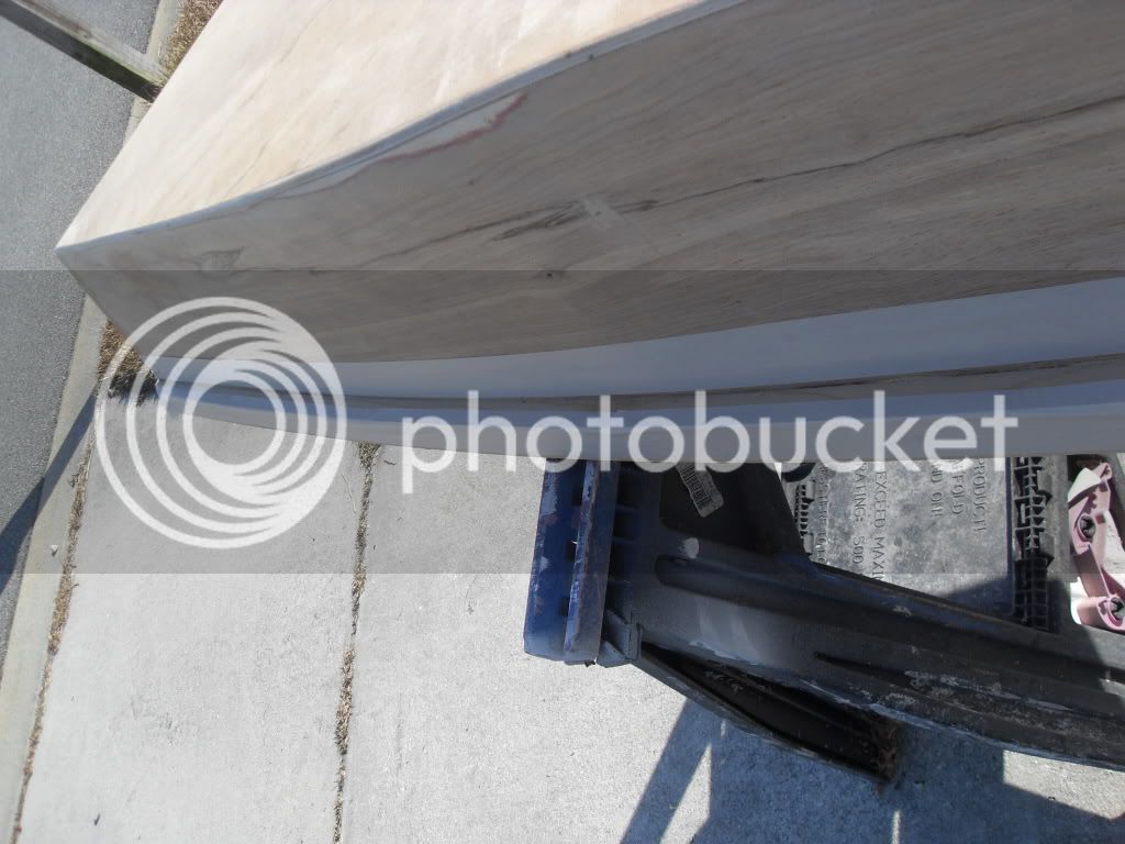

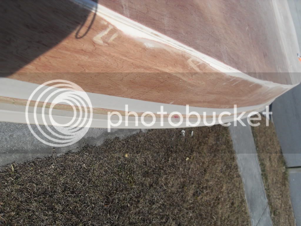

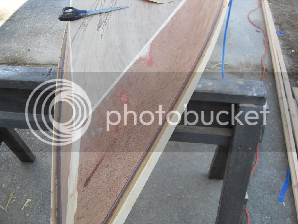

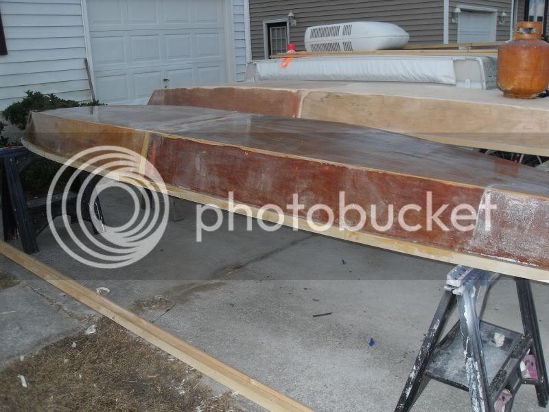

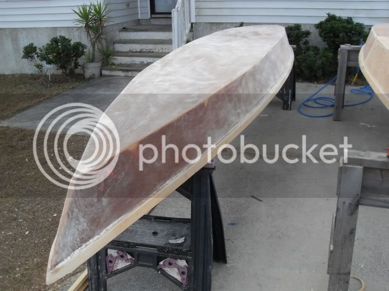

Finally got some free time to get back to work on the 2 boats this weekend. Boat #1 has the 3 coats of resin applied and Friday I was able to get started on applying the fiberglass to Boat #2. Here is the pics of boat #1 taped off ready for filleting.
http://i433.photobucket.com/albums/qq53 ... 0586-1.jpg
http://i433.photobucket.com/albums/qq53 ... 0587-1.jpg

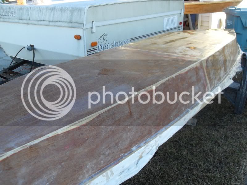

Glassing #2 went pretty well considering the cooler temperatures we have been having around here. I was able to get done before the sun set too low behind our house and neighbors house. It was still tacky but i covered it with the plastic i have been using to keep them dry. Still tacky today but with alittle sun on it tomorrow it should cure with no problems.
http://i433.photobucket.com/albums/qq53 ... 0584-1.jpg
http://i433.photobucket.com/albums/qq53 ... 0585-1.jpg
I can see some of the things i will do differently when i glass the insides and when i get ready to build my next ones. Main thing I will do differently is the soaking coat of resin before laying out the fiberglass. On the bottom I was able to get a good soak thru the glass but I had to work quickly around the side to paint the sides with resin before laying the glass down. These first two will be painted but the next one I build I want to do a strip pirogue with some of my stash of wood I have collected the past few years. I can hardly wait to get them in the water!!!![/img]
