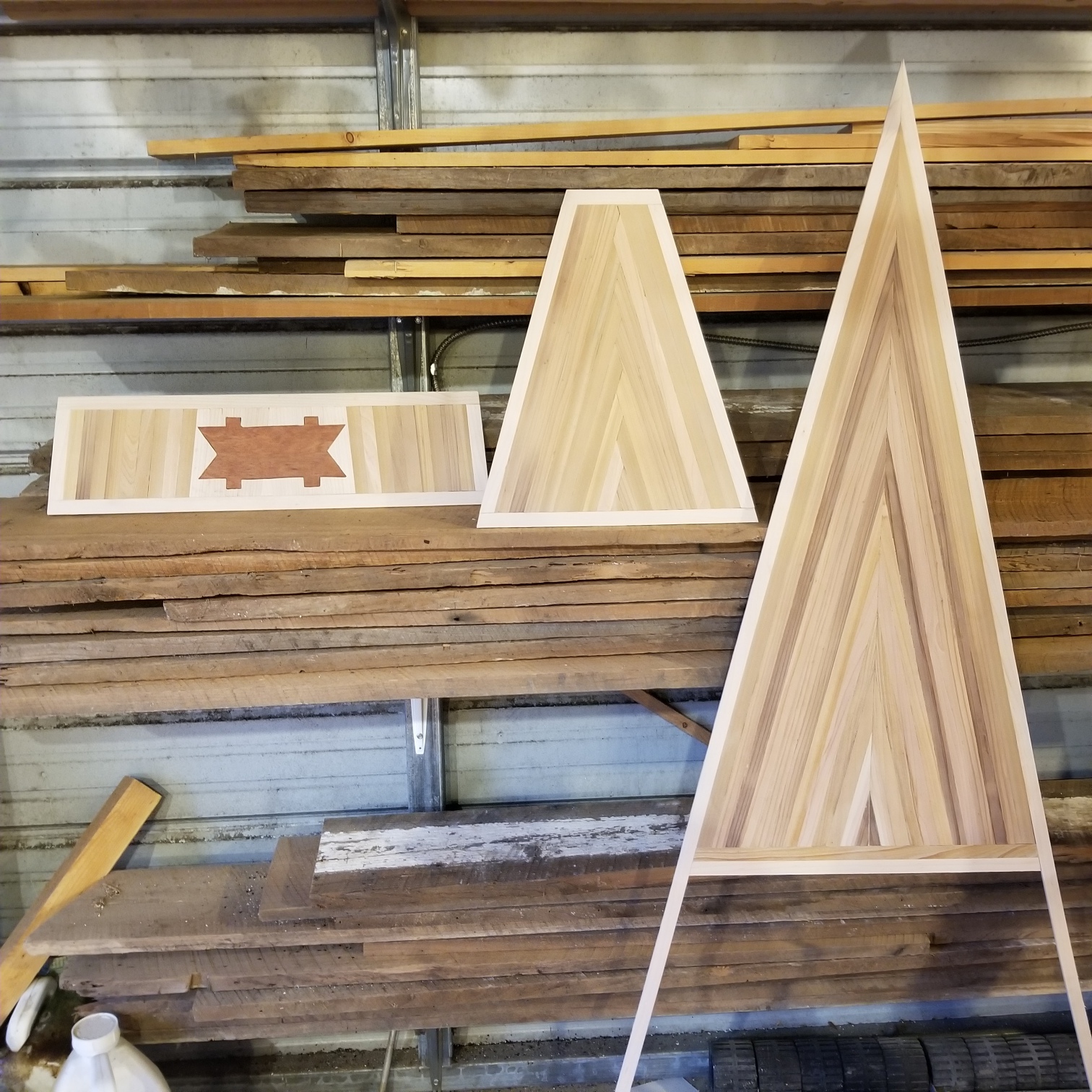

Thanks Jack. Well, I have still been working at it. Been making dust and wood chips with a planer. Managed to put together the three decks this weekend even though it was Easter. The trim pieces are maple while the strips are cedar and cypress. The small mid deck to the left has a piece of bloodwood in it. It took a while since they all went through a few different designs and assemblies. Decided to put a little hardwood on the edges. Here they are as a group. Pay no attention to pile of cypress behind the deck panels. :rolleyes:
Next up, I think I will stain the hull panels.

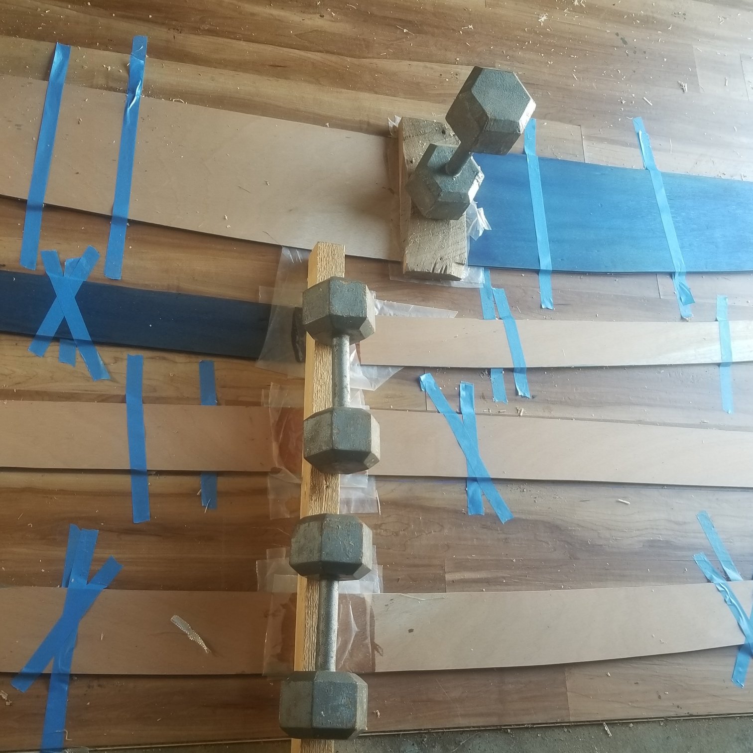

Those who aren't color blind will notice the blue stain. It is an alcohol (denatured) based aniline, liquid made by Keda. I flooded each piece with a chip brush using long fast strokes. It took 2-3 applications to get it this bright. (My son loves blue, so I figured why not) Of course, I stained the wrong sides of a few pieces and didn't notice until it was time to lay out for glassing together. Oh well, before long, no one will see it as it will be inside and covered by floor pieces.

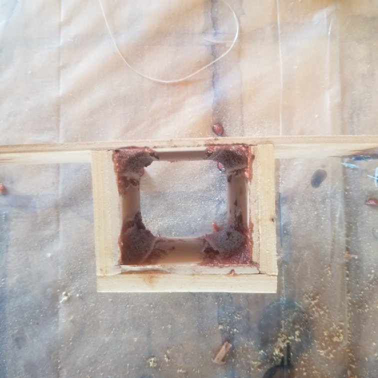

Fillets IN the scuppers. These are maybe 2 1/2" square! Jumbo craft stick to accomplish this. Have to glass these eventually. :confused: 1/4" x 1/4 squares wrap all scupper tops and make a "T" above the frame. I used scrap cypress for this.

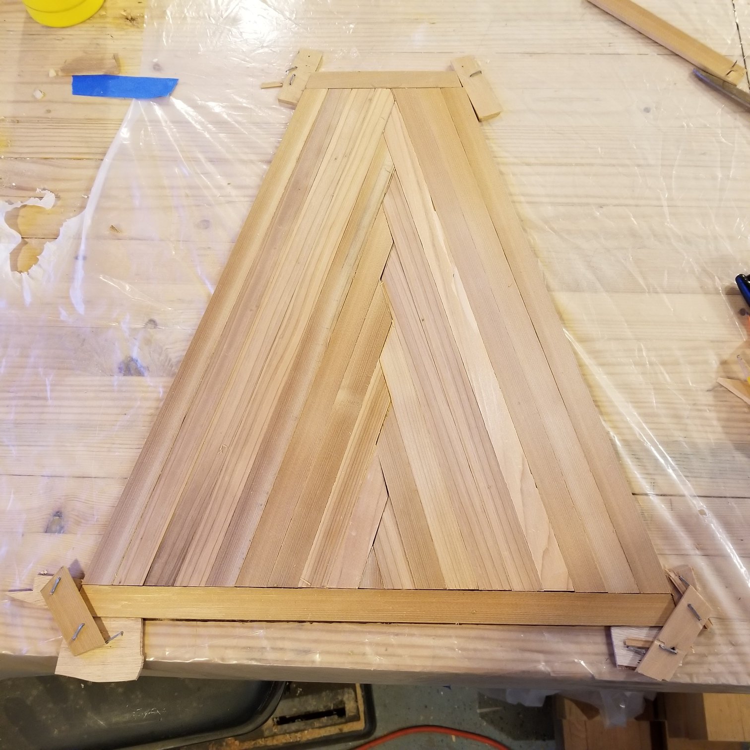

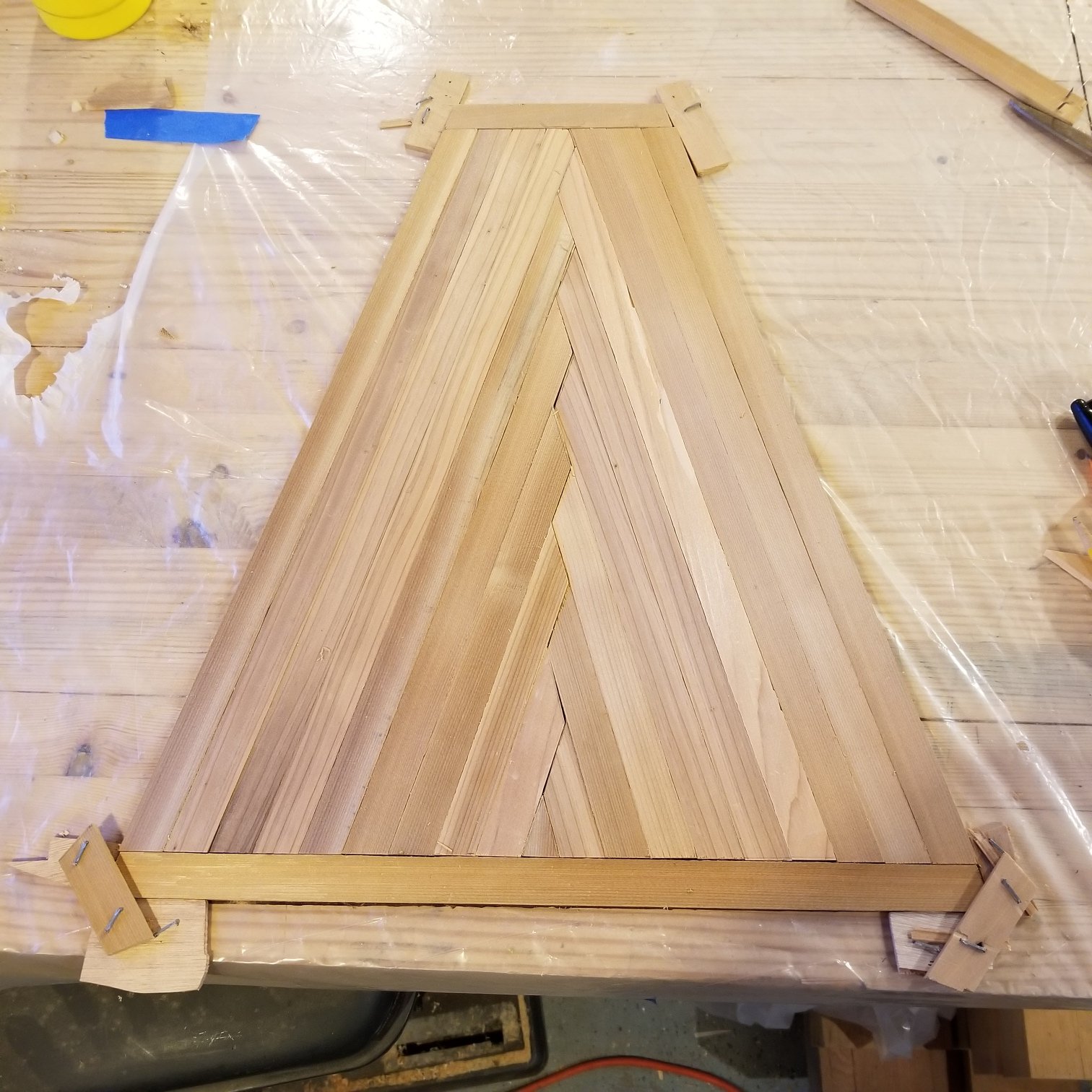

Continued work on the foreword deck today. In between drying sessions, began work on the transom piece and the aft deck. The aft deck is dry fit. Will have to fill in some of the small cracks, but here she is.
Not a whole lot to show but in my defense those angles had me stumped for a while. :rolleyes:
Real nice! I need get brave and try some angles, you maybe my inspiration

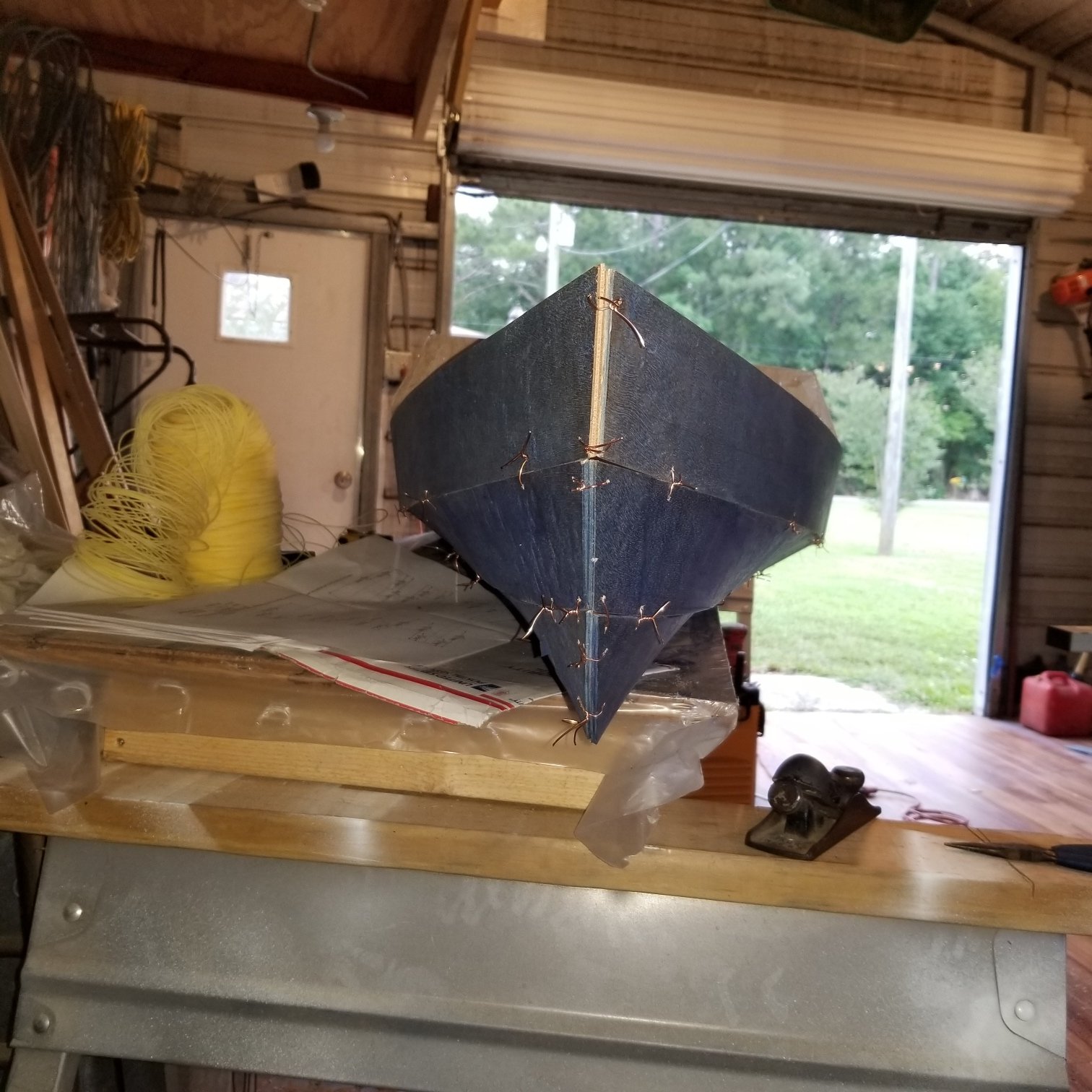

No pics this time. Just a quick line to say that I was pretty sure that Matt over at JEM had sold me one of those 3D puzzles of The Eiffel Tower or something. I could not see how those pieces of plywood could possibly fit together with those crazy curves. Well, they do fit together as I started to stitch hull chines together earlier. I didn't make it too far into it, just far enough to know that the curves DO indeed fit together.
Ok, so maybe just one pic of the cockpit. Found that it was easier to duck tape the outside into place then fillet the inside. This was before fillets.

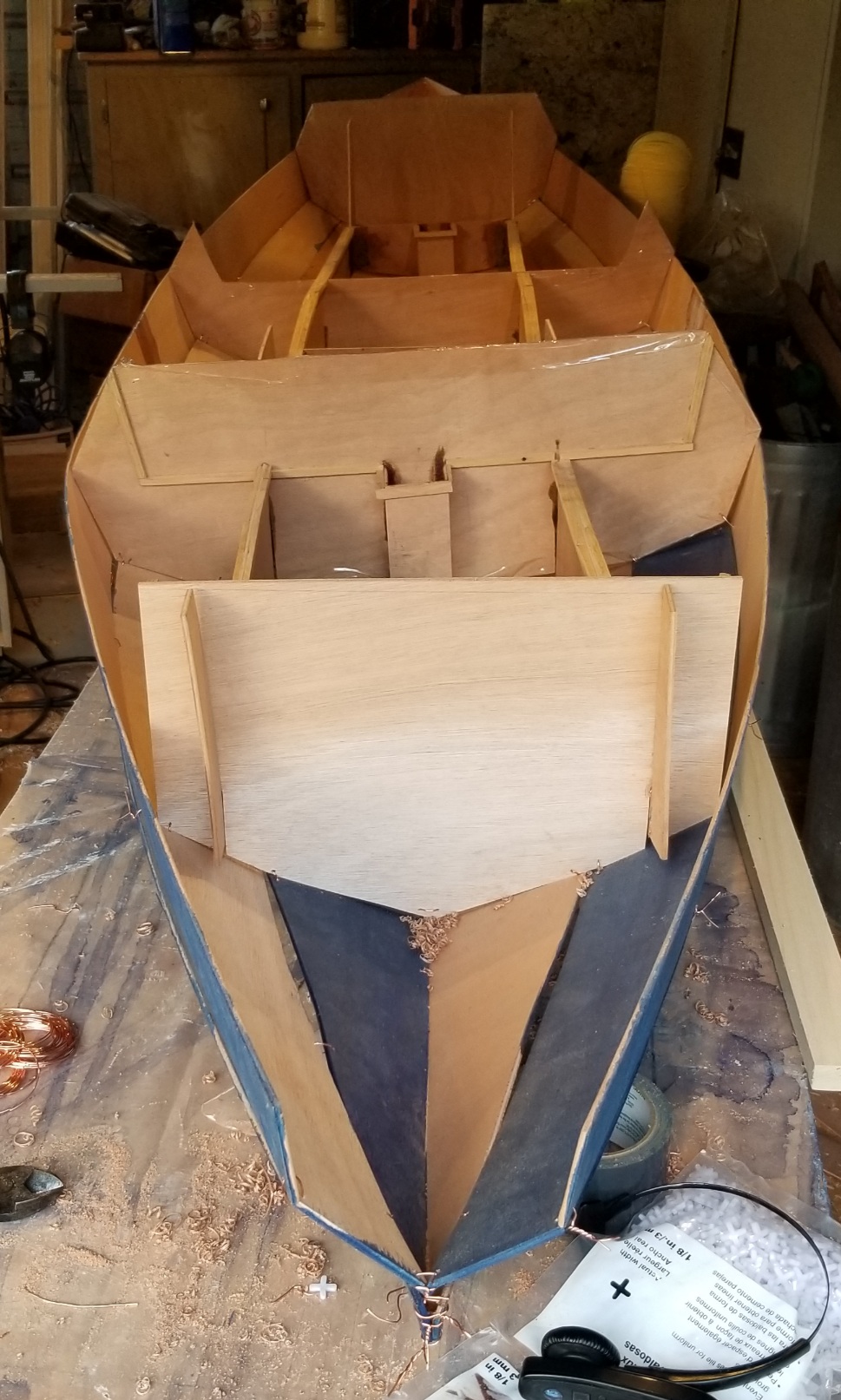

Lots of wire tightening and loosening to go to get her straight and right, but the hull has taken shape. She was flat panels and lots of doubt on Sunday. :p

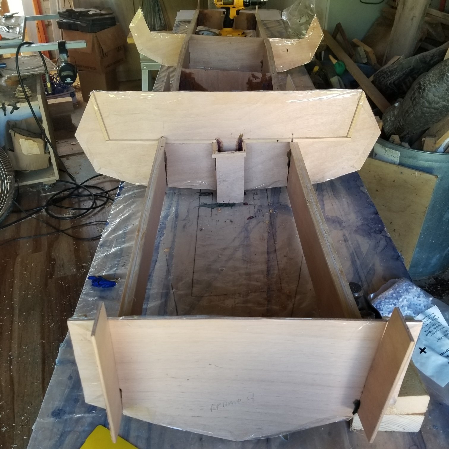

If anyone still cares about this build, let me catch you up. Covid nor hurricanes got me though they tried. They did keep me busy, but in between the busy, I kept building.
This is a pic of the interior support structure of the boat. This was fiddly, lots of measuring to get straight and even, then carefully wire together.
