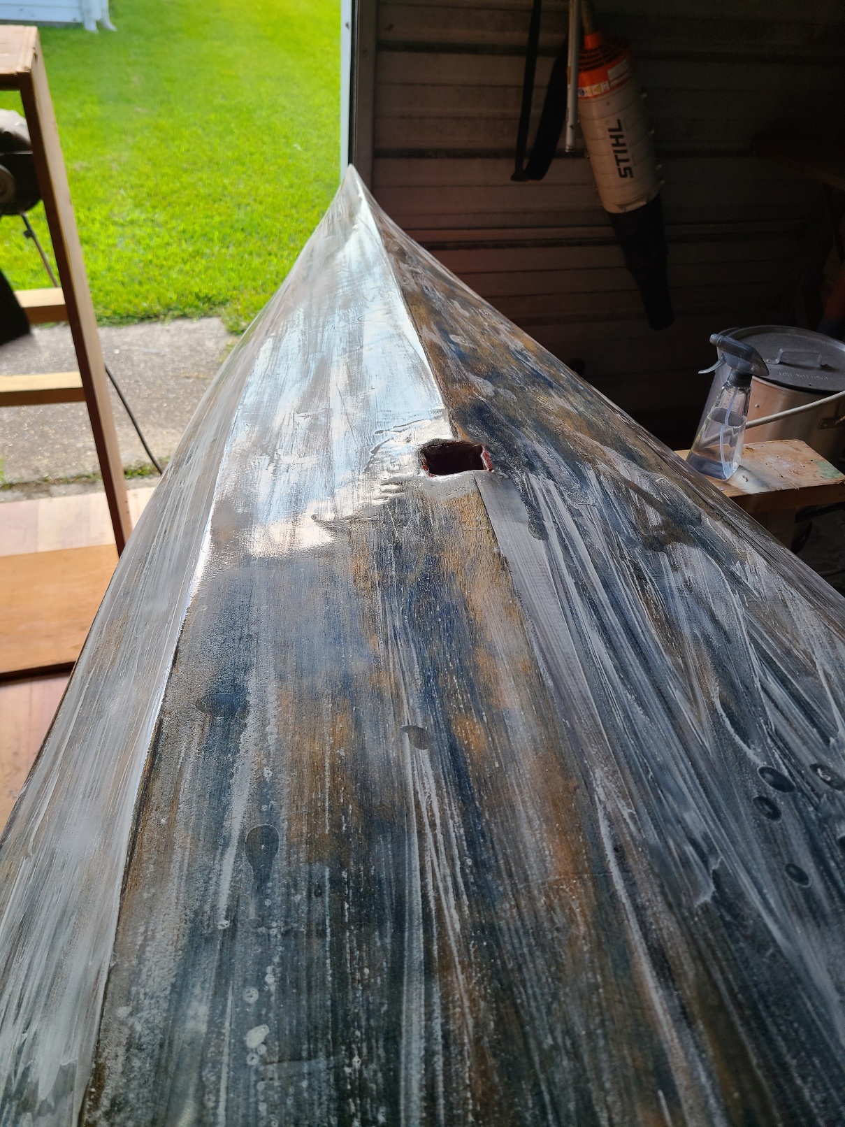

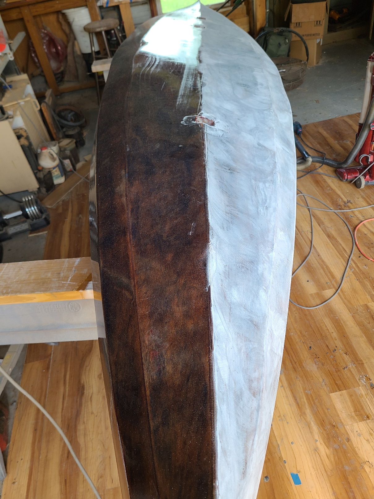

Taking the pretty shine off...
After the required amount of coating with epoxy it was time to start the smoothing and fairing. Once again, not perfect. I was able to find the high and low spots in the hull with all the hand rubbing and wiping. Tried wet sanding for a time but that was a mess. Sander hooked to an old vacuum worked well though.

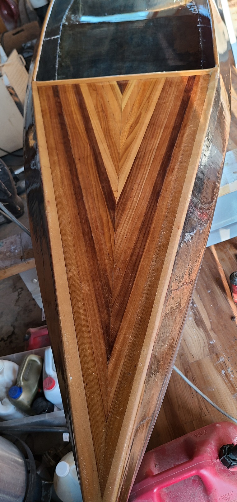

Since you fellas have been doing this far longer than I have you know how boring and tedious the back and forth between sanding and epoxy application is. We'll after all that came 4 our 5 coats of Captains spar varnish, which equals more sanding in between coats, though to be fair only light sanding. The Captains varnish went on well and only featured minimal sanding between coats. Other than that I installed some minor components like footrests and rod holder's. This is how she looks.

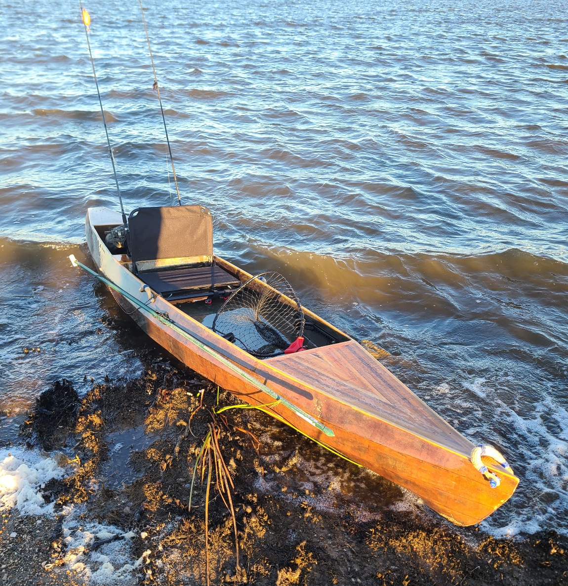

First fishing trip was yesterday to Cypremort Point State Park. The winds were SUPPOSED to be between 11-14 mph, by 10:30 they were at 18. Another guy in a Hobie was struggling to peddle off that beach. Coming in at 2pm was interesting for a new guy like me. However, the boat road the waves well and I never felt uncomfortable, except for sitting for hours on end fishing. Sorry, no slime yet, but not for lack of trying. She ended up weighing in at 50-52 lbs without seats and gear. Went light on gear 2 poles, net, stake out pole, 1 Plano box, no live bait(what the people that did catch caught on).

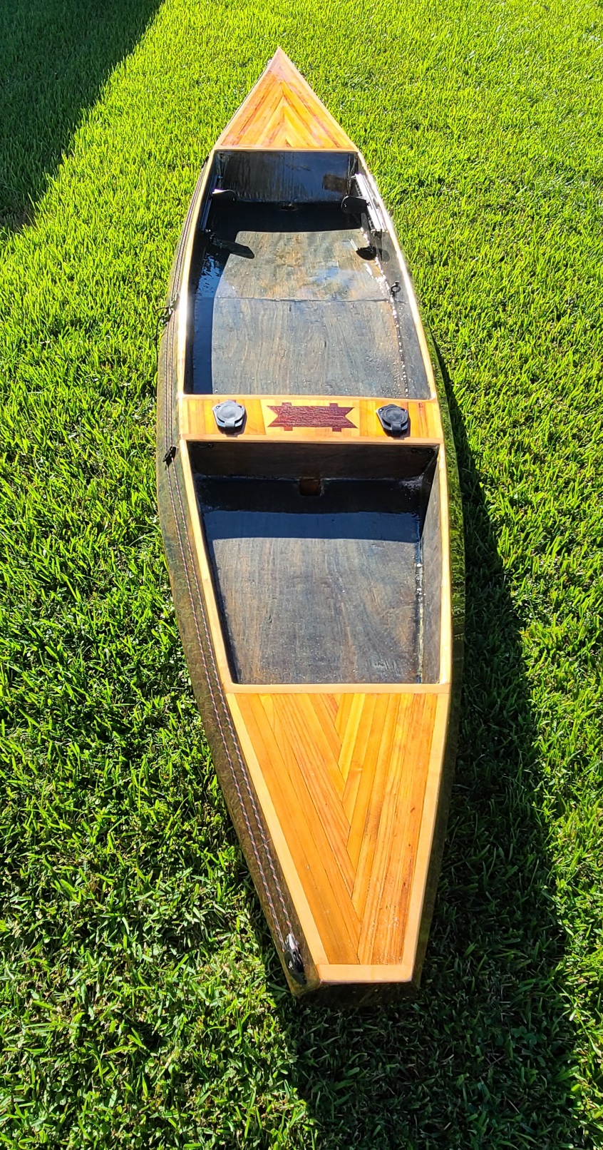

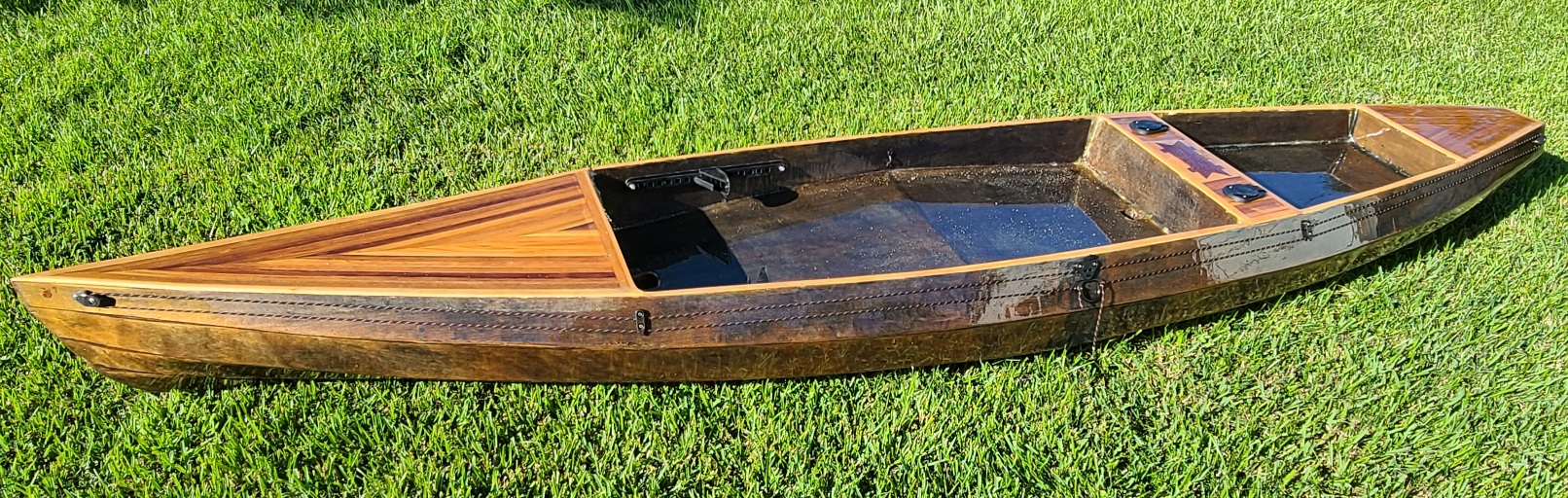

For those who are interested, she is no Nick Schade built boat, but she is really easy to paddle, tracks straight, which surprised me despite the imperfections. The scuppers were a pain and leaked at first. I re-applied epoxy with fillet material to keep it from running out and onto the floor. Worked great after that. I have custom made handles on the sides and front, part of what took so long. I had to learn the knots, then how to make my own rope, etc. Would definitely have been easier to buy a Tupperware boat, but easy is boring.
I like the looks of the work you did. I’m interested in the convex bottom. Why is the bottom shaped like that? Seems like it would add to drag?
What are you seeing? I thought it is a shallow V bottom. Why would that add to the drag?
In one picture, it looks like a flst bottom, but witt a pair of panelstipped upwards going crossways. It puts a crossways ridge across the middle of the bottom? In the two pictures dated 20210924, the left hand shot.
Probably a trick of the light?
Ok. If I'm looking at the same picture of the bottom, I took that to be a fiberglass butt joint. I think the design is "sit on top" and the floor may have a false bottom and that is stepped. I don't know for sure, just a guess.
3rdcoastkayak
Mar 8, 2020
38
50
Abbeville, Louisiana
That is considered the "cockpit". Angles that way for drainage with a scupper to either side of the ridge. It has support structure underneath and is not the bottom of the boat. Sorry for any confusion.
