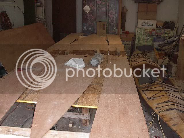

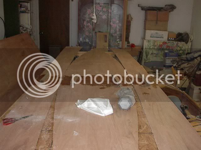

I got a little done on boat and tried couple things different.
I went ahead and sliced the full sheets together before I started marking that worked alright.
I laid out and cut the two sides and bottom and the put a couple temporary braces on the back side so I could handle them better

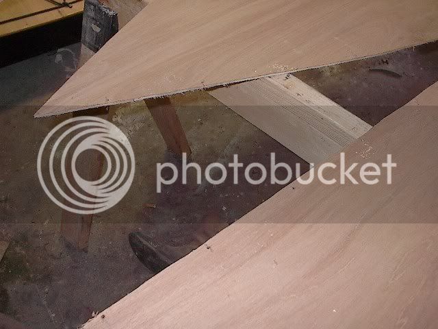

better pic
Started drilling holes for zip ties
Well is raining so I am crunched up in garage again but is better than working
More later

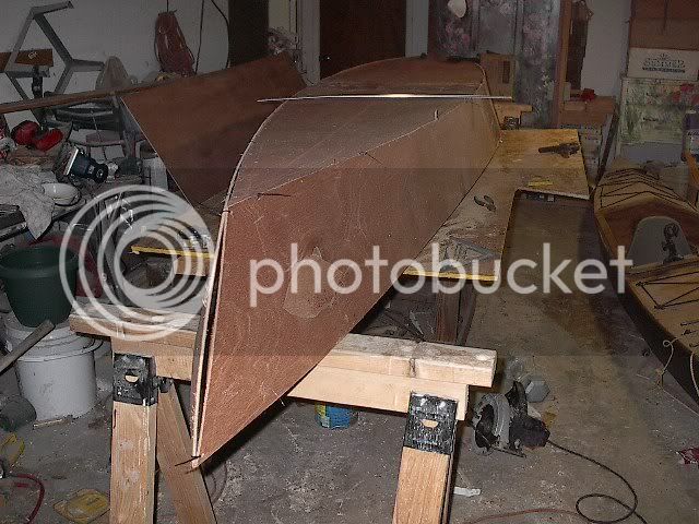

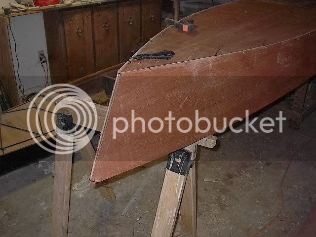

I got a little more done on the peerow

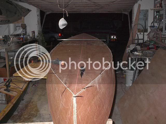

Heres shot of angle of rear of the boat
and a pic of the shape of the hull

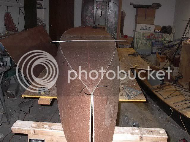

Now the same shots of the front
hull shape in front
if you compare them you can see where its a whole lot wider in rear
swede form I hope.
The reason for the zip ties everything is loose so I can adjust sides to get the rocker I want on front and rear Hopefully 1inch to an
1 1/4 after I get all that like I want I will decide if I am going to do the tumblehome.

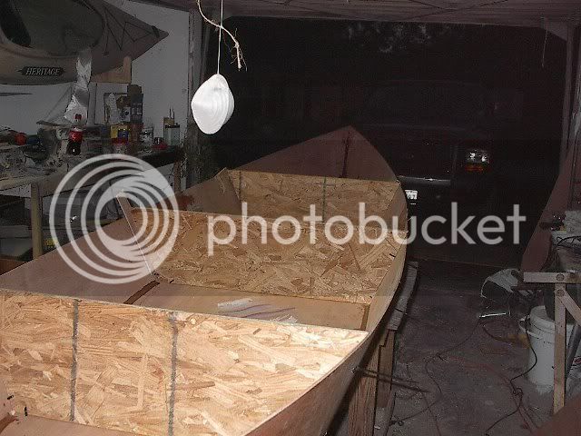

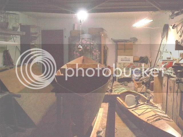

made some progress today
I got the bottom glued flipped it over finished setting my rocker.
It came out pretty close to what i wanted front is 1 1/4
Rear is 1 1/2
The widest part on bottom is 28 1/2 inches top 36 1/2
that will change when I put on the tumblehomes

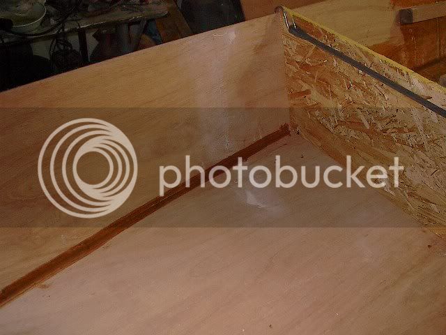

Got the inside fillets done
With side braces it would look pretty good right now
I am having a ball playing with this hull
more tomorrow.
