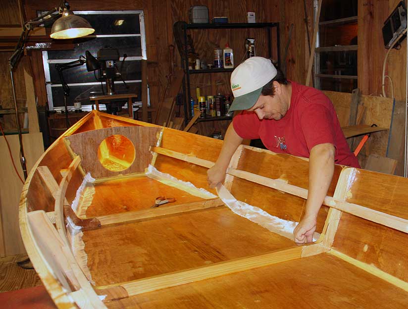

Uncle John added some more pictures of the guys glassed and epoxy graphited on the bottom , gives you an slight idea of the size of the skiff.
http://unclejohns.com/bysk14/
Uncle John posted some more pictures , they are of his guys glassing the inside seams of the boat and it gives me a good idea of the boat.
I asked John if it was going to stay the natural wood and he said they are thinking of painting it. I'm looking forward to seeing the completed boat.

Received this email from Uncle John........ As normal you can click on the pictures to enlarge them and I think they answer a lot of questions anyone might have.
Put her in the water today, paddled, rowed and sank. I've added a few photos to http://www.unclejohns.com/bysk14 Everything exceeds my expatiations. Amazingly stable, paddled great even with the runners. I have over 500 photos to sort through but wanted to throw a few on my page for all to see and to answer the capacity question. I think you'll like my T-shirt. Selected it just for you!

If you take a good look at the 1st picture with the three of them in the skiff ( enlarge it so you can see better) The water does not cover the graphite strip on the side which is about 2 or 2 1/2 inches up the side. This is going to be one shallow water boat.
As I told Uncle John in a email .... with some oar locks in front of the third or middle seat a person in the boat can row looking forward and with some behind the middle seat , then turn around while looking back to row all the time balancing the boat out.
With a 2nd person in there he can be in the back seat and row looking forward with that arraignment of oar locks in the boat , an ideal way to go down river fishing. Or just use a canoe paddle with two guys for drift fishing.
Have the rear set of oar locks about where the guy in the back ( Jason ) has has paddle across the skiff.
It will not enlarge on here ... go to http://www.unclejohns.com/bysk14 to see the enlargement.
