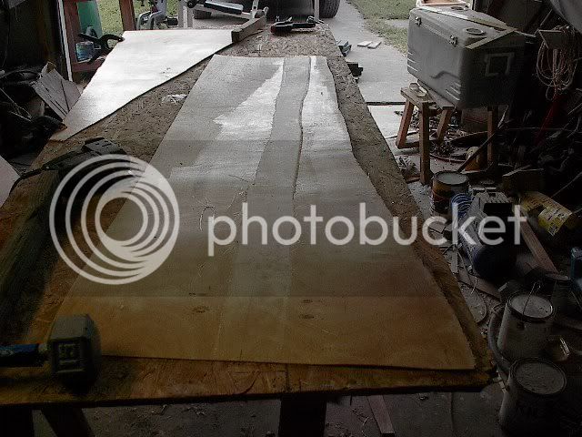

Wood cutting begins tomorrow. well got 4 stations cut today.

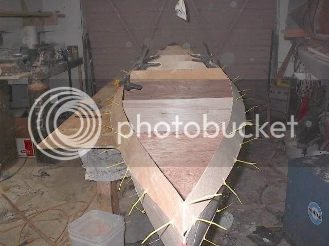

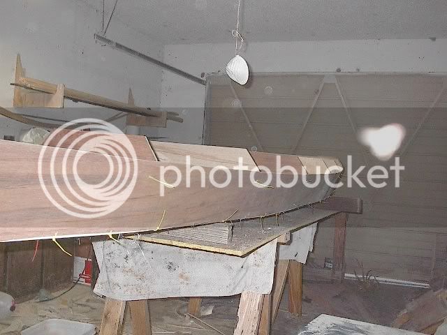

Have been playing with the tv its starting to look like a boat
got the tumble homes stitched on
Its coming right along

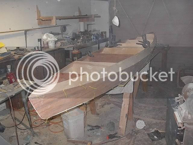

I am counting 8 temp hull frames in there. :shock: :D Should keep all your seams nice and true.

The 8 temp frames are JHagers and Matts Ideal it sure helps with the thin ply and Mick I think this may be the ultimate boat for me the right hull shape v bottom 15 ft long long water line 24 inches wide. If I was a betting man I would lay money down it will performe right with or better than the Laker. Got a couple ideals on carrying my gear and storage in this boat.

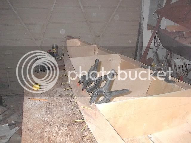

Yep, there's a lots-o-frames. But that was a request to help tame 3mm ply from flopping around.

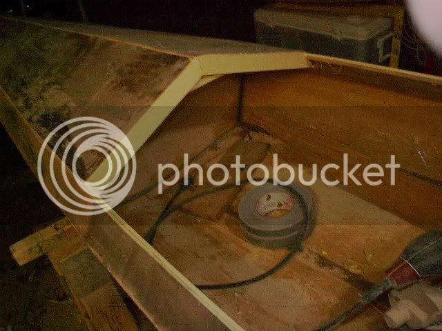

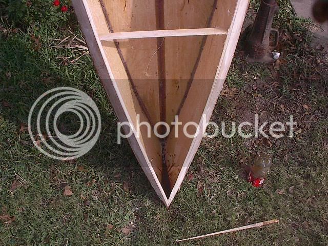

bulkheads in filets run and inside glassed

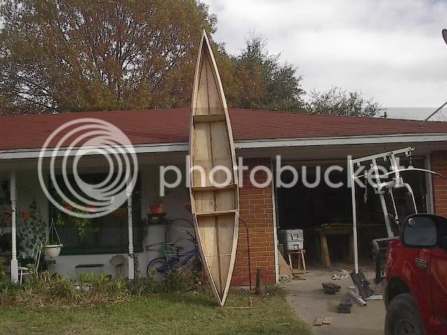

end pours done I had to stand this one since it had the tumble homes installed dang its tall
shear strips glued in

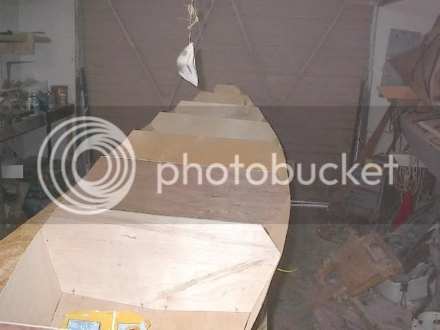

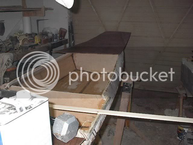

cut the rear deck and installing it
I went with a flat rear deck

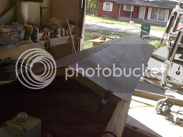

Ok here we go

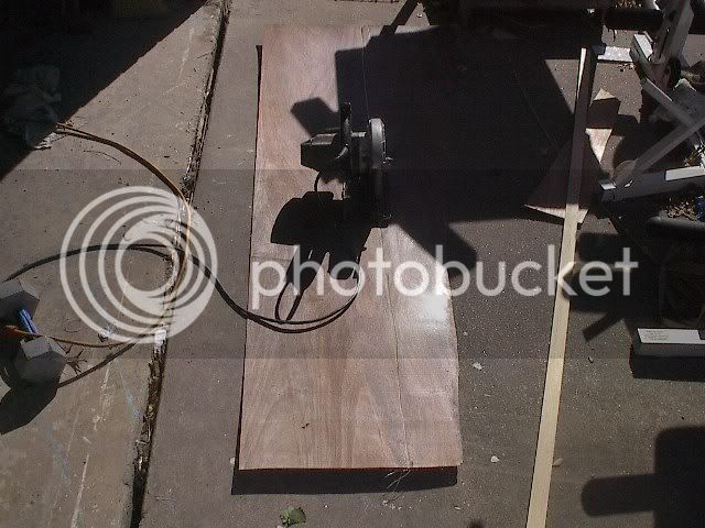

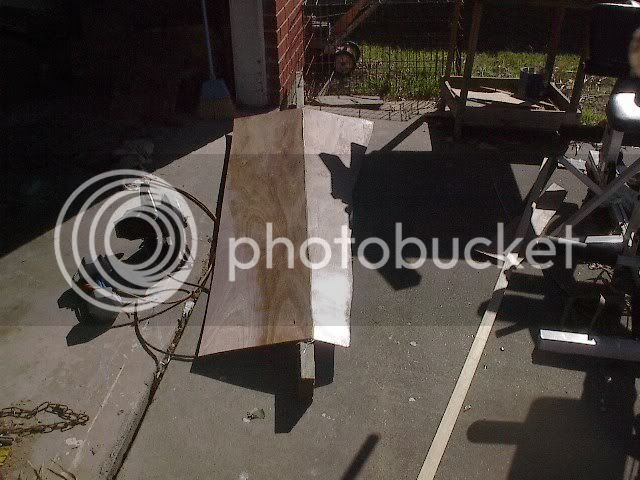

I tried something on my front deck and it seems to be working ok
glassed the back side of my deck put 4 inch strip of clothe down the center line.
then I turned it over ran a saturation coat on the side(the top side)
then drew a line down the center making sure I was in the center of the tape on the other side
I set my skill saw to cut 3/4 way threw the 1/8 ply ( I free handed it should of used a straight edge) but it worked ok
then I got a 2=4 placed it under it and pushed down
Wala a good straight edge in the 1/8 ply no waves
put on top of yak marked then sanded it to shape
Saves a lot of time good straight line and the cloth on the back side works as a hinge to hold everything just right and when you bend it open lets you glass all the way back through to the tape.

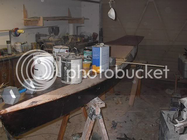

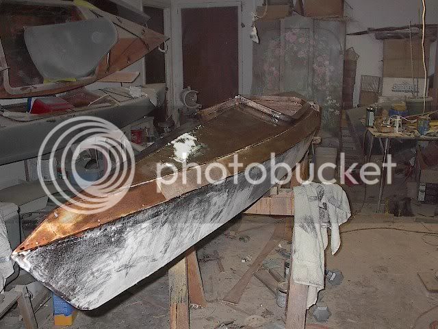

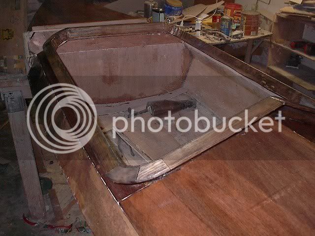

Boat is starting to shape up
got the front deck on

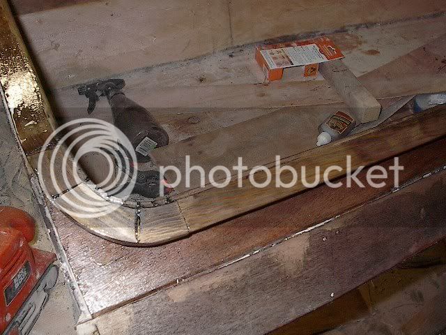

got the combing installed
got a little glass on the nose
The more I work on this boat the more I like it bet it is going to be in low fortys in weight to.
