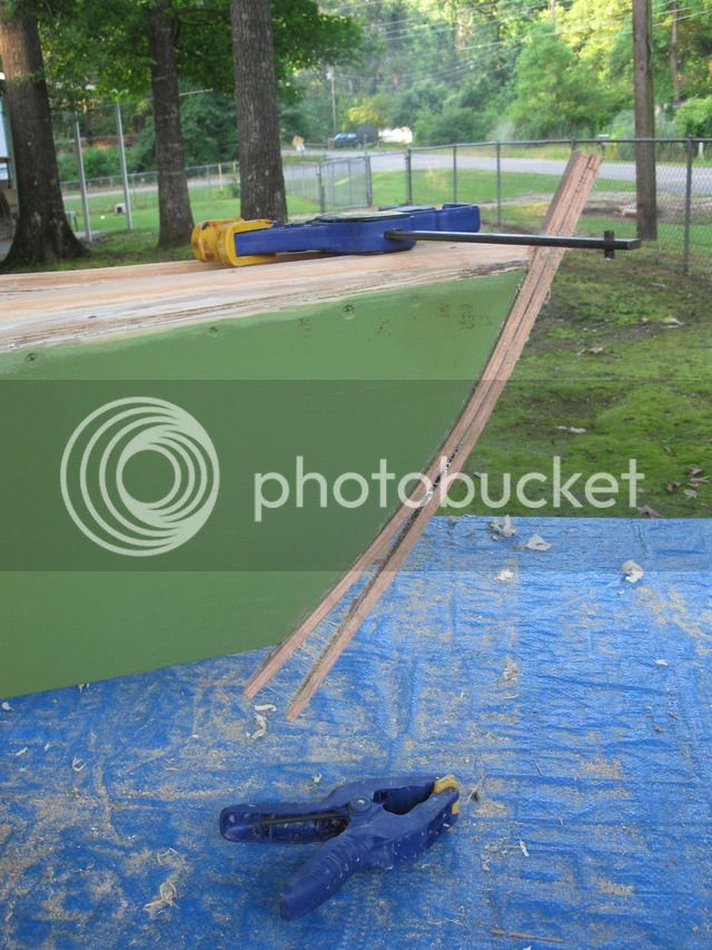

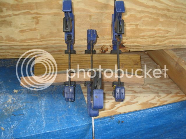

I use two 1/4" thick white oak strips laminated together to make each batter board. The first strip is screwed to the stem piece leaving it long at the top and bottom. This allows the second strip to be clamped and glued to it. After shaping, the excess can be sawed flush. The strips are hard to bend so I pre stress them to make for a better fit and less strain on the screws and glue. Soaking them would help but I wanted them to be completly dry before installing. Steam bending them would also work.
I made a form by tracing the shape of the stem onto a 2X4 and cutting it out on the band saw. I then clamped two strips onto the form and left them overnight.
When released they returned to almost straight, but seemed not as stiff. After clamping the other two overnight I then clamped all four together. Before doing two at a time overnight it was much, much harder to bend all four together.
They will stay this way until I'm ready to install them. They should be "warped" enough to make bending and fitting easier

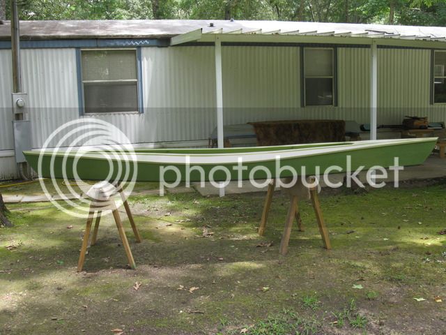

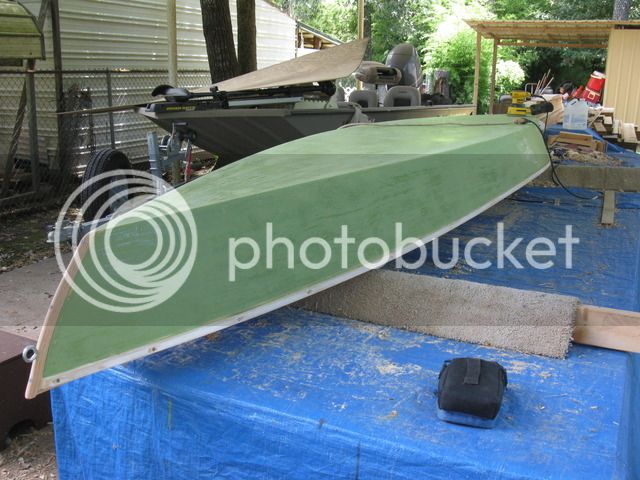

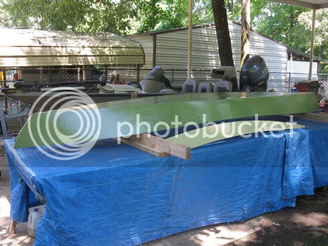

Probably getting ahead of myself, but I spread some paint before completing all of the assembly. I thought it might be easier now rather
than later when it will be hard to reach some places. Last picture for a while time to get back to work. If the fish aren't biting. :)

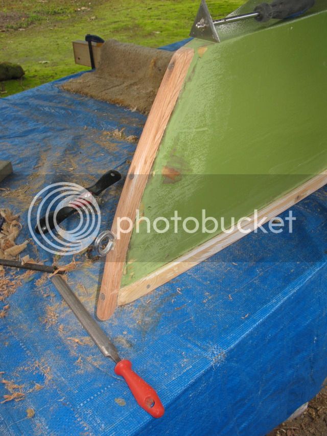

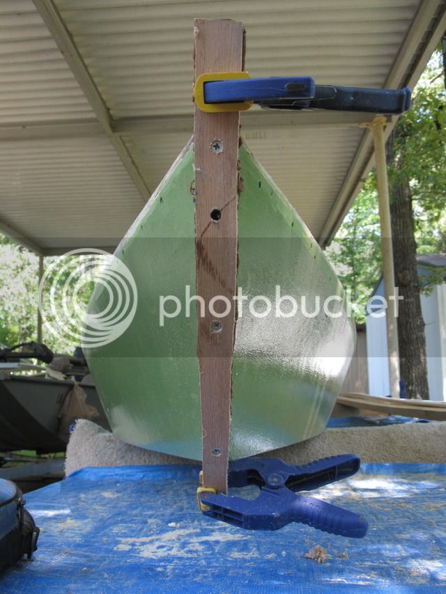

Thanks, I like them also but they are more work. On this boat they led to "lots" more work for me.
I attempted to attached the batter boards with construction glue because in the past I had problems with other glue on the stressed white oak strips.
It did not hold so I fastened them with screws. What I should have done to start with.

The rest of the story, short version:
Finishing and fitting the stems scratched the paint and they needed painting also, so the boat had to be sanded and repainted. The bottom had to be painted with the graphite so it was not much extra work.

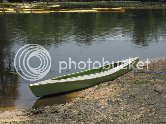

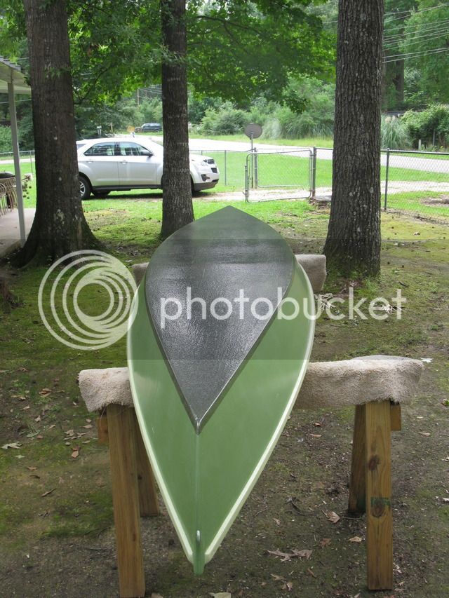

For the bottom protection I used a product I found at Academy Sports. It is "Goop" Coat It and contains epoxy, graphite, and ceramic powder. It went on easy, finished smooth, appears to be very hard and slippery.
Long story, short, It is finished and I even got it wet a little, but no fish slime :cry: yet.

The can (2lb. kit) said "up to 20sq. ft. I used a cheap foam roller and it took all to cover the pirogue bottom, about 14sq. ft. give or take.
A quality finish foam roller would probably stretch it some. An 8lb. kit is also available.
The finish seems harder than the standard epoxy/graphite mix I used before. The graphite does not seem to rub off as much and it only required one coat for a fair finish. The boat paddled well with little friction. I also waxed the hull with a boat polish containing Teflon.
It made for a slick finish over the epoxy paint and the graphite bottom, and added some UV protection. Seemed to help with washing the crud off.

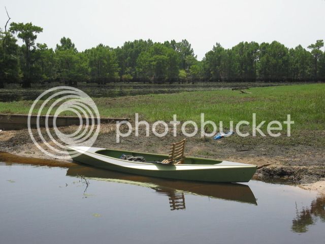

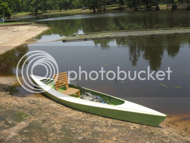

Joey I have not weighed it. It feels heavier than truck boat #I. As you know it takes a lot of attention to a lot of details to build light and still have a serviceable boat. Choice of wood and the size of the boat are probably biggest considerations. This was a learning project about form and some design changes. Smaller breasthooks/decks and a lighter framing wood would have helped a lot. They turned out larger than my original plans(thoughts, actually) because after changing the way I built them I could not reduce them. Could have used WRC instead of the cut off bargain ben pine boards but I did not want to invest any more into it. It may just be my perception that it is heavier because it does not rest on my shoulder as comfortably as the other boat. The first boat has a wider combing and carries better. My be a design change consideration for the next time.
The boat fishes very well. The only issue I had was it gliding past my target area. The fair and very smooth wetted area seems to make a difference.
