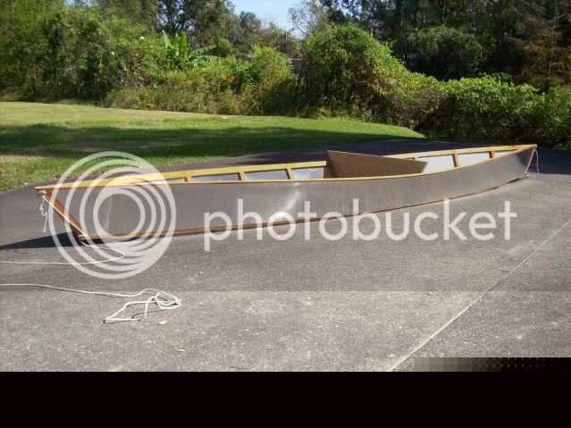

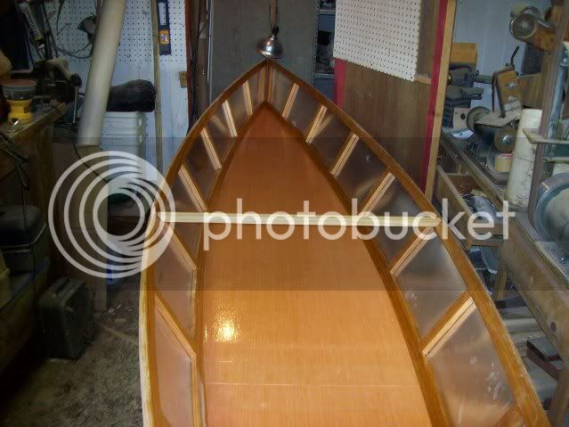

I leveled the chines and attached the bottom with thickened epoxy. Tomorrow morning I'll fillet the inner and outer stems and maybe epoxy saturate the bottom. Man, I'm liking this old school boat building again. Got to use a plane, a hammer and NAILS! 8)
This morning the epoxy was set up enough to trim the bottom down to meet the sides. Rolled on some epoxy on the inside bottom, turned it over and epoxied the outside bottom.
Before the last round of epoxy it weighed right at 20 lbs + or - . She's two inches wider and the rails are of a bit thicker stock than originally designed.
Looking even more like a boat now.

I've been thinking throughout this build how easy it would be to punch a hole in that thin aluminum. I wonder if adding an inside layer of aluminum on the sides would be a good idea? I know it could hold moisture and cause rot problems, but sinking because of a hole would be a bad thing, too. It shouldn't add much weight, either. Just a thought.
Mike, it IS some thin stuff. Yes, there's a chance that something could punch a hole in it....same as a SOF boat. The price you pay for light weight. I plan on carrying some duct tape for emergency repairs..... maybe some of that two part epoxy putty for a more permanent fix. I don't plan on going 6 miles out away from shore in this puppy. :wink: She's going to be a pond hopper and a protected water fishing craft for the slow moving bayous here.

John, Oh yee of little faith, I used advanced scientific geometric algorithms (or is that logorithms)and reflectivity data to ascertain the the optimal refractive angles so this "binding" condition would not occur. ..........Nah, I just nailed 'er up and let 'er rip. :lol: Hope it keeps the gators away, though.

The boat looks great, very sharp! Joey, What do you think of the revolution ply (strong enough?) What weight cloth did you use or just resin? TIA. James
JP, no cloth yet. I'll probably put a little cloth on the stems, on the bottom at the stems and maybe a piece near the middle where I sit. The Revolution ply is about as delicate in it's natural state as luan. Easy to snap a small piece with your hands.
This project is a "what can I get away with" type of build. One thing I discovered is that Western Red Cedar saves weight in the chines,stems and gunnels and appears to have more than enough strength for that.
