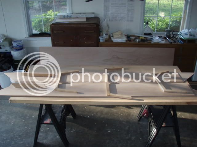

Re the stems, I thought there was too much angle also. There isn't. It all comes together really nice once you put the sides together and then spread them with the frames. 45 degrees is fine but if you would like a little steeper stem that is also fine. It is your boat mate, build it the way you like it.
I am not sure what you mean but it is critical that the sides are identical in length and height. It is also very important that the sides are level with eachother when you stick the stem pieces and frames in place. (no twist)
Matt has some very good tips on how to achieve this in the tips and tricks section of his Jem Watercraft site here -

It depends on the size of the sideboards , The end pieces are at a predetermined length so if the sides are less then that length , cut off the part of the ends that are sticking up , or round them off. If they are lower then the area needs to have a short deck put over them.
Most of the pirogues I make I have to trim off a small part of the bow and stern pieces.
The ends of the sideboards are at a 45 degree angle , that is what helps to give the desired amount of rocker to the boat.

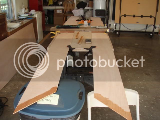

Got it chuck and Hairy! I just wanted to get things rollin in the right direction before I started cutting. I also just want to make sure, You coat the area you are going to glue with epoxy first and let it cure then you can go ahead and glue up? Also I have been reading other posts and found one that said not to use a hardwood ply. :( Welllll.... I already purchased and ripped 2 sheets of oak vaneered plywood! It had a nicer finish on it and thought it would make for a great looking boat. I never read before TODAY anywhere that you should not use hardwood so now what? I really don't want to start over and buy more wood.

Putting the side boards together using a butt joint , coat the area with some epoxy to get it into the wood , then when it has set up put the joints together , cover then with a piece of fiberglass and epoxy it.
Make sure there is some plastic under and over the joint so you don't epoxy it to your work table. Something over the top to make sure it stays down and does not move is necessary , a little weight not a lot.
When attaching the ends , same thing epoxy then put into place and secure them. Filleting the bottom and side , epoxy saturate out a couple of inches , let it set then you can put down some masking tape to set the edge of the fillets , when the fillet is almost cured ... pull the tape and you will have a nice straight , crisp edge to the fillet.
The idea is that the epoxy seals the wood so when you pull the tape you don't pull any wood with it.

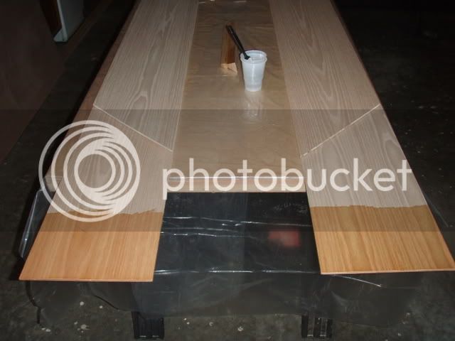

Thanks guy's I am sort of a neat freak but not to bad. I did glass the inside of the sideboards today. Can I use two layers of 3.25 cloth on the inside of the seam instead of the 1/8 th inch ply? (butt joint of course)

When I make my boats if I am going to glass them inside and outside then I do not glass tape the seams . They will be glassed on both side when the boat is glassed.
I give them a good fillet on the inside to make a rounded area for the glass to lay over ( it hates 90 degree bends) and the fillet also helps in case I round off the outside to much.
For extra insurance tape the outside of the seams , that is where most of the wear and tear is done to the boat when landing or taking off for the day. Extra glass on the seams does not hurt a darn thing.:D
I thought you were talking about when the bottom is attached to the side boards ... SORRY ......
The glass I use over the butt joints is 3.25 or what ever I have here. When both sides are done it will be solid , single application of glass per side.
