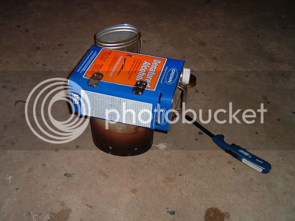

In real ruff prototype version, here it is:
It is sitting on my Danish Army (Swedish army??) Svea stove.

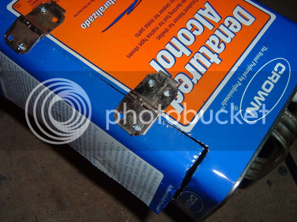

Here is a better shot of the hinges, just single screwed for now. I need to find my pop rivet tool and put them on tight. I pinched the hinges off an old guitar case. I'll probably make a little wire lift handle on the door, too.

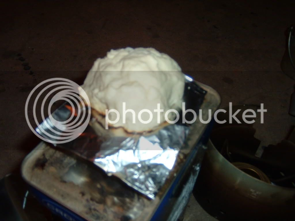

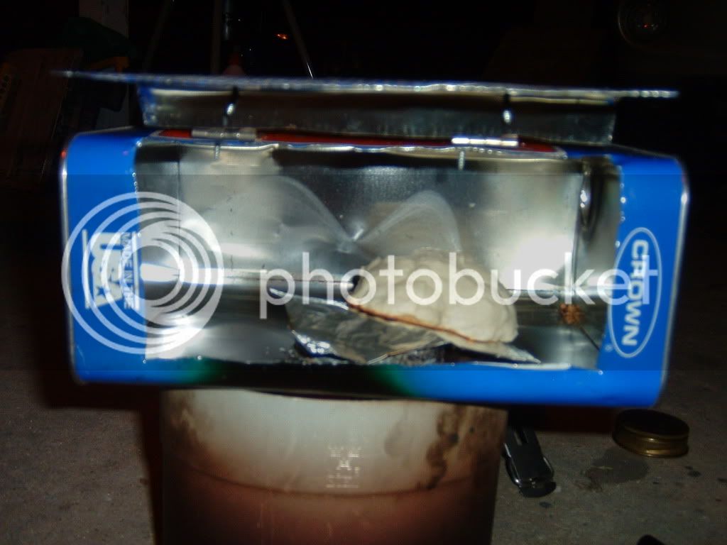

Here is a sort of tilted biscuit, baking on a folded up chunk of foil. I'll make a wire or tin rack, about 1/3 of the cavity height off the bottom.
I just started it with a little fuel in the Trangia, so the biscuit got warm and firmed up, but didn't bake through. I need ot run the whole unit REAL HOT for a while and burn off the labels, etc.
Looking forward to English Muffin Pizza on a paddling trip.
Ovens have hot air circulating through them. Consider some holes to let in heat, and some vent holes to release it. A short piece of corrugated sheet aluminum Could be good for a rack. Or, some holes pierced through and wires stuck across?
I think you're doing a nice job here, Poper San.
I want to make a sheet metal shelf. It could be flipped upside down for travel, thus freeing up the interior to carry other stuff. I thought about wires but they clutter up the inside if you want to store something in it. Corrogated might be stiffer for the weight but i don't have any and a simple shelf with a bent down edge should carry anything that will fit inside.
I can pull the screw cap off this can if it needs to be vented. I think the door way leaks enough right now for ventilation. Besides, a Dutch Oven makes great breads and biscuits and there is ZERO ventilation.
I'll finish the hinges, add a door-lifter and burn it hot for a while and give it go on a pair of biscuits or mini pizzas or something.
Dutch ovens are black cast iron, and cook by both conducting heat directly to the food, and radiating heat from top and bottom.
Your oven is light weight and shiny, and heated only from the bottom up. It is a container to vector flows of hot air around the food. That's why specific vents to control air flow and direct it to specific areas could boost effectiveness. It will also radiate heat around the inside like a reflector oven.
