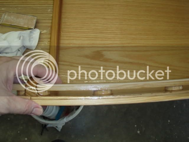

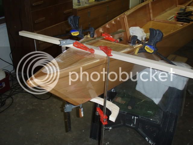

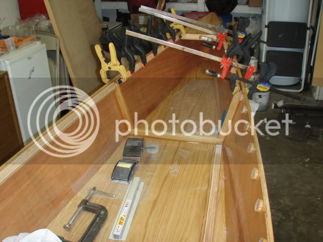

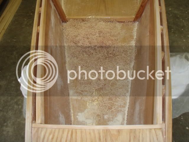

Got her close to done. I have glued in the decks and all the inwales then made lots of shavings with the surform getting them shaped. Now i'm in the process of sanding and filling any gaps and then more sanding. but I can see the build part coming to an end. I still need to grafite the bottom fit and glue the grab bars in and finish my seat and after a good month put on the Z-spar varnish I got from RAKA. But it won't be long till all the detail work is done and I can get her wet then rig her up the way I want to use her! Until next time my friends.
gluing in the decks and inwales
shaping the inwales
closer detail shot
Hey Jack, the sides are considerably stronger after gluing all the pieces in and if I do this again I am going to just cut a notch in the ribs like you suggested. It's all good. :wink:
That is one Sweet looking pirogue , I really like your idea of the wood doweling as spacers , that is sharp.
We are always learning from folks building boats , everyone comes up with good ideas that benefits all of us. This keeps up I will have to build another and use everyones ideas in the build so when I look at a part of the boat it will remind me of that person.
Guess you could call it a boat of many personalities and ideas. :D

I thought the round disc spacers would serve a dual purpose! save some weight and being round nothing for the ropes to catch or drag on. Also leaves more space in between for dumping water. Every now and then I even suprise myself

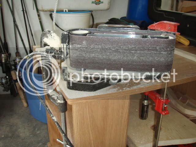

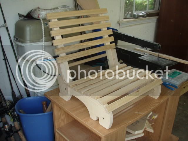

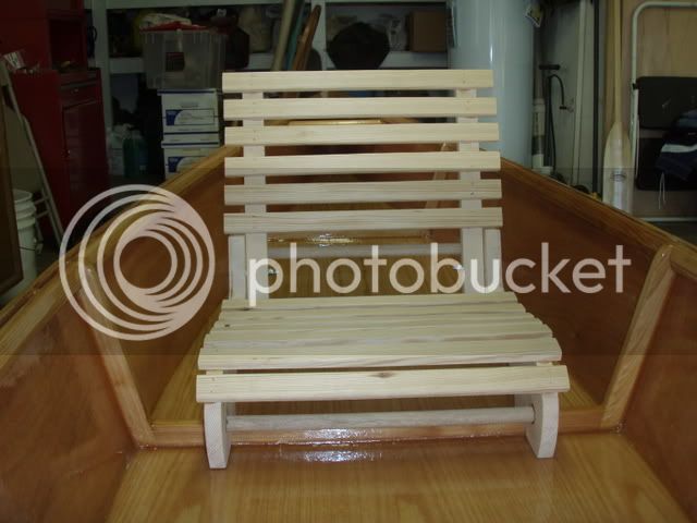

Ok guy's this build is winding down now! :cry: :lol: I am all but done and will post finale pics and maiden voyage as soon as I get them. For now these are of the very well designed and sturdy chair for the pirogue that The Chuckmiester and UJ supplied us with. All it needs is a finish sand and some protection. I also thought I would share this with all of you incase you have not tried this or your like me and don't own a real disc or belt sander. I just clamped my belt sander to the bench and it made quick work of sanding and shaping parts for the chair and the boat.

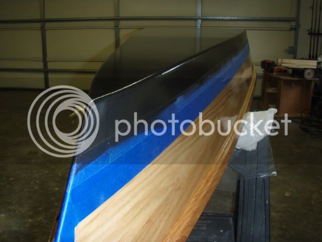

The rest are of the three coats of grafite going on and the last time i'll see the bottom wood an the boat.

I have to ask , Where do you work on your pirogue , out in the driveway and then take it in the shop for the pictures? That shop is just to clean.
I sure hope you like your boat and refuse to think about you not liking it , that would put all of us in some deep do-do. Just in case the negative happens and if Bear walks into your restaurant ( like he said he might do) remember it was all his idea. :p
If you are happy with it then it was everyone else's idea. Now if you want to I would be more then willing to give you $20.00 of Kayak Jacks money (it is some old , collectors, currency from the 1800's ) for the pirogue to keep you from having to make that decision. :roll:
Seriously when you get her wet how about providing some pictures for us in the Boat Bragging Section and I am sure Uncle John would like some for his web site , if that glare off of the shine you have on it does not blind him.
