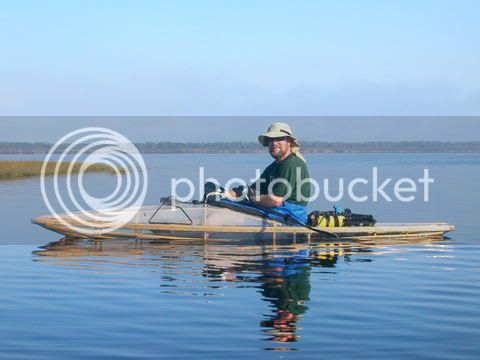

Well finally found the perfect build lighter than 3mm ply no epoxy or
polyester resin good clear finish so the wood grain can show thru
draws a lot of attention from above and below (ouch) no delaminating
very cheap to build.
This boat is built of plastic sheets like you put under concrete slab and are paddled and fished of off Florida keys
Different strokes for different folks
You can't build no bad boat.
13,798
136
83

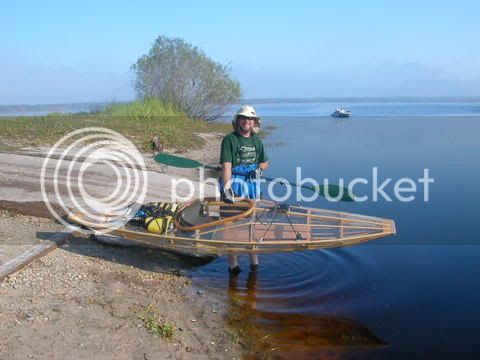

Notice that he launched from a muddy bankwithout stones or rocks, and that he set the boat into the water - NOT on the bank.
With no flotation in the boat, one pinhole and he's going down. I wouldn't get more than 15' - 20' off shore with that boat, and not in anything deeper than my knees.
I would not let anyone that I liked use that boat.
