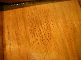

I have built a few boats with the cheap stuff and all of them have turned out to be better than OK.
My Laker is a case in point. I built this boat using what was left of a bunch of ten sheets of 3mm interior ply. In other words, the ply I used on the Laker was the stuff I had rejected for other builds.
There were voids, warps and serious delamination in this stuff in places but it what I had on hand at the time, so it is what I used.
Here is how I fixed the delamination. - Lots of 1/16th holes in the veneers on the delaminated side, saturated with epoxy and worked into the timber and delamination gap.
I used my reject ply on this build, specifically to see if it could be done successfully using the worst imaginable ply. I wouldn't recommend anybody do this and I would never do it again. Simply because, while I am satisfied with the end result, working with the poor quality ply is just too much like hard work.
