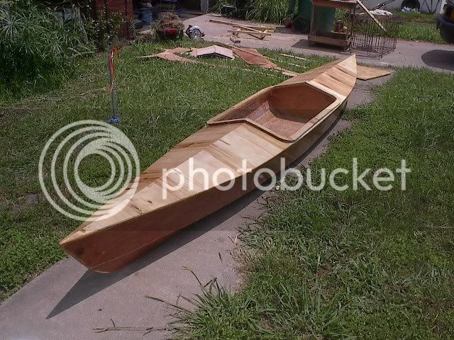

Oh here is one for Swampwood of a luan deck
You can see there are some interesting things come out of luan.
