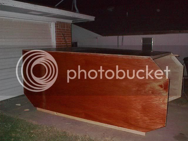

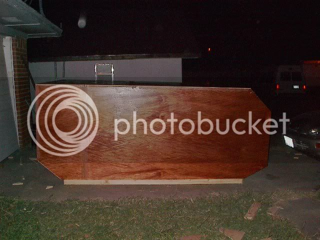

I got outside seams taped and glassed.
Then put a saturation coat on.
Thats all folks
Dang wood looks good natural

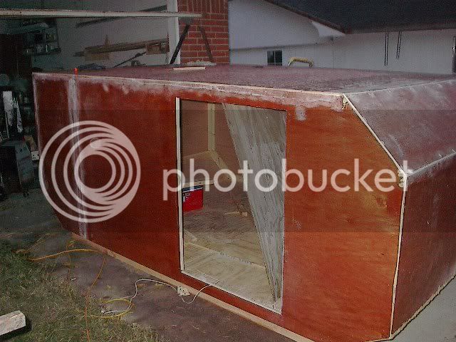

We got the door cut . :lol:
Coyote and I are both pretty good size ole rednecks so we enlarged the door to 30 inches wide.
Started sanding and filling in screw holes.
It was raining on and off all day so we didn't get to much done today.

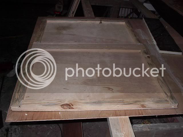

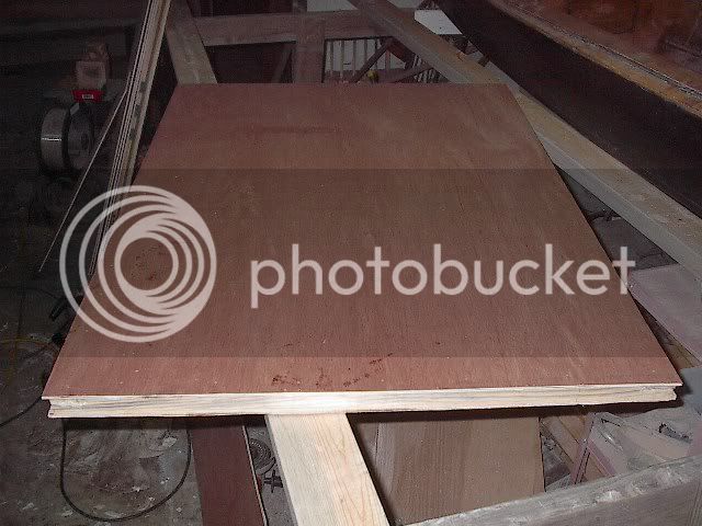

A little more sanding and then started work on the door. I got it cut out fit and glued and then put on the outside skin.

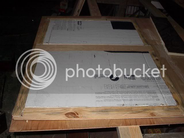

cut and glued in the insulation
The glued and nailed the inside skin on
Tomorrow I will sand the edges then mount in the trailer.

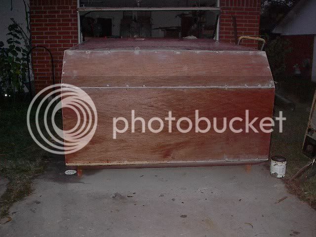

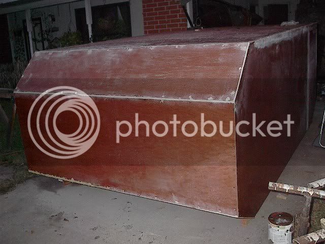

The Trailer is built so I can sit up on the bed with some head room and bend over and walk around, It is a glorified tent ,but no setup time , warm and cool dry and no wind drag .
The more I work on it the better I like it.
