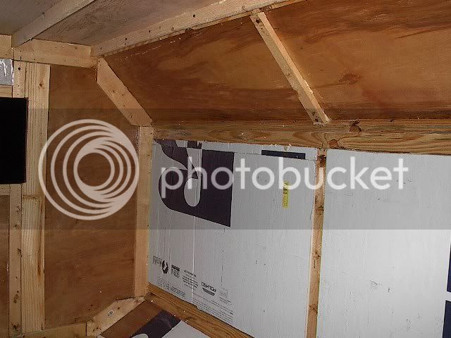

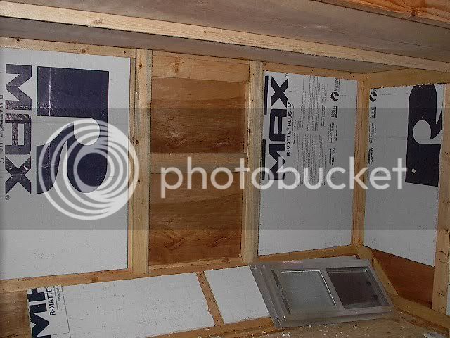

Coyote and I finished coating the walls and uprights with poly, after it dried started cutting and installing the foam insulation.
You can see in this pic the bracing for the ac in the back wall.
We ran out of foam so off to the box store tomorrow.
Ps The plan is to mount 2 batteries and an inverter should run the ac for about 12 hours , later a couple solar panels to help the generater.

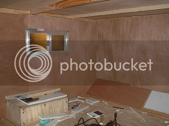

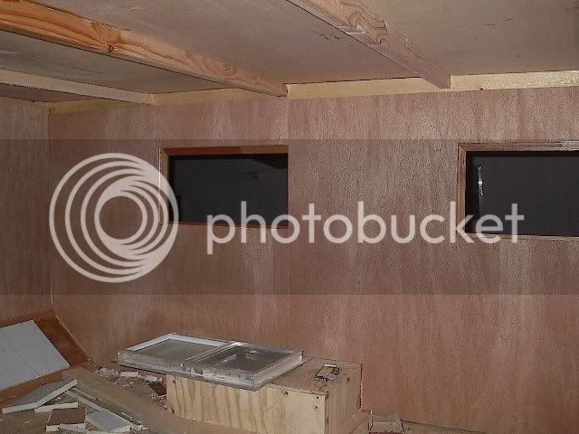

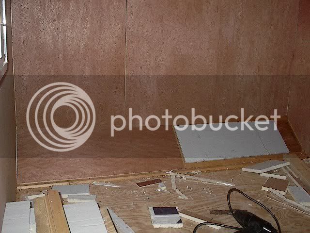

The weather eased up today so I got a little more done. All the insulation is glued on walls and most of the inside ply is up.
We decided to use the 4mm laun instead of paneling the finial finish on the inside will have to be a surprise.
you can see the off set in the back wall where the bracing for the AC is.
In about an hour tomorrow should have the inside walls covered.
