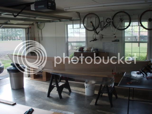

Ok Guys it's actually looking like a boat now and man I really like her shape! Can't wait to get the ribs in and move on to the bottom. I think she is gonna have a very shapely bottom indeed. Here are some pics. :D
As Jack would or likes to say. We take a couple of large pieces of wood , wake them into smaller ones , then take those and make them one piece again .... But the way we want it.
I always like the process when we make those pieces the way we want them and the end product is a ton of fun. :D
That super clean workshop still floors me , no sawdust , rubber gloves , paper towels , used containers of set up epoxy ...... It is just to clean , It is unnatural.

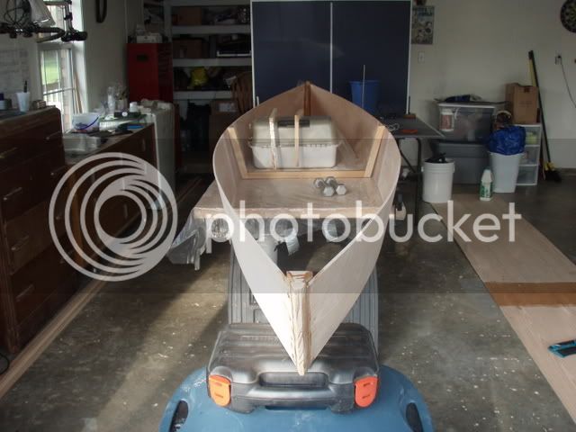

Thanks for all the encouragement fellas! I got the sideboards tied together with the stems and it just looked very sexy. I could not stop looking at her. It's like .....Dare I Say it?........... Falling in love! I am really stooked at the little pieces all becoming one nice piece. Also I got the plans in the mail today for the seat that Chuck designed and that will be my epoxy drying project.
You guys are right this could be habit forming!
P.S. Chuck, if you look in the second picture on the top of the tall dresser on the left, there is a cup with a used paint brush and epoxy in it that is set up. :lol:
But I have since thrown it out!
