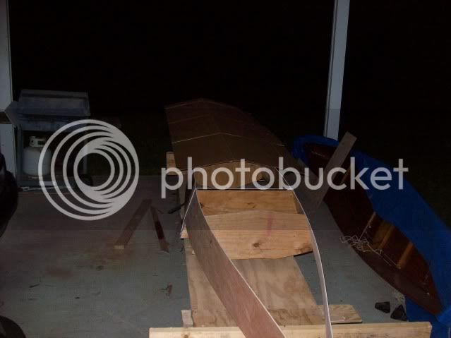

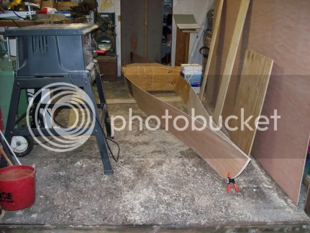

The station in front of center is stitched in. Stations one and four are next and then the bottom.
This is where she'll go when the weather turns bad. Snug fit.

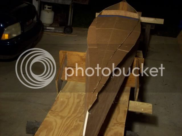

All stations are wired in. I might need to do a little tweaking but I'm liking the shape. Started fitting the bottom panels. Using cardboard to get close to the finished shape. The procedure is closer to Ron's than to Matt's. Makes it interesting, huh Ron. :lol:
I'm not sure how the ply will lay over that gradual curve from the center forward. If necessary, I'll cut a bit of clearance where the two panels meet. I also haven't glued the bow and stern together yet, so that will give me a little leeway to fit the bottom in.

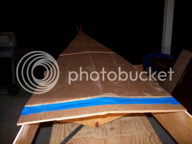

Making a bit o' progress. The rough patterns are cut for the bottom panels. They need to be trued up and used to draw and cut the bottom from the second sheet of ply. I put one on top of the other and it really shows the asymmetry.
I have to work most of the weekend, but should be able to cut out and start to fit the bottom panels.
