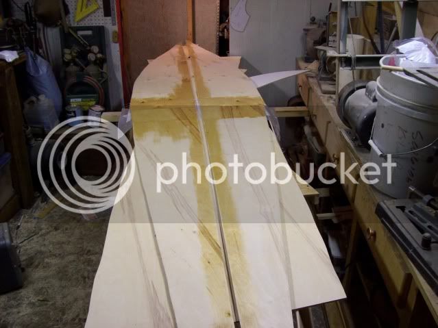

A little slow going lately. I've had only one full day off since I started this build. I used up most of that day getting the side profile shape and rocker the way I wanted it. It's been cold and rainy off and on, so I moved into my small shop and set up a heater. A full two inches to spare on each end. :roll: Applied the last fiberglass patch to the bottom panels.
I'm really liking this slow epoxy hardener. Gives me plenty of time to touch up needed spots without feeling rushed.

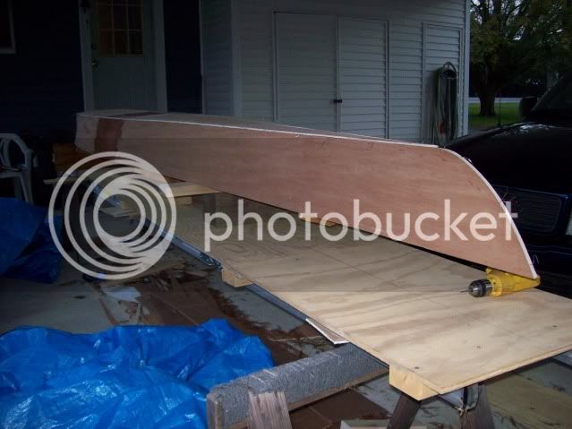

You would know, the first day off in 2 weeks and it rained all morning. I hustled the bottom panels onto my workbench in between downpours. I drilled and wired the panels together and did a trial fit. A bit oversized but I'll trim to fit.
The shape is starting to come out. I'm a happy builder so far. :D

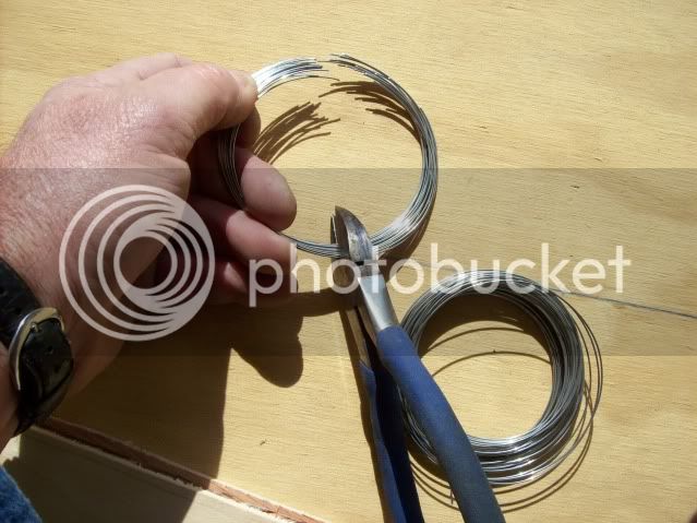

I'm sure some of you have discovered this tip but I'll pass it on anyway. You need a lot of wires and this is an easy way to cut them in bulk.
Just so happens the wire was rolled to the right diameter. A couple of snips and then bend them out straight while there still all together. 8)
I very carefully measure my wire to the nearest 0.001" with a micrometer, mark it with chalk, and cut it with an axe.
Seriously, I use el-cheapo stove pipe wire. When I bend into a "U" shape for use, I bend it with one end a tad longer than the other. Seems to insert and handle a bit easier for me.

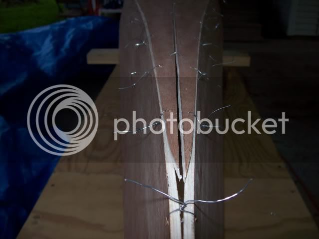

The Swamper is all wired up. She really looks like a boat now.
I have a couple of low spots to shim up and maybe a couple to sand a little clearance. I have a gap of less than 1/8" between the bottom panels for 3ft. each side of center. Too much?
How do y'all normally align the side/bottom joint- inside corners touching? In other words, do you align them so you can see both edges from the outside?
If so, how do you handle the very end of the panels at the bow?
If the edges all along the bottom are on the outside ................. Go with the shape of it. Follow what the boat is telling you.
Epoxy it together then for the spots that need filling it is called wood flour and epoxy with some masking tape to stop the runs and drips.
You can always claim that the epoxy and wood flour is there as a protector and support for the front of the boat encase you run it aground or hit something in the water with the front when paddling. :D
1/8 is plenty good ,I have done up to a 1/4.
Like chuck says on the nose tape and epoxy will fill a world of cracks,.

The shape of the boat is more important than the seam opening which can cause areas along the joints to be open. The key if you need to close some of the larger ones up is to fix any fat areas that throws the pieces off a bit more than what you would prefer filling too. But that said there are these types of builds that actually use popsicle sticks to space an even seam if your panels are cut right and then fill a uniform amount in that area and let dry. Then tape it on both sides.
The gap is pretty consistant in the center third of the seam. I might snip a few stitches in the front 3 or 4 feet and sand both sides to allow some clearance. The main low spot is the area of the fiberglass panel splice. It's stronger so it's harder to reshape it.

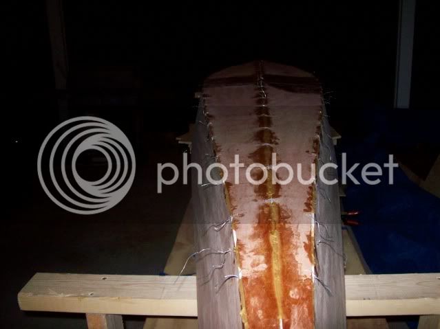

I worked on the bottom panels until I got a nice smooth curve. I mixed some filleting material and applied it to all seams. I just used a popsicle stick to apply it and came back over it with a the squeegee. A little fiddley but not too bad. The cool weather caused the fillets to take a few hours longer to set up. They seem to be OK though. The only downside I've seen to the slow hardener is the longer set up time. Haven't had any epoxy or fillet material kick off on me before I could finish using it.
Tonight I used the very last of the epoxy I had left over from glassing the bottom of the pirogue. Had a couple of packages from Larry at Raka when I got home. Just in time.
Tommorow I'll take out the stitches and fill in the spaces.
